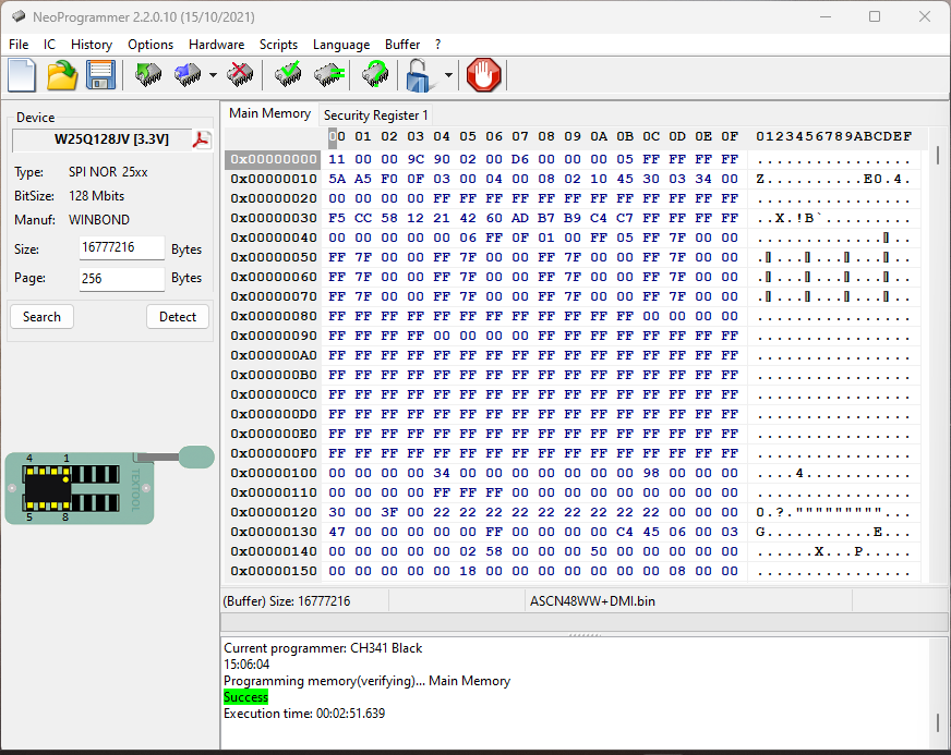

    Originally posted by the Benninger
    hi try post#16 and now not even the LED that indicates that it is charging works, some other suggestion I am open to listen and execute, thanks
    Bios extracted from Lenovo website update for S145-15IWL Laptop (ideapad) - Type 81S9,81V8.
    DMI 622000 - 623FFF​

      Indeed that's the license plate I have (81s9-81v8) unfortunately I went to edit in which I realized that in the backup there is no such thing as the serial or model number Winkey or others I tried to see the use of this data after receiving your file and I could not locate it Then I'm afraid my backup is really damaged, I also tried uploading this file directly and the computer still doesn't do anything finally a detail almost without matter, actually the address you gave me to find the DMI has a minimal error I found in 622000~623ff0 attached a photo where I saw something suspicious it says it is not aligned the backup you can see for yourself here Click image for larger version

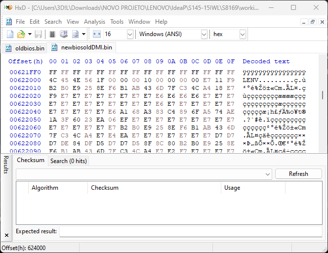

      The DMI information in this case is encrypted...you won't find it...use the HxD program, you can find it for free, insert both bios into it and transfer the DMI region 622000 - 623FFF from the original bios to the virgin bios (copy-paste)..
        There is definitely a problem, if I execute the command to look up the address 622000~623fff and a message error appears, it happens with any hex editor you can as you can see Click image for larger version

        As you can see after the address (623ff0) goes straight to 624000 there is nothing else in between these
          The DMI starts at 622000 ,you can see some more code there,and it is encrypted. The whole of the DMI area is 622000 - 623FFF ,look at a virgin bios you will only see the word LENV at 622000 and 623000.The E7`s are part of the DMI and encryption.
          I know how to decrypt the DMI but its pointless,just copy the DMI from your backup to the bios that peste posted 622000 - 623FFF , if you can`t do that i made a script that will help ->
          https://www.badcaps.net/forum/troubl...26#post1786056

            copy DMI data from oldbios to newbios re-record the bios unfortunately do not turn on this notebook , if you have any other ideas you can express them freely Click image for larger version

              Try it...if you write it without errors it will work..
