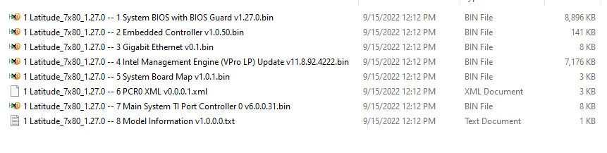

        #83
        Re: Dell Latitude 7480 Bios Password
        Hi everyone!
        Today I cleaned my bios ME (Dell 7480), flashed the bios chip, and later I saw that my bios is very old. If I update from the official Dell website (.exe) with a flash drive, will the previously performed ME cleaning remain? Skipping the ME region?
        I don't want to remove the chip again, if sure it's the official bios exe update, it only updates the bios region.
        If anyone knows, please write an answer. Thank you!

          #84
          The official probably updates everything, this is what it has inside. The fourth file is the ME region latest update.

            #85
            Thanks! I stay old bios with clean ME.

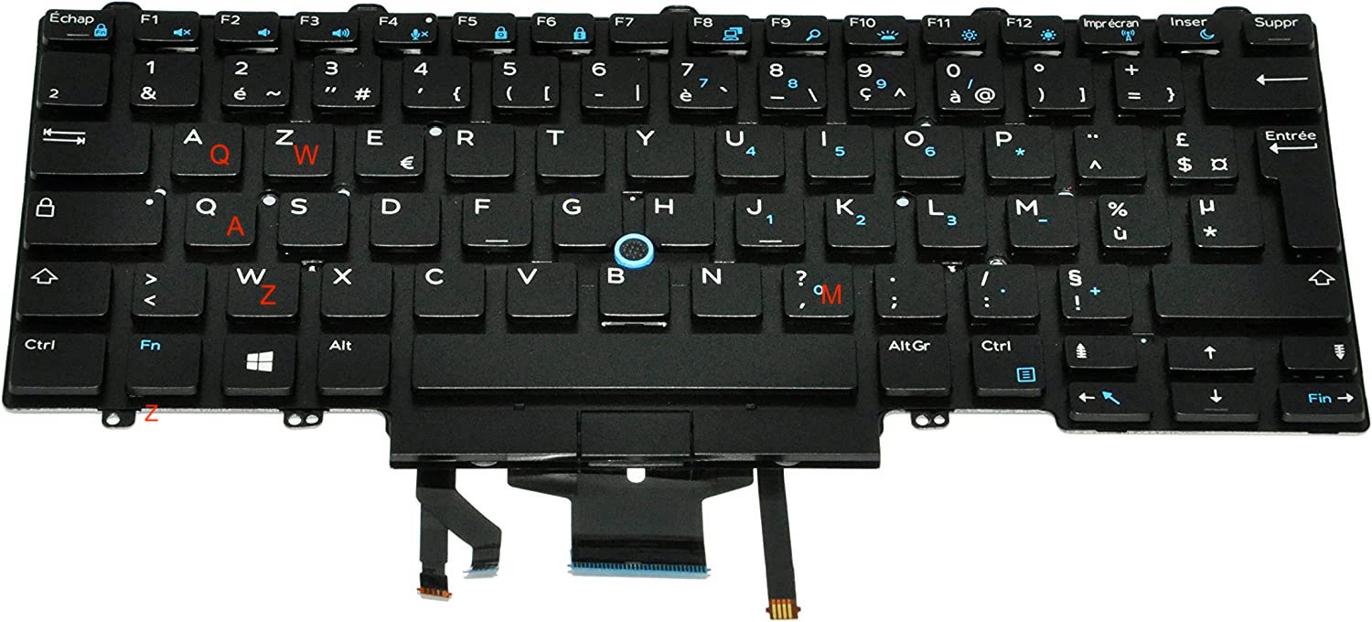

                            #93
                            Thank you but not work
                            It's Latitude Dell 7480 BIOS ver : 1.9.3

                              #94
                              You have to use Qwerty US layout keyboard ( can use external keyboard via 2.0 USB )

                                  #96
                                  It's AZERTY Keyboard on laptop;
                                  I don't have QWERTY US layout keyboard
                                  Thank you Markus1741 but not work
                                  EDIT : Try with AZERTY keyboard layout -> NOT WORK

                                      #98
                                      try
                                      ?Gr4A5F2L9jxR4jh
                                      or
                                      ?Gr'A(FéLçjxR'jh

                                          #100
                                          try
                                          ?Gr4A5F2L9jxR4jh
                                          or
                                          ?Gr'A(FéLçjxR'jh
                                          Not Work
