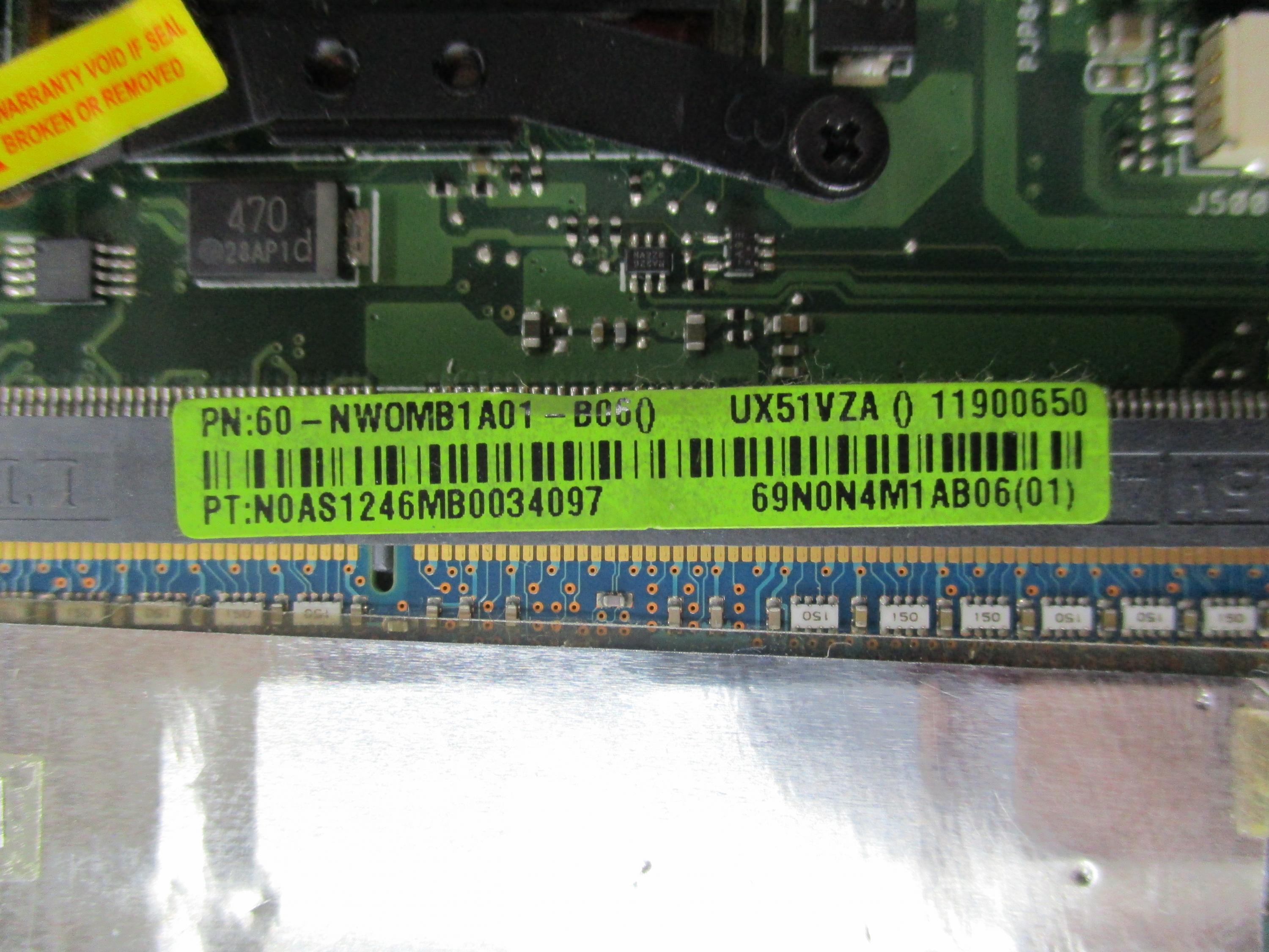

    I'm not 100% if its a corrupt BIOS, but this notebook is not coming on or showing any LED when connected to power. Sometimes it's coming on after BIOS reset, but also this does not work anymore.
    My old BIN is attached, could someone probably check or fix it? Thanks in advance!

    Post a picture of the white/green sticker on the motherboard,its the one with a barcode/QR code on it,and a model number. Its usually on or around the soldered ram/ram slot .

      Guess that's it

        It sure is . Try this one

          Thanks, sadly does not work.
          Also, I'm not 100% sure, it's a BIOS issue - just two times, it started to boot again, after shorting the cmos battery, now not anymore. Battery is charging (also charging LED changes color when full), voltages seem to be right, also 3.3 on the power button (which works as well) jus not powering on.
          Probably I will open a new thread in general troubleshooting for this issue.

            I can't believe, the problem is solved - it was the broken lid sensor! Replaced it with one from another, random mainboard. All working now.
