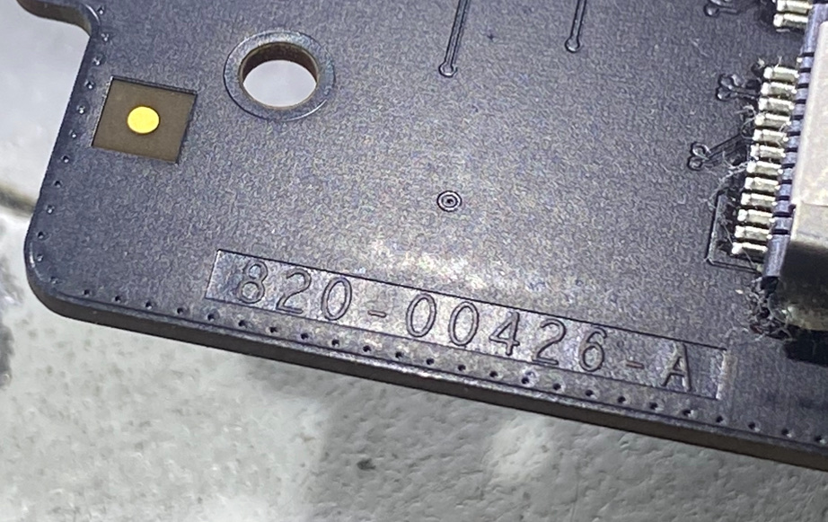

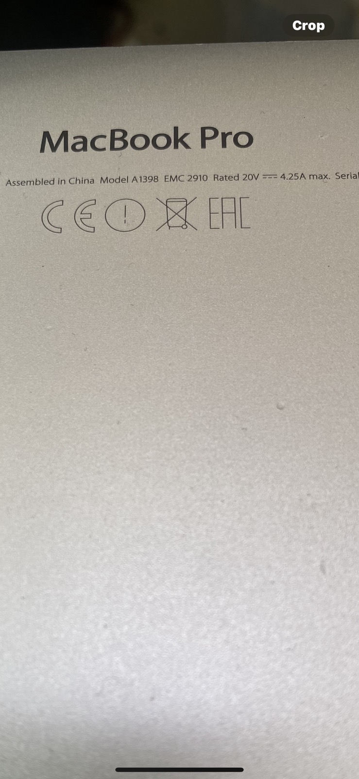

    Hello
    Got this board turning on but no image.
    Tried a different dump and it works.
    Now, I want to keep the same serial number on the new file, and I think some checksum needs to be done, and also clear ME region
    I was able to update the SN, but I dont have the knowledge to update the checksum and clear ME
    Can anyone help?
    Here are both files, the original bios that gives no image, and the new dump, with serial number updated.
    Thanks in advance
