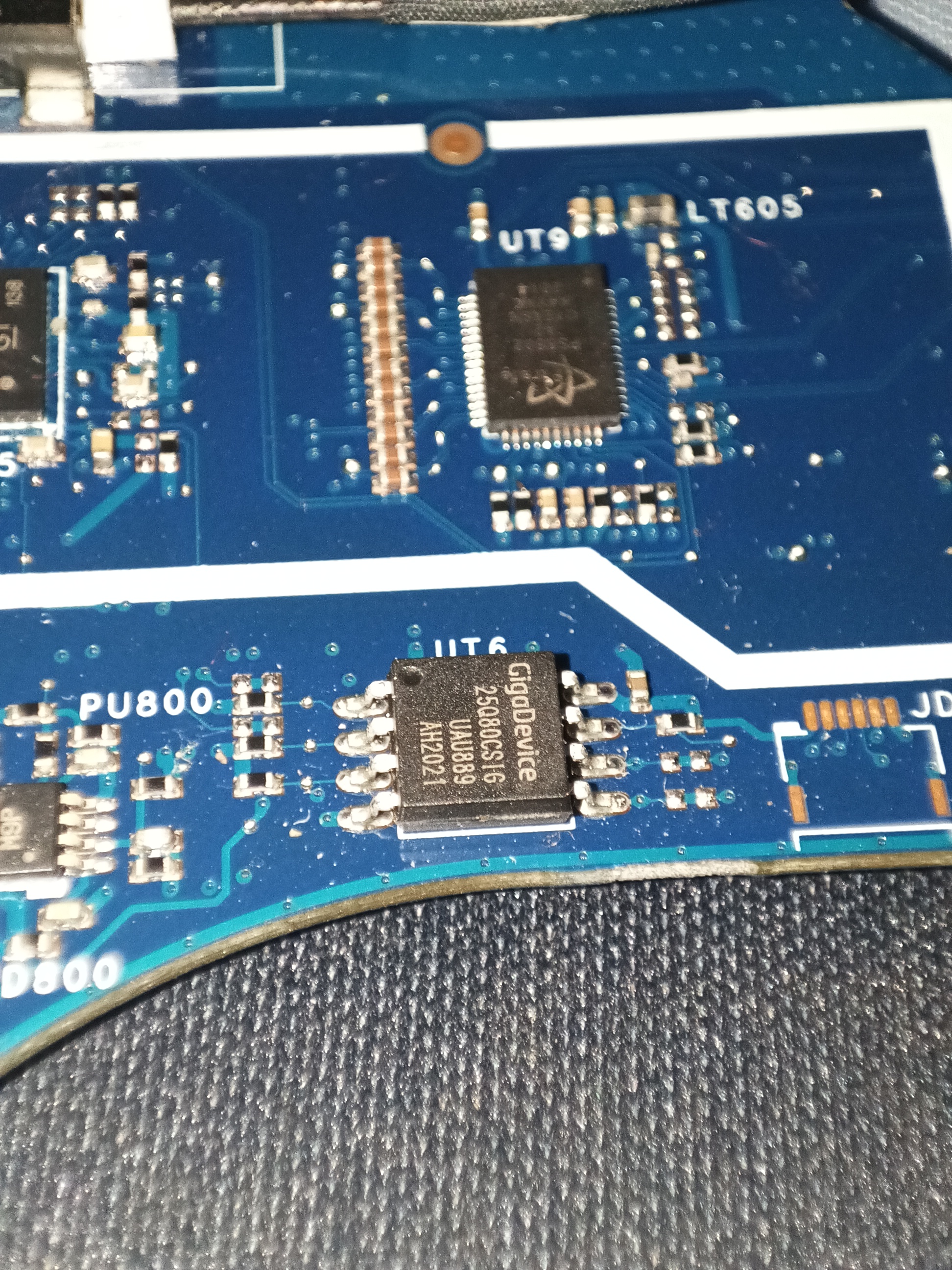

                                  • DCSoul
                                    • Jan 2023
                                    • 6
                                    • Philippines
                                    #277
                                    Re: Dell Latitude 5400 Bios password
                                    Need help which chip do I need to read for backup bios?
                                    • alfredposadas09
                                      • Aug 2020
                                      • 342
                                      • Philippines
                                      #278
                                      get it both

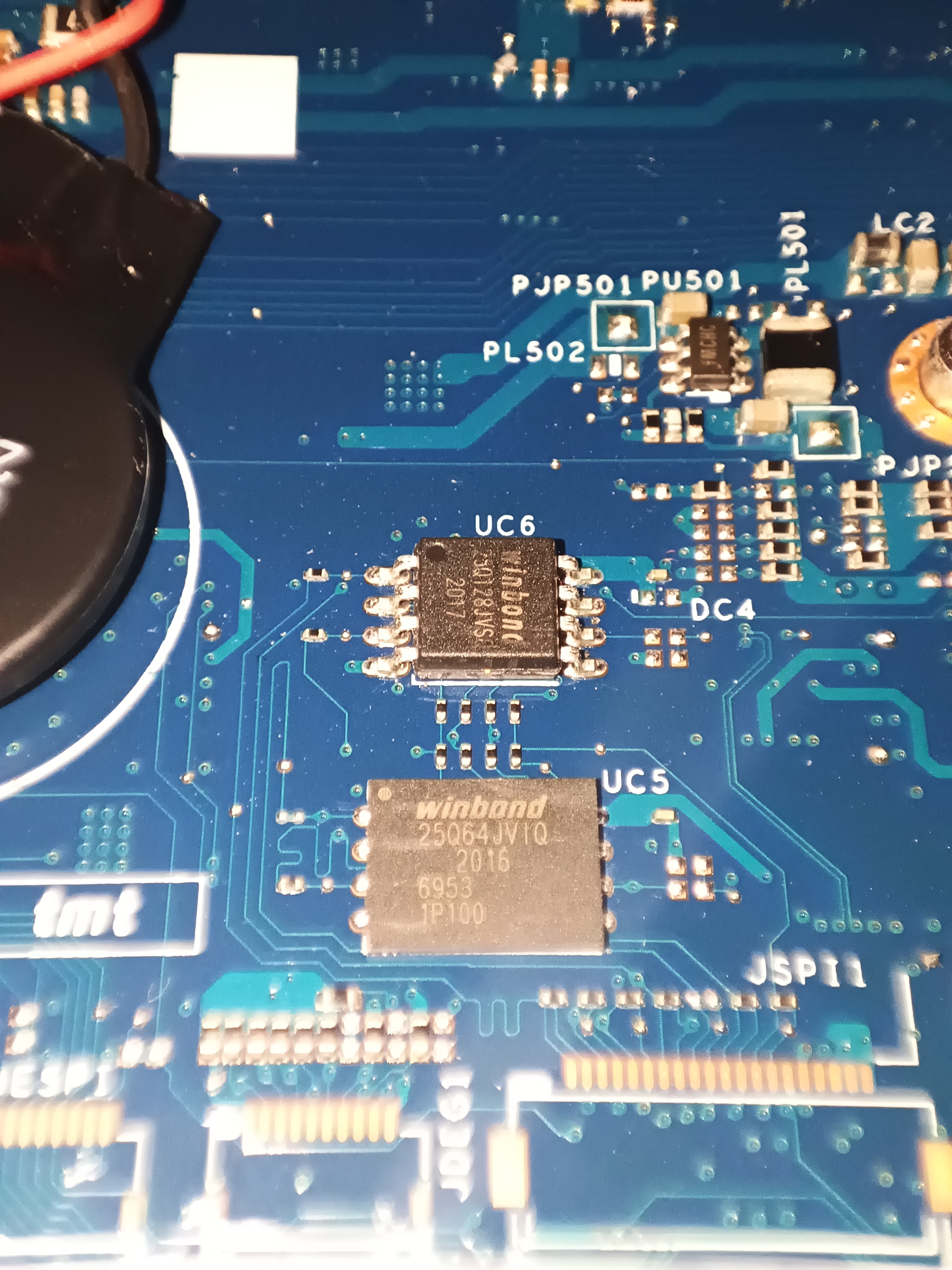

                                      • DCSoul
                                        • Jan 2023
                                        • 6
                                        • Philippines
                                        #279
                                        Originally posted by alfredposadas09
                                        get it both
                                        this are the two bin files
                                        can anyone clear the password?
                                        • alfredposadas09
                                          • Aug 2020
                                          • 342
                                          • Philippines
                                          #280
                                          find another bios chip these two files has no header
