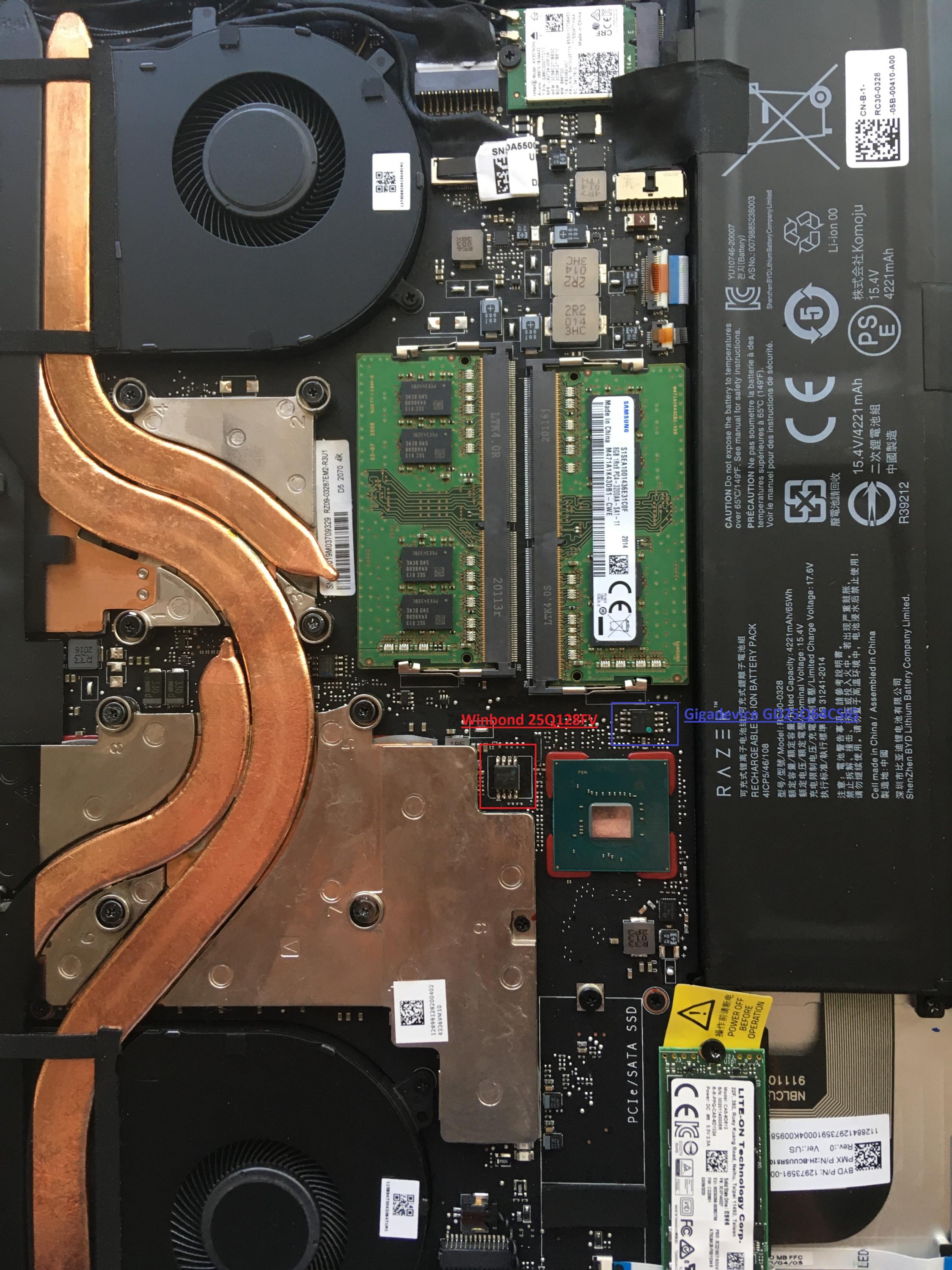

                      I've talked to a guy who mentioned that this model has two BIOS chips. I've made a screenshot (attached):
                      The main one is Winbond 25Q128FV (marked as red) and that contains that 16 MB bios which I could manage to flash.
                      But the problem would be with the second one (Gigadevice GD25Q64CSIG, marked as blue) which holds EC FW. So if I would have the image for this secondary device and flash it that would help I guess.
                      So my question is if anyone has similar model / motherboard would it be possible to extract it and send it to me? Or would you suggest in which other thread should I request it?
                      Thanks!

                        Re: Razer Blade 15” Base 2020 (RZ09-0328x) Bricked due to BIOS upgrade
                        Thanks!
                        Post the GD25Q64CSIG backup,even if corrupt, and also post the WRONG EC updater ,to check if contents are the same .
                            So I could manage the attached image from this secondary BIOS. What I can understand that it holds this EC FW which has version 1.0. Could this cause the whole issue with my machine?
                              It does have EC firmware,the problem is the filesize is 16MB ,the GD25Q64CSIG is an 8MB chip, so i can only guess that youve chosen the wrong chip in your programmer software and its read the chip twice to make a 16MB file.I split it into two 8MB and the files are identical.The EC has your DMI info in it,serial and win key. Which EC did you flash,what was the bios updater you used,from which model ? , have you still got the file you flashed that bricked it ?
                              There`s no EC update available at the razer support for the RZ09-0328x ,i guess they never released one. So,you`d need an EC dump from the same model. Get in touch again with razer and ask them if they can provide one

                                #35
                                Could you please send me divided (8MB file)?

                                  #36
                                  I already asked Razer "support" million times but they keep saying they don't send individual parts and I should send it back to them for repair (which means a full mobo replace most probably...
                                  8MB EC attached. You will still need an EC dump though, if it has been flashed with the wrong one.If someone posts one then its a quick job to copy your DMI from the old one to the new one.
