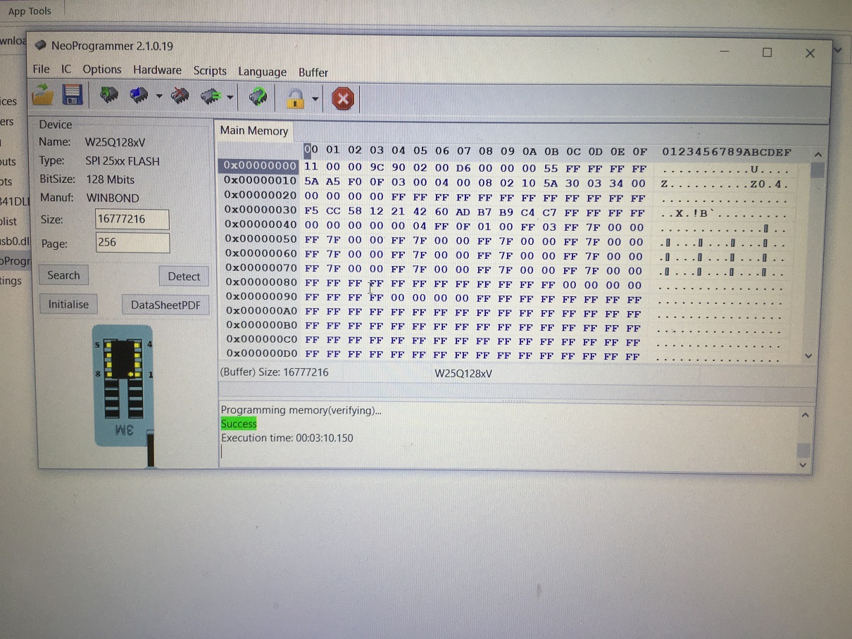

    Hello Guys,
    I have a Razer Blade 15” Base 2020 (RZ09-0328x) and performed a BIOS update last week (used the factory 1.06). During installation Windows 10 BSODd and my computer didn't start anymore. I could manage to manually flash the BIOS with a CH341A Programmer (only to version 1.03 as 1.06 is still killing my machine) but after that my touchpad is not working anymore. When I check BIOS I could see proper main version but for EC FW and MCU FW versions I see version 1.0.x. (which seems to be incorrect for me). I extracted the BIOS image from official updater (it contained 2 BINs, Dana5_0106.bin and Dana5_0106_FWUpdate.bin.
    After few more attmepts my laptop totally died (no charging, no LEDs, etc.). I guess it has something to do with EC chip.
    So my request would be if anyone has the same model would you please provide me extracted BIOS and EC FW?
    Thanks much in advance!

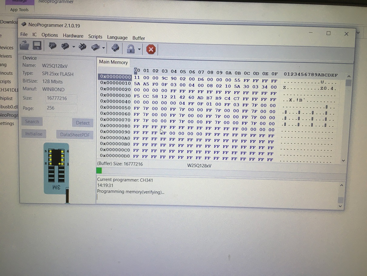

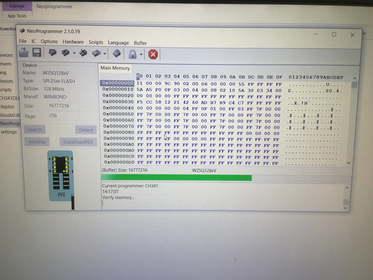

                      Re: Razer Blade 15” Base 2020 (RZ09-0328x) Bricked due to BIOS upgrade
                      Program the Dana5_0106.bin again, use NeoProgrammer software. The ch341a (using ch341a software) can fool you sometimes saying its flashed and verified when it hasnt done anything. The bios has configured ME firmware so its AOK.
                      https://www.badcaps.net/forum/showpo...04&postcount=7 NeoProgrammer
                        I've done that again (exactly same steps what you wrote) but my machine is still not turning on. Adding some screenshots of the process.

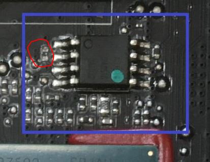

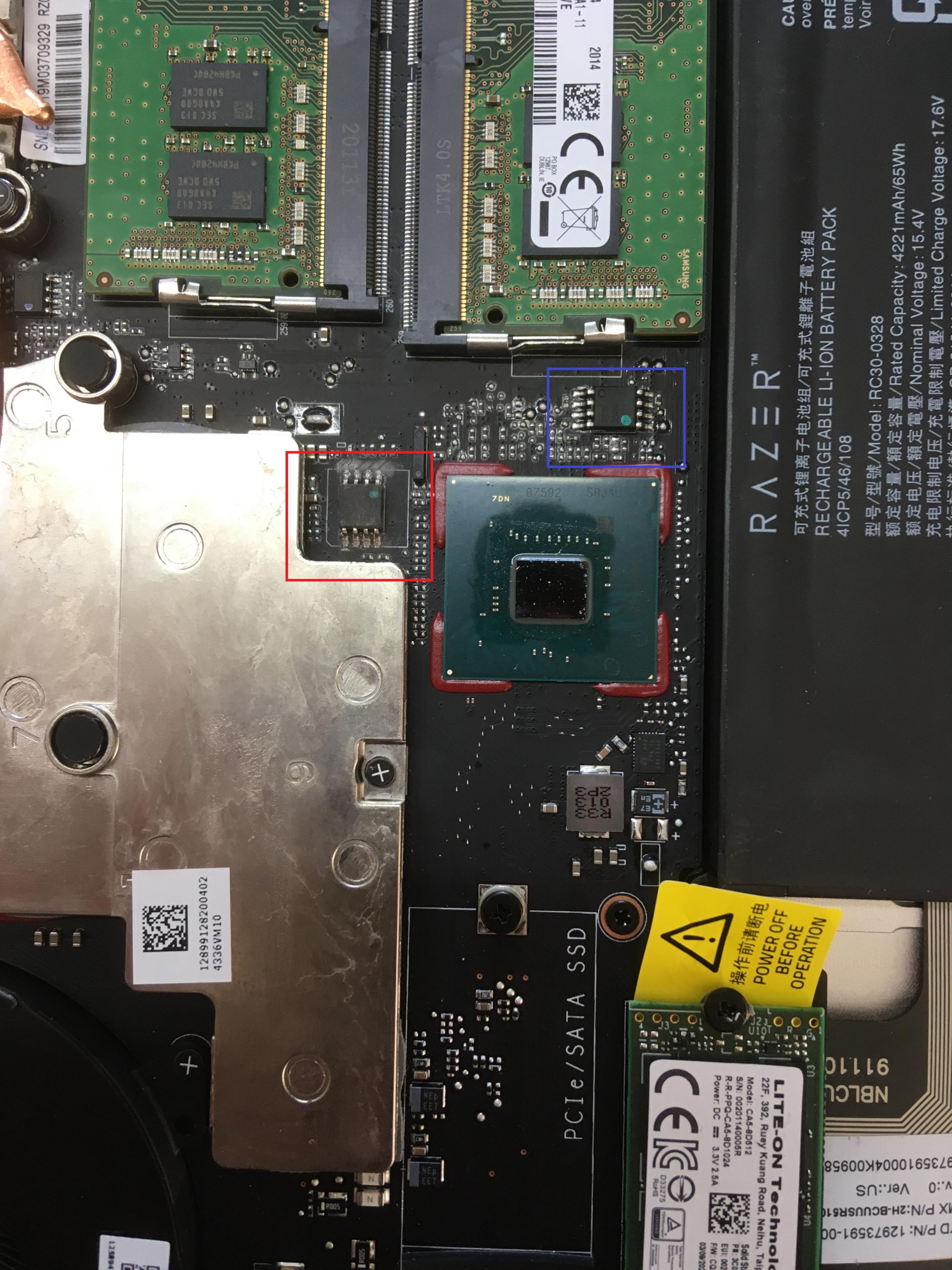

                          I'm not sure which chip should be the EC one. Made a screenshot and marked BIOS chip with RED. Probably EC is the one marked with BLUE?
                          It's so tough to read what's been written on the chips. Any more details what I'm looking for?

                                • 20361
                                Have you put the clip on that one marked blue,it looks like a resistor or cap may be missing,i can`t really tell. If you have a microscope or magnifier take a close up image, and read the part number from the chip as well.
                                  Probably few missed letters but BLUE chip should be GD25Q64CSIGTR.
                                    • 20361
                                    Not sure what could be on that, maybe the thunderbolt firmware
                                      Chip marked with RED ... sure that it is the right position ??? I can see that have been removed ... maku sure the legs are soldered good ...
                                        I haven't removed it during flash. I used a clip. And I could manage to re-flash it today successfully.
                                        I remember when the issue was only with main bios I could see LEDs working. But not anymore. I guess that would be due to EC? I found another chipset (also from WINBOUND) close to the area where keyboard connects to motherboard. Programmer also identified it but could not retrieve image as - I guess - it's broken. So would be nice to find someone who has the same model and could provide EC FW.
