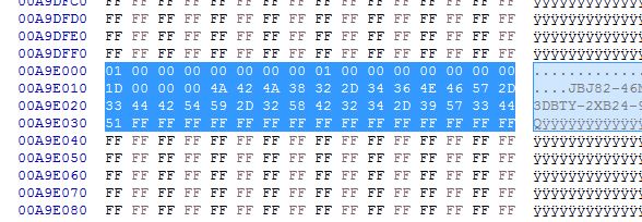

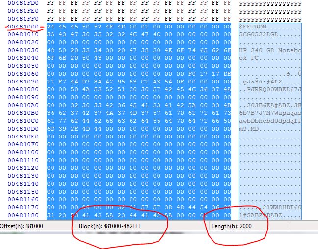

            Copy the dmi and win key from the old bios using a hex editor
            D 481000 - 482FFF (Length 2000)
            W A9E000 - A9E03F (Length 40)
