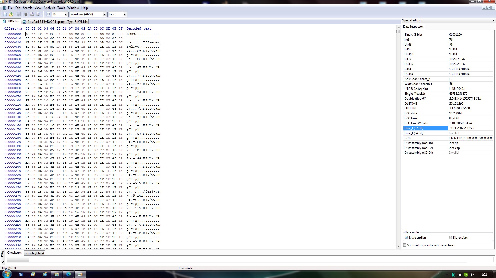

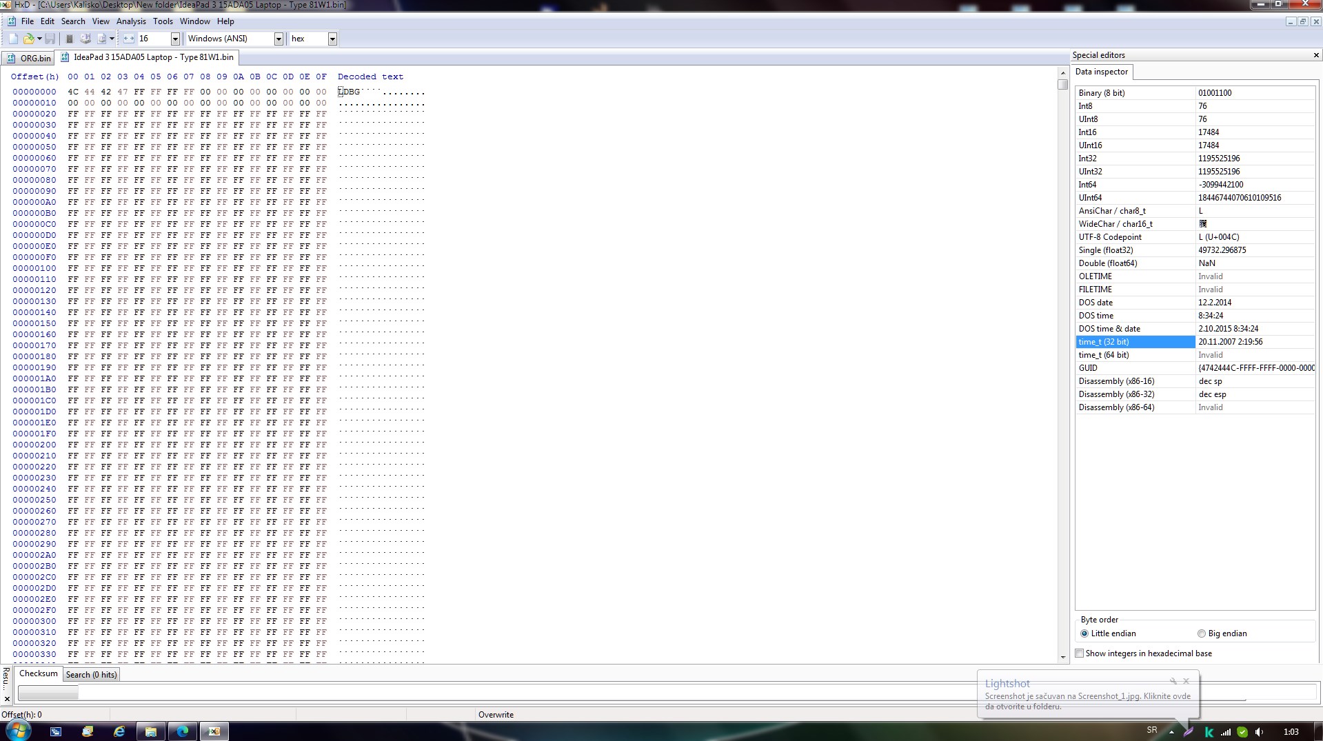

    Originally posted by SMDFlea
    If you have made a good bios backup already,then you have everything you need at posts 29 and 75
    I opened 8MB_DMI 1000 - 2FFF_CopyDMI.mps as instructed and tiny hexer opens with the two BIOS open, what should I do?
    EDIT:
    If I understand correctly, a file called "newbios.bin" is created and the old one becomes "newbios.bin.bak". I uploaded the created dump but still have the same problem
