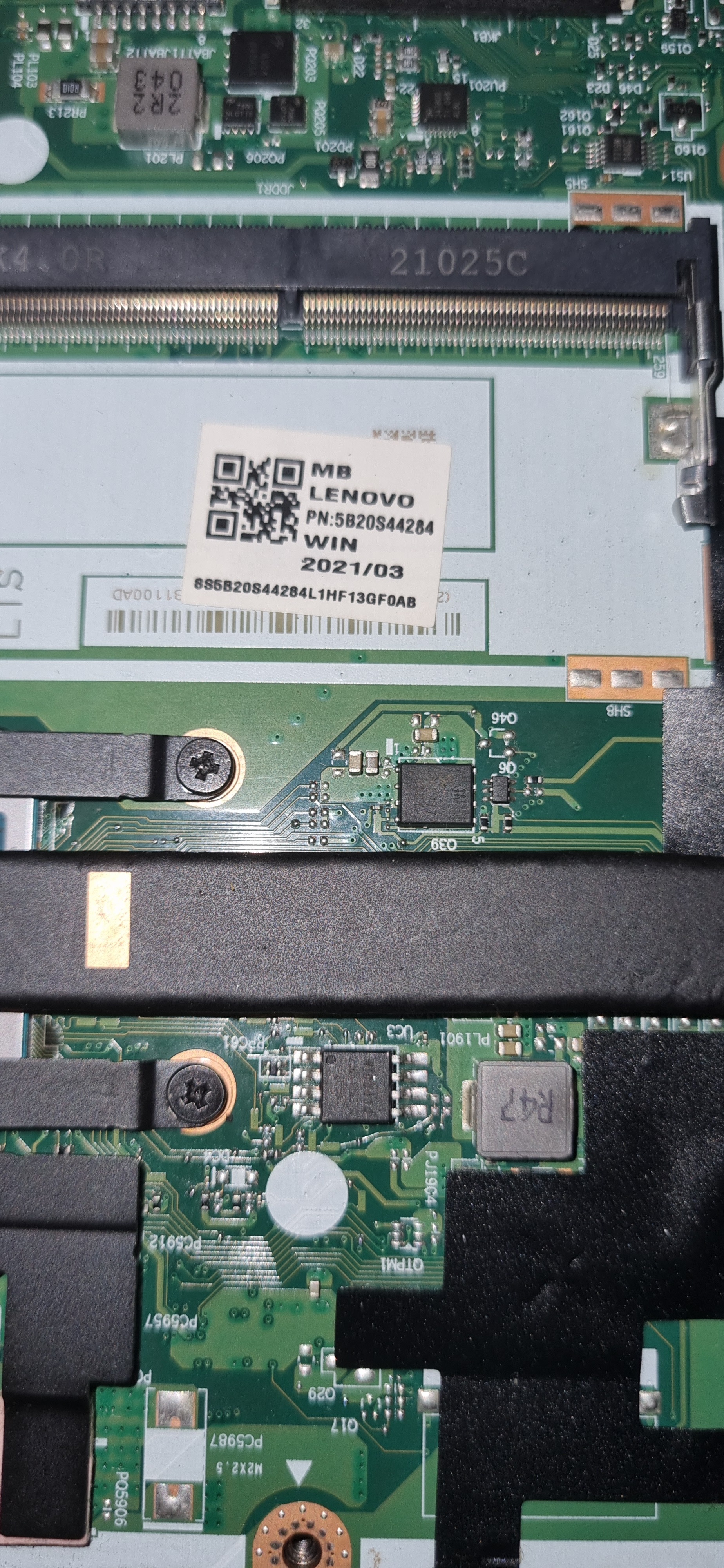

        Hi! Thanks for your help!!
        Here is the files... I did not take chip out from board. I used a clip with 1.8v adapter. Looking in the datasheet it says 1.8v that is the W version of 25Q64JW
        Made 2 copys.
        Tell me if anything was wrong or right and how can i continue.
        Again, thanks for all your support!!

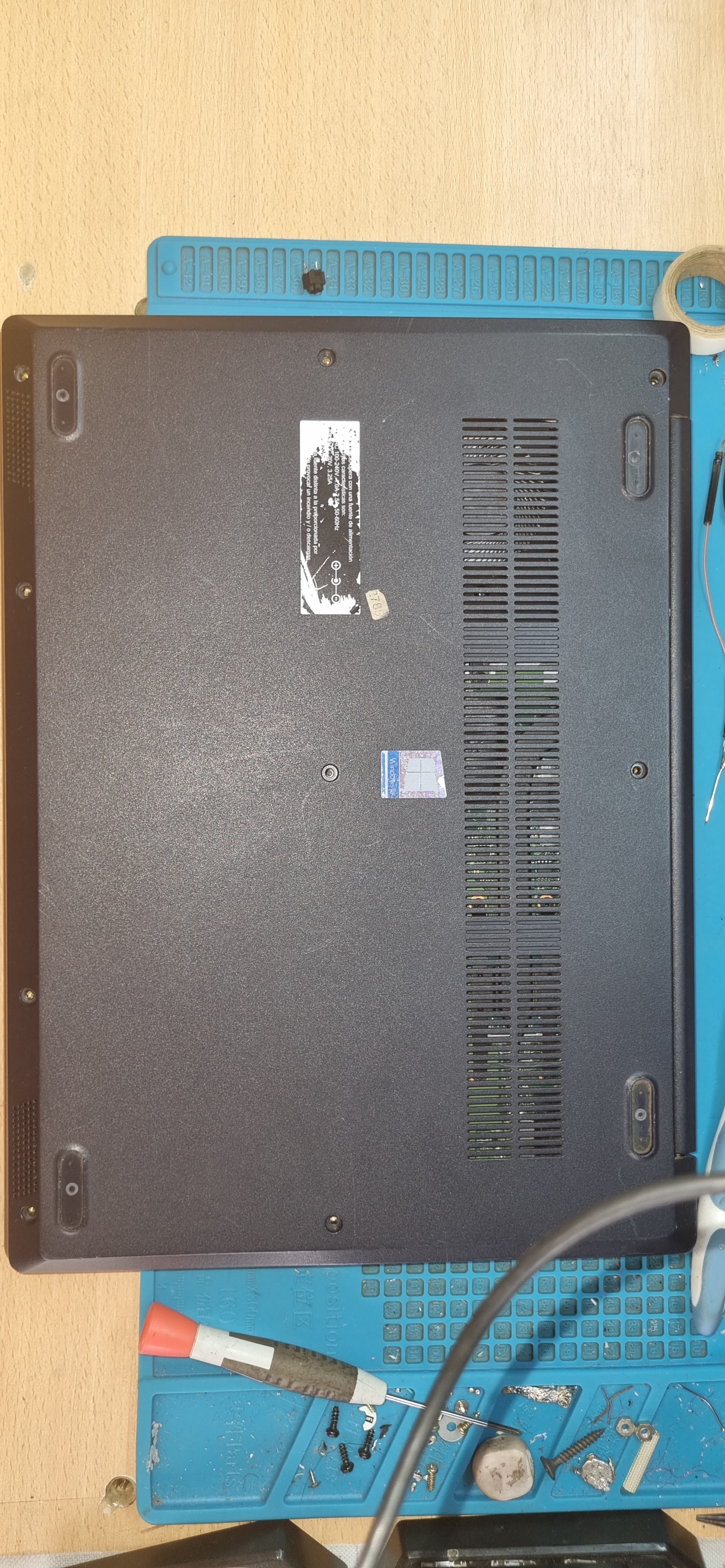

            I don`t know... there is no sticker anywhere... just a PartNumber inside moba: PN:5B20S44284...
            That's all!
            Thanks anyway! <3

              Look for a label on the laptop case.

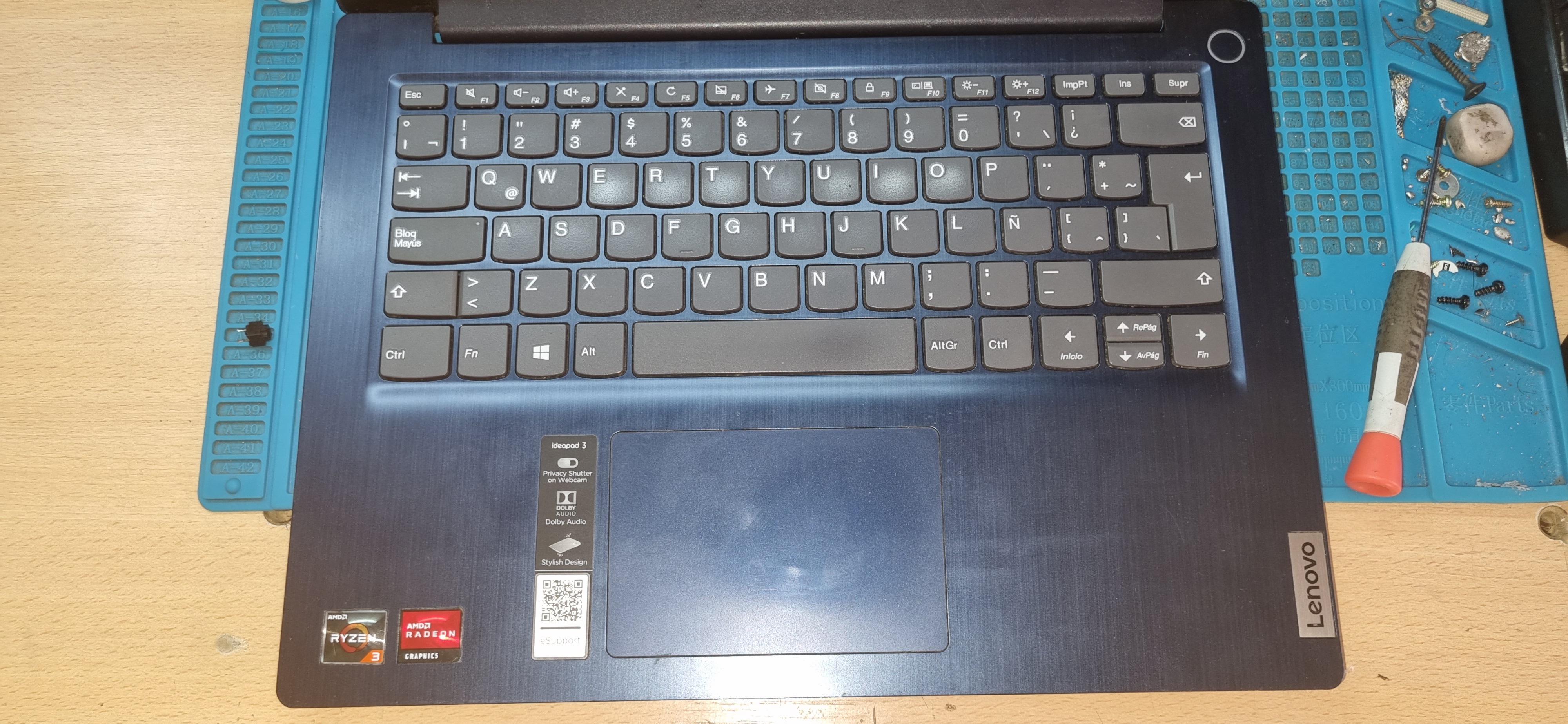

                          Woow QR works and tell me wich computer ir... because there is no label just the ones in attached photo.
                          This computer is a IdeaPad 3 14ADA05 81W0 PN: PF2PRW41 MTM: 81W000MUAR
                          With AMD Ryzen 3 3250U and DDR4 4GB
                          Just for understand, why is important this numbers?? I really like to understand that... thanks for any kind of support!!

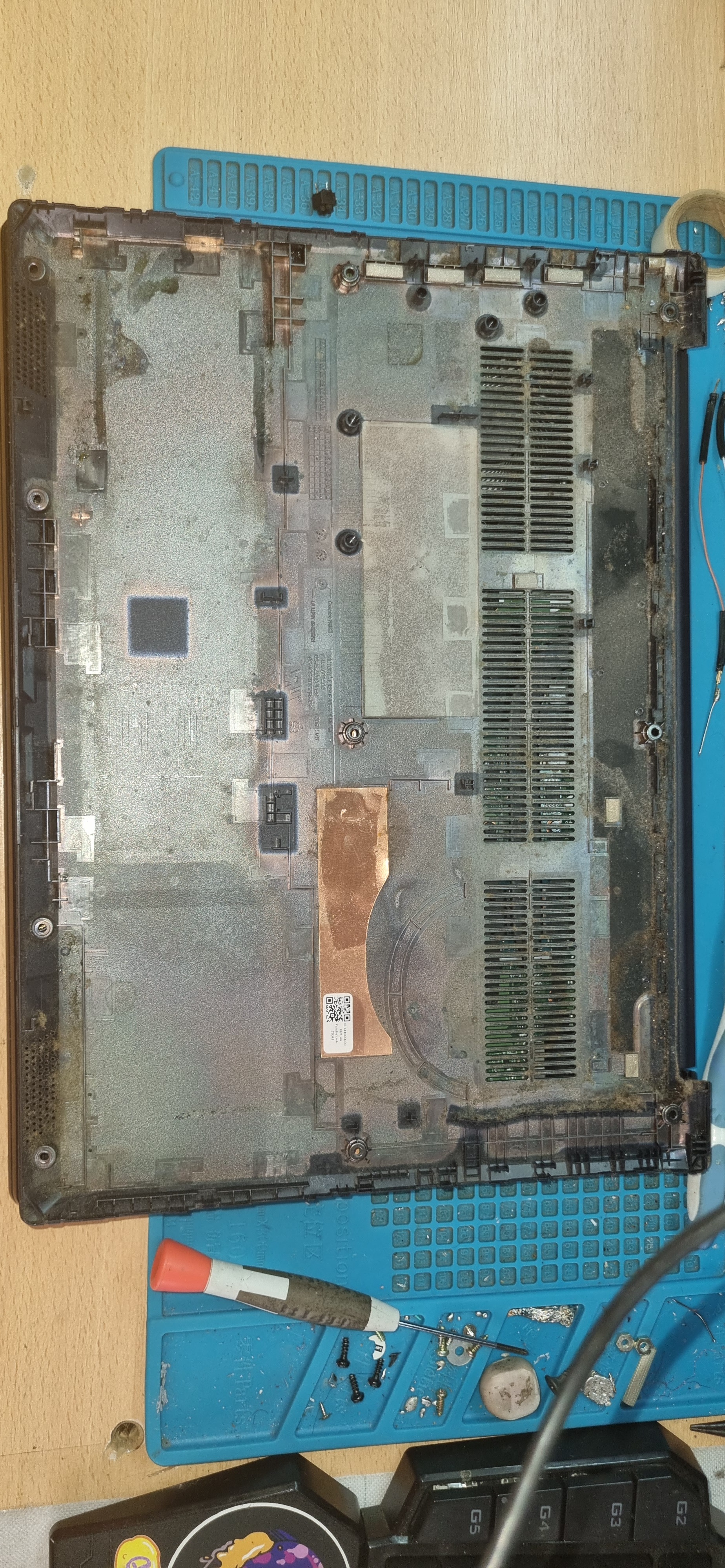

                          PD: my client was so awful taking care this computer... like you see in inside back plate.

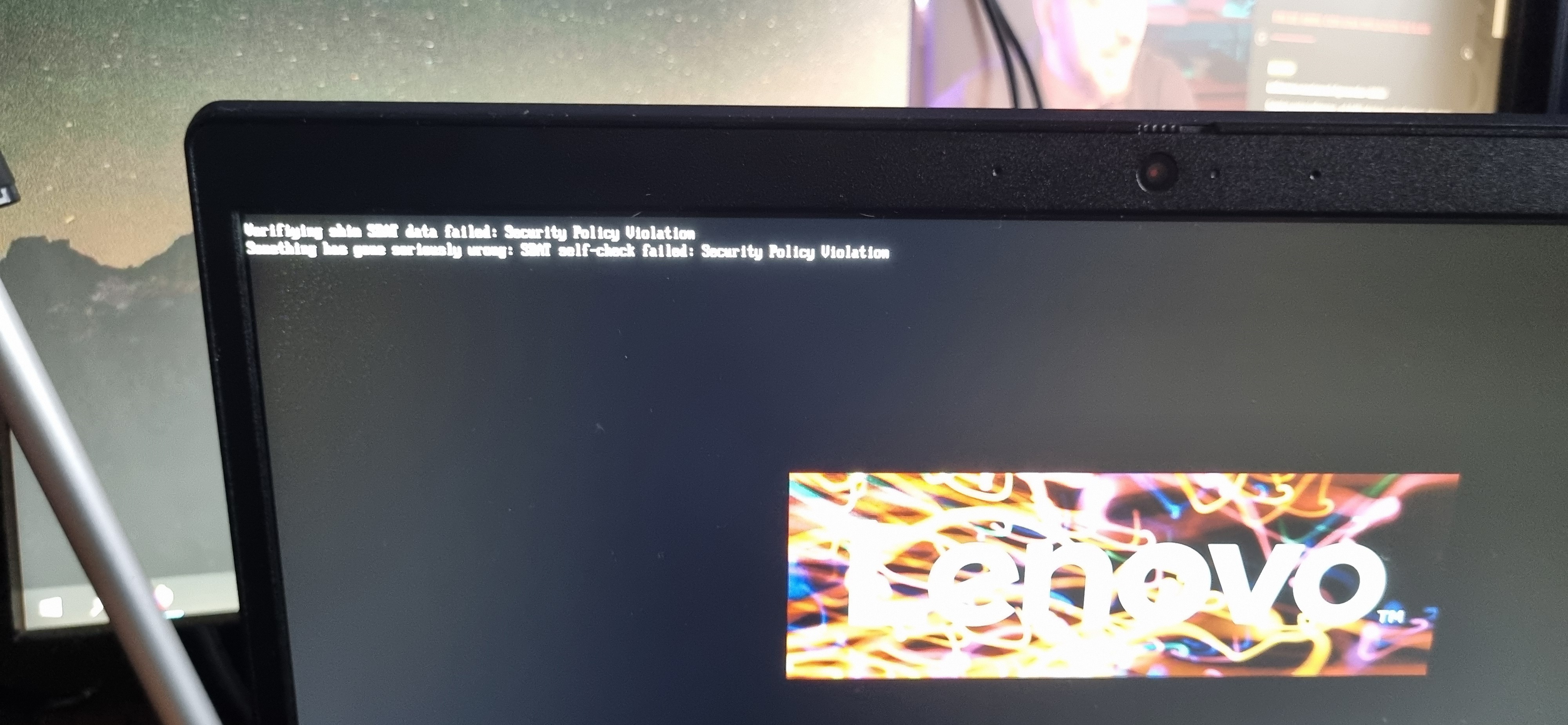

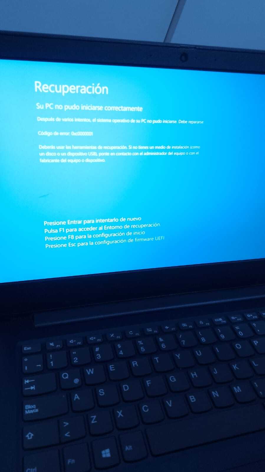

                            Just for refresh my problem...
                            The computer starts with Blue Screen Error... Client sends me a pic showing the Recovery instance with error code 0xc0000001
                            When I get it, i looked inside and saw that i was full of dirt. So i cleaned it.
                            Then I try turning on, and it allway get stuck "Loading Windows" in LENOVO Logo stage.
                            So i wanted to see BIOS, and pressing F2 or FN+F2, nothing happends, just LENOVO Logo without any loading, gettin stucked.
                            Looking for internet it says that this notebook comes with NOVO Button... i pushed it, Menú appear, but i have the same problem... BIOS is not working, just the LENOVO Logo. When I try another option, is the same... just goes to LENOVO Logo and get stucked there.
                            When I take off SSD m.2 the computer says:
                            "Verifiying shim SBAT data failed: Security Policy Violation
                            Somthing has gone seriusly wrong: SBAT self-check failed: Security Policy Violation"
                            So I realise that there is SecureBoot ON.
                            So... i could never go to BIOS... thats why i think there is a problem and wanted to test with another BIOS.... I don't know if there is any keyboard combination to Activate something which let me in BIOS.
                            I don't think that another thing is wrong... even i can't take out RAM couse they are SMD and soldered.
                            Thanks anyone for your help!! I hope this case could help others!
