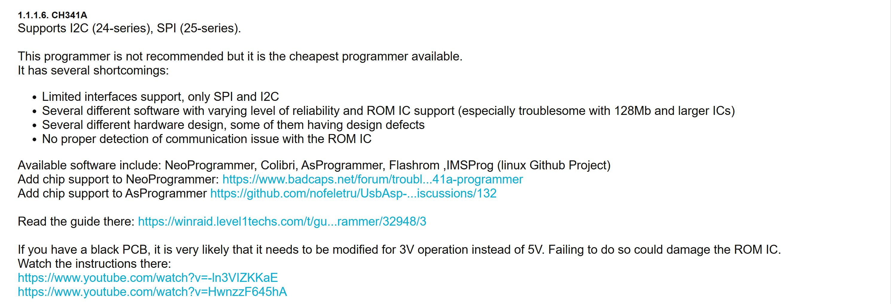

    Originally posted by yorossi
    I am using a cheap CH341A programmer, and I do not have any backup. Do I have any chance to bring the laptop back to life again?
    CH341A has at least 3 software support.
    https://www.badcaps.net/forum/troubl...21#post1622421
Name:	2025-05-16 16_16_12-BIOS guides, methods, resources and tools - Badcaps.png

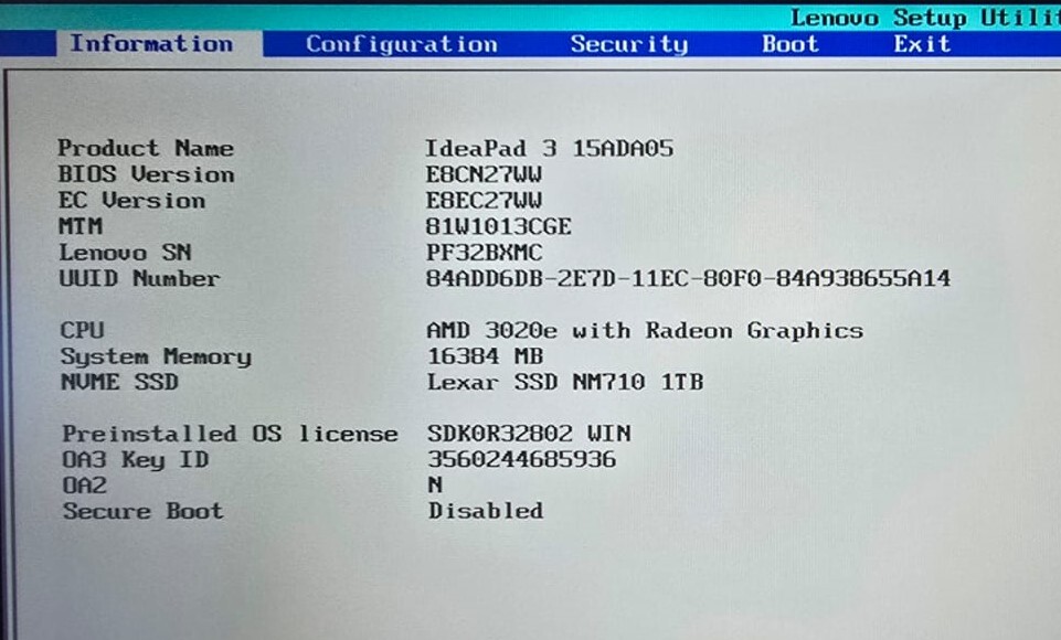

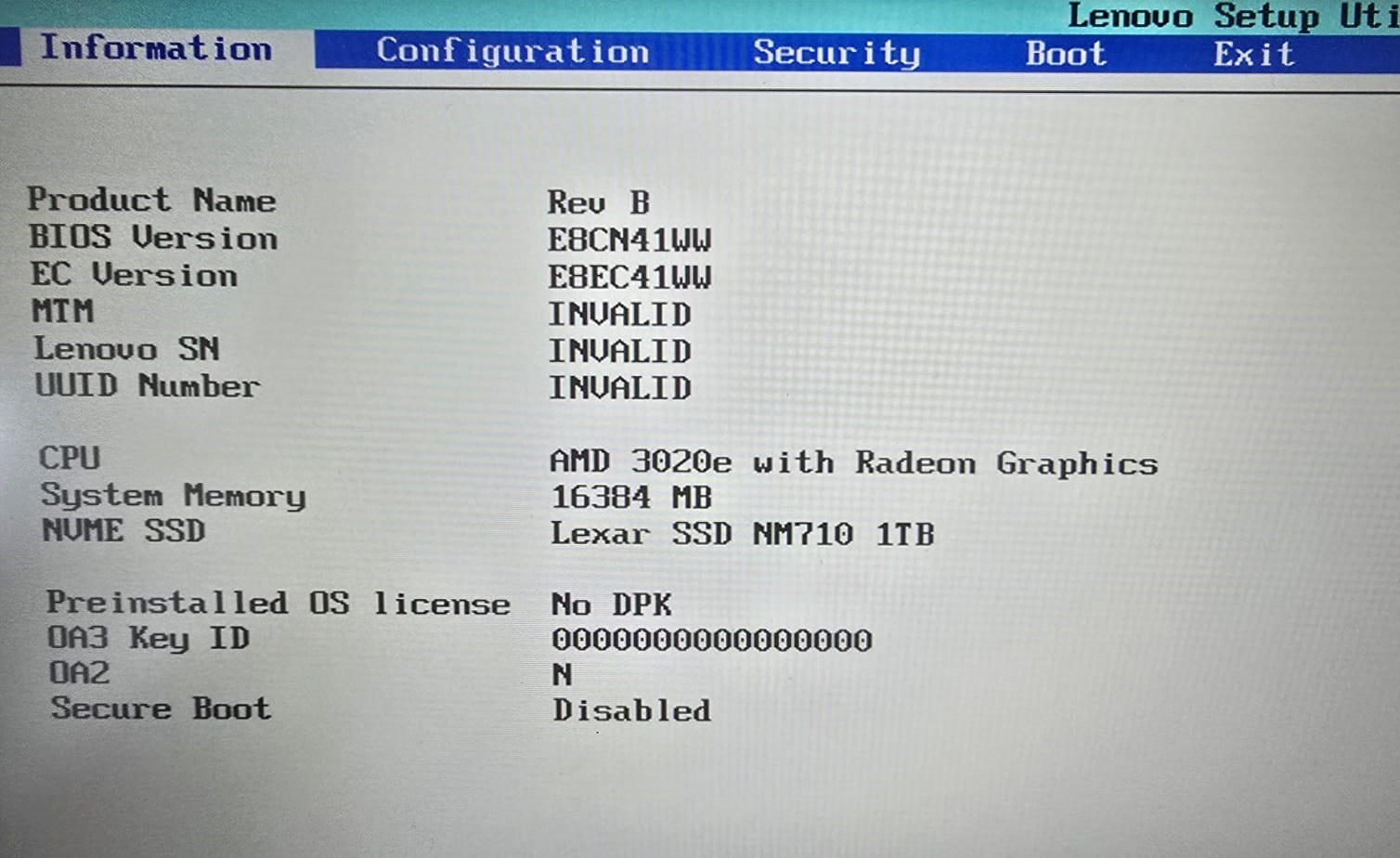

                      • Harald Rohrer
                        • May 2025
                        • 2
                        #252
                        I had the problem 2 days ago when updating the bios that it froze. Even after a good 5 hours the status has not progressed a bit. After forced shutdown and restart everything stayed black and nothing reacted. Thanks to this forum, I read out the bios with the CH341A and saved the non-functioning ones first. I then uploaded the file from the forum to the bios chip. PC and Windows starts but Win11 complains about the missing key. In the bios the information about serial number, key and so on is missing. I also have a photo of the information page of the bios before I tried the update.
                        Now the bios version E8CN41WW is installed and working
                        Can someone help me to get the information into the bios file, it would also be great if the Preinstalled OS license would be possible.
                        Product name: IdeaPad 3 15ADA05
                        MTM: 81W1013CGE
                        Lenovo SN: PF32BXMC
                        UUID Nimmer_ 84ADD6DB-2E7D-11EC-80F0-84A938655A14
                        Preinstall OS license: SDK0R32802 WIN
                        0A3 Key ID: 3560244685936
                        0A2: N
                        Many thanks in advance
                        • hoaca388
                          Badcaps
                          • Jan 2022
                          • 12315
                          #253
                          DMI added.

                              • Harald Rohrer
                                • May 2025
                                • 2
                                #257
                                Originally posted by hoaca388
                                DMI added.
                                Thank you very much, it worked perfectly. The device has thus been saved from being disposed of and recycled.
                                On a side note, I had hoped that the update would offer the option of setting the amount of RAM allocated to the graphics in the bios (as with most desktop PCs). With the new 16GB RAM, a whopping 2048MB is allocated to the on-cpu graphics, with the original 4GB RAM it was (is) only 512MB.
