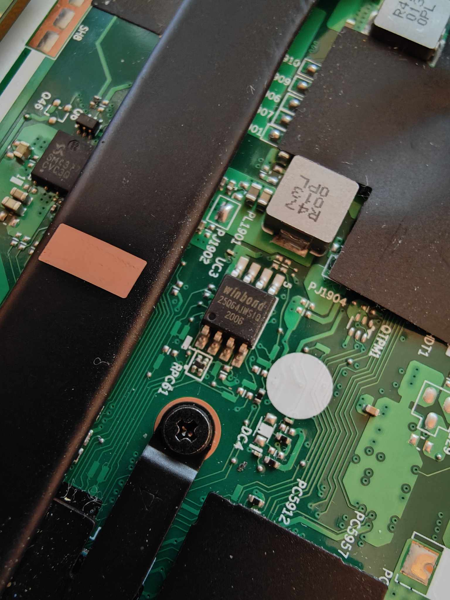

    Originally posted by RiderXO
    Weird, i tried a second time, with the same file and now i got error at address 4ABh
    RiderXO Yesterday when I flashed my Lenovo Flex 5 14ACL05 with a Winbond W74M12JW bios chip with a EZP2019 I had to do the following:
    - use a 1.8 V adapter
    - manually choose the most identical chip id as the EZP2019 wrongfully detected the bios chip as 93_EEPROM, ATMEL, AT93C46@16.
    I went with SPI_FLASH, Winbond, W25Q128JV, (1.8v)​
    - double verification of reading bios with 3 Mhz setting as higher fx 12 Mhz did not produce the same data each time.
    - Erase bios before writing then verifying bios data (Lesson Identified: if you only write - verify it's gonna produce an error).
    ie. did you erase before writing ?
      The bios chip must be unsoldered from the board before writing or reading..
      do not use the clip, you may have errors..if you do not have anything to unsolder it with,
      solder wires between the programmer and the bios chip..
      here is a video for example..https://www.youtube.com/watch?v=DWWi...l=ThisIsHow​
        Yes i did erase the chip every time. EZ detects mine as W25Q64FW(1.8V). by default. And yes, i am using an adapter for 1.8v. If i search in EZ programmer database there is no 25Q64JWSIQ
        here is a video for example..https://www.youtube.com/watch?v=DWWi...nnel=ThisIsHow
        Hmm, yeah i am using the clip. Would a normal heat gun work?

              #226
              i'm out of ideas...I unsoldered the chip from the MB, i put in the 1.8v adapter, the programmer read it as 3_EEPROM, ATMEL, AT93C46@16. I selected SPI-FLASH, Winbond W25Q64FW (1.8v) as this is the only chip with 8MB and 1.8 v , did a read test but it gave error chip not empty but i performed anyway erase-write-verify but at verify it still says error on some address...The only thing different then with the clip it was it took a whole lot longer to erase and write.
              Noob question, is it possible i am not aligning correctly the chip with pin 1 (the round small circle on the chip indicates which one is pin 1) on the programmer and still read it but in a wrong way? Or if i do not place the chip correctly on the programmer it won;t detect it at all?
              • RiderXO
                • Apr 2025
                • 6
                • Romania
                #227
                Haha. i did it. the chip reader was in the wrong place on the adaptor. I looked again to some tutorials and i aligned it ok then as soon as i pressed on the detect button it recognize it as W25Q64FW. Did erase-write-verify, with no error on verify. Soldered it back and the laptop was alive once again
