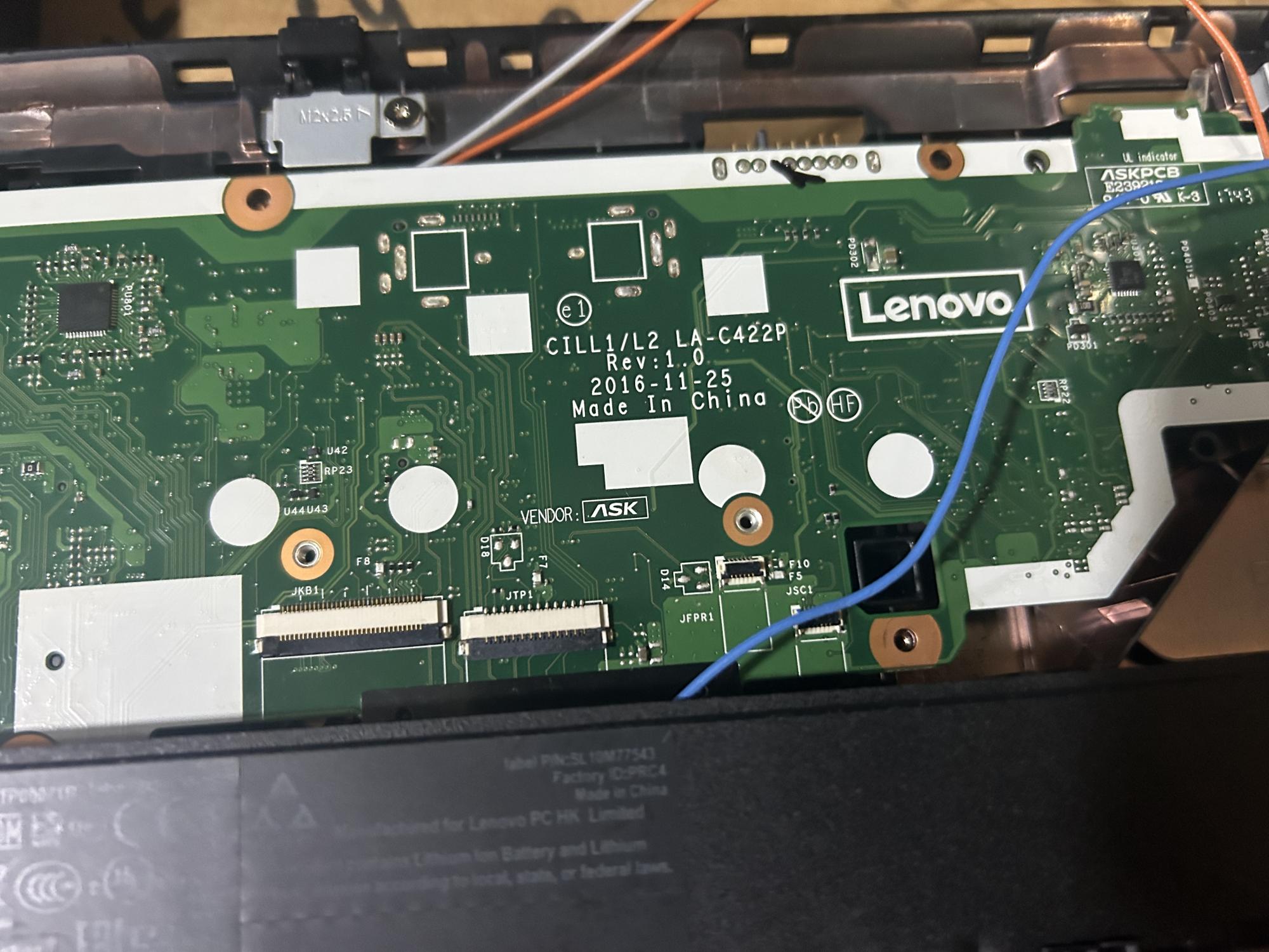

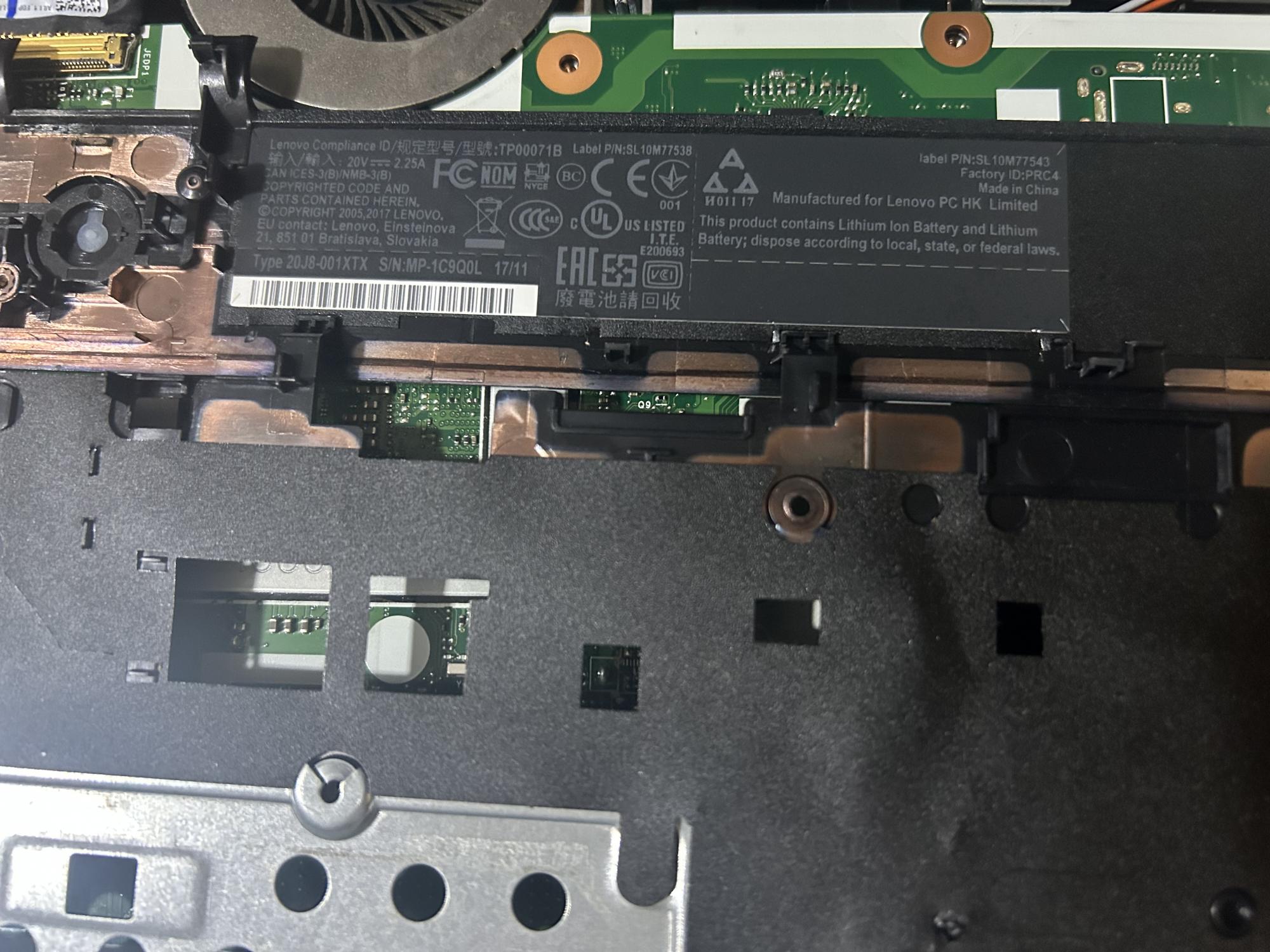

                              Hi Guys
                              Looking to get this bios file password removed or details on what i need to edit in the bin file.
                              Model Lenovo L570 TP00071B
                              SN:MP-1dx0X0
                              Board:PSL10P97998
                              Thanks again
                              Paul
