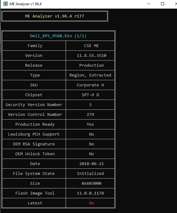

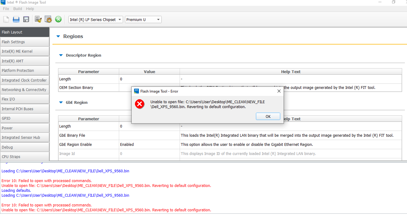

          I know how to clean the ME region SMDFlea showed it very nicely in this link.
          https://www.badcaps.net/forum/showthread.php?t=88533
          I tried to clean this BIOS with Fit Version 11.0.0.1191 11.0.0.1202 11.6.10.1196 11.8.86.3877 but every time an error message appears.
          I can't find any version with 11.0.01178, no idea if it even exists.
          If anyone has the version that would be great.
          Many thanks ....

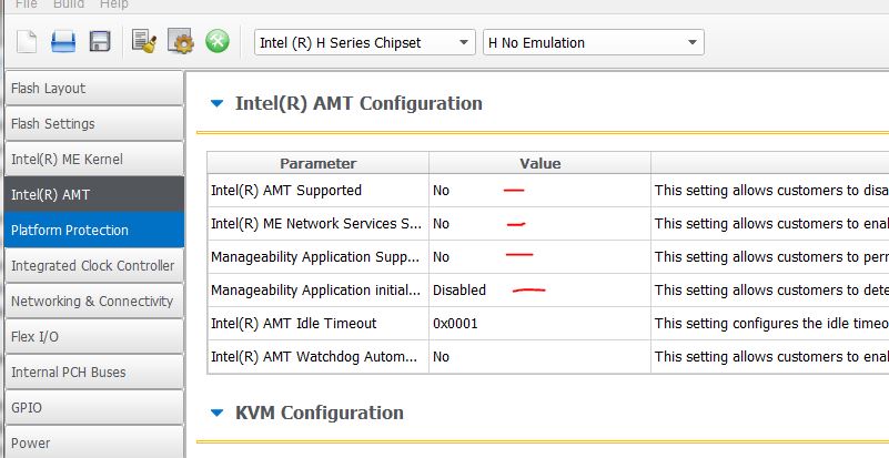

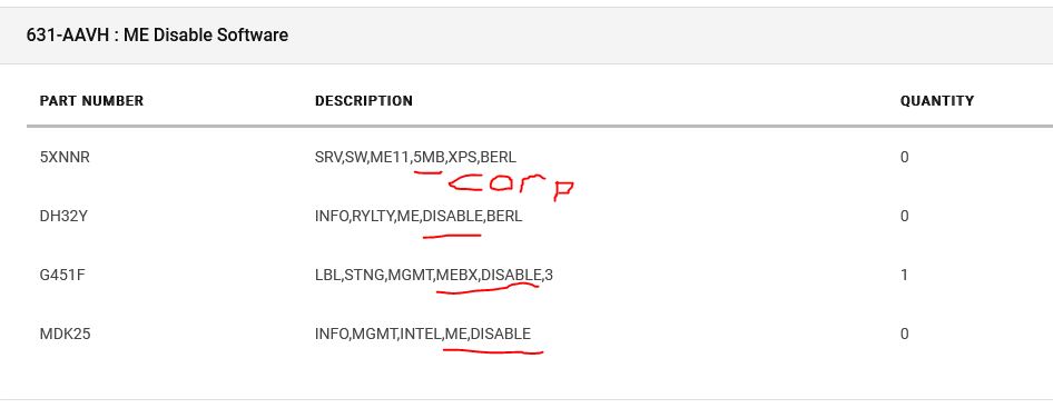

            There`s something wrong with the ME region.Besides,the service tag in your bios is 7GDXF72 its from an XPS 9550 not 9560. According to the product specs at Dell support it shipped with ME disabled (It isn`t really disabled,only the AMT part of it is). This bios has the exact same spec -> https://www.badcaps.net/forum/showpo...4&postcount=10 .If you want to experiment you can extract the ME region from that bios and copy it to yours using a hex editor or an old version of UEFITool, after that FIT works ok, but no need to clean it again anyway,but you could have copied an initialised ME region and then cleaned it.If you want to keep your original service tag/key etc you can copy the DVAR area from your backup to the new bios using a hex editor.There is no service tag/key in the ME_Clean bios

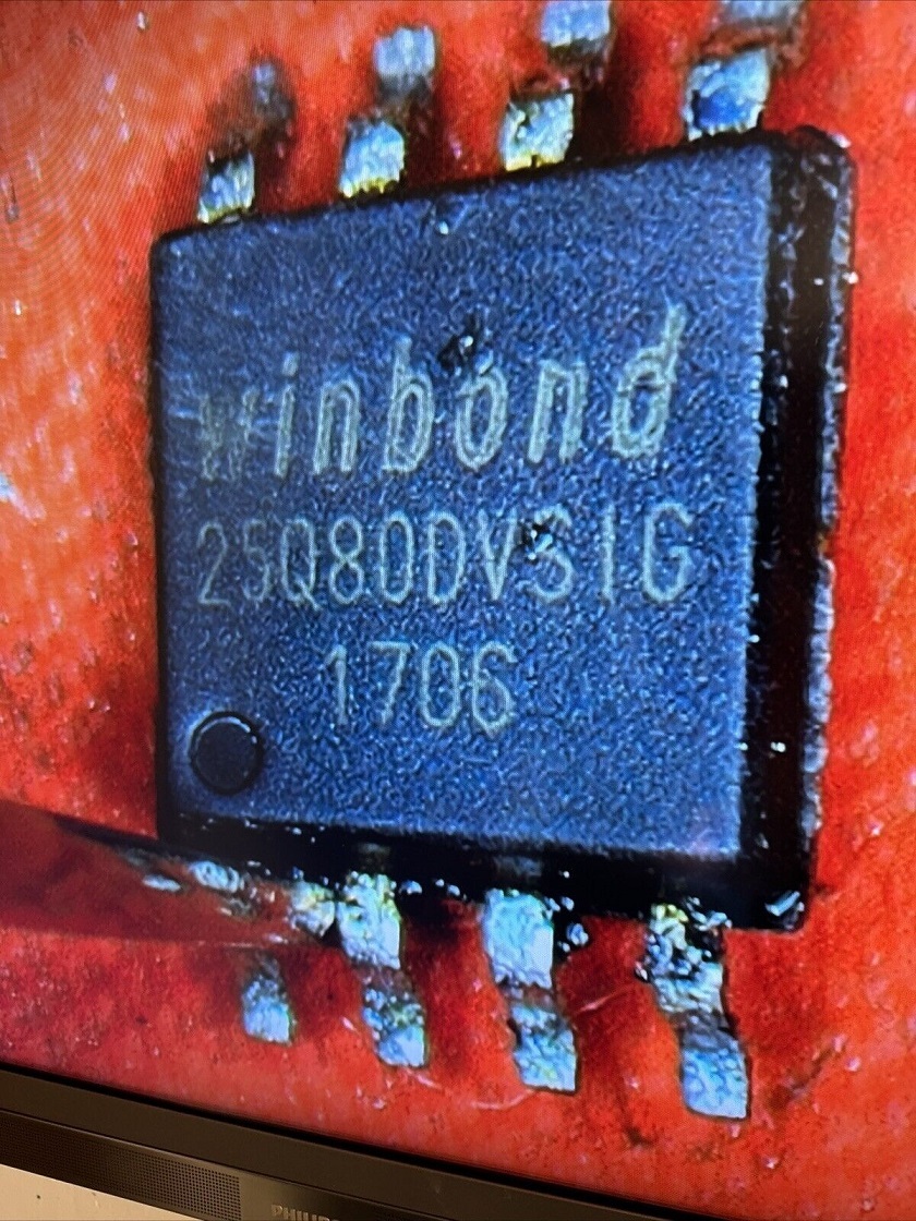

                    Hello all, I have a blown thunderbolt 25q80dv chip I think its the thunderbolt anyway, Has anyone got a file they can share please.
                    Its model CAM0001 LA-E331P, Thanks.
