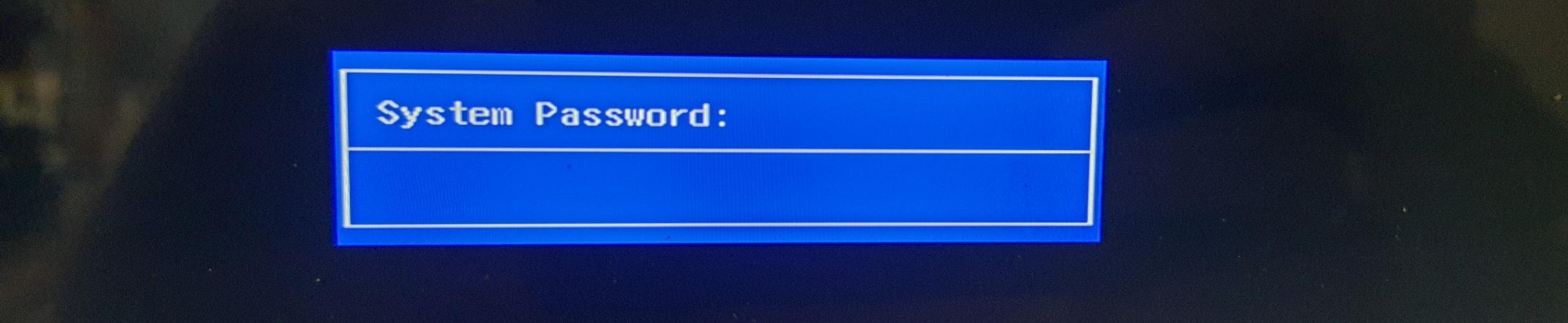

            • okraglaczek
              • Apr 2014
              • 17
              • poland
              Re: LENOVO BIOS AUTO-PATCHER for Supervisor Password Removal
              Originally posted by AAAC
              @okraglaczek
              Post a picture of password screen.
              Look
              • fire1234
                • Dec 2017
                • 77
                • Poland
                Originally posted by okraglaczek
                "Maksim" password Does not match
                Try 2x3c45op
                • okraglaczek
                  • Apr 2014
                  • 17
                  • poland
                  Originally posted by fire1234
                  Try 2x3c45op
                  Invalid password
                  • BootLoader1
                    • Aug 2020
                    • 70
                    • Poland
                    Re: Lenovo 900S-12ISK byg42-nm-a591
                    Password is :2x3c450p - 7th char is zero
                    • fire1234
                      • Dec 2017
                      • 77
                      • Poland
                      [QUOTE=okraglaczek;1132426]Invalid password[/QUOTE
                      sorry, I rewritten it wrong. Try 2X3C450P
                      2 - two
                      X - x
                      3 - three
                      C - c
                      4 - four
                      5 - five
                      0 - zero
                      P - p
                      • okraglaczek
                        • Apr 2014
                        • 17
                        • poland
                        [QUOTE=fire1234;1132440]
                        2 - two
                        X - x
                        3 - three
                        C - c
                        4 - four
                        5 - five
                        0 - zero
                        P - p
                        after changing "o" to zero the password is correct!
                        Thank you for your help
