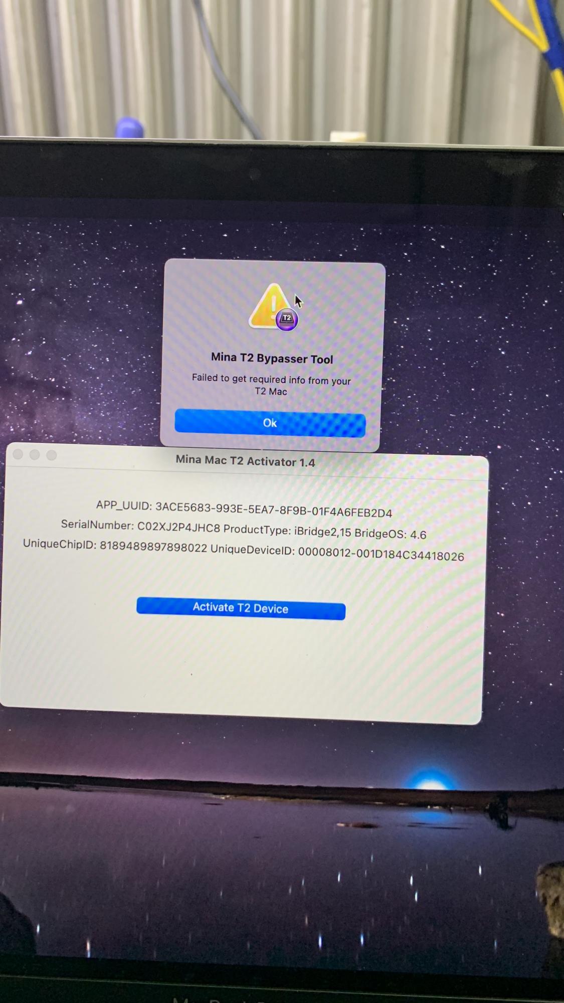

 Not true. MDM can still have Activation lock to the company email. Changing the serial will solve this issue and remove the lock for good. Even with iBridge 6+sigpic

 Re: T2 Chip Programmer Tool
 But when i try to install os on mdm lock after serial change it give activation error.Comment
 Bypass method is not permanent why would anyone want to do that when changing the serial is 100% never coming back even if you DFU restore it?
 Also to answer the other guy when he changes the serial it gives activation error, this means it's iCloud locked and not MDM lock which means the T2 chip is the culprit, MDM locks do not use the T2 to communicate to verify. It goes like this
 Apple Server checks in these steps.
 1. Apple server checks Serial number , if it kicks back as MDM it follows up with two scenarios, you either get into Os Install or you get the company email lock.
 2. Apple server checks T2 chip serial after step 1. So if step one is a serial that is changed and then checks to see if the T2 chip is assigned correctly, which in return will give Activation Server Error messages.
 So in theory if you change the serial of an MDM device to new serial then you sign into your device with your iCloud after OS install and say you DFU reset it, that serial is now assigned to your iCloud with the T2 chip until you remove it.
 Hope this helpssigpic
 MEOWING IN THE IMPOSSIBLE UNIVERSE!Comment
 Original first iCloud will always kick back. No matter what you do, the first registered iCloud will always come back first. Meaning it needs to be removed. The second iCloud will not even exist, only when you use the device in of itself.sigpic
