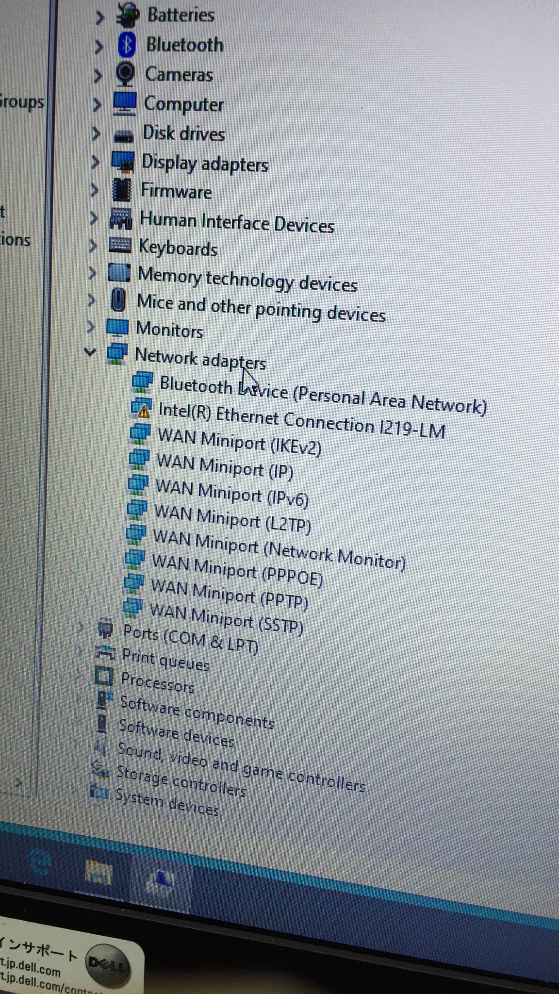

    Hi every body!
    please help me clease ME bios dell latitude 7470
    thanks so much

    Re: please help me clease ME bios dell latitude 7470
    What's your issue , the dump you post is configured !
    It means the ME firmware is already cleaned.
      yes, this is cls file ready, but network error
      can you help me
        can you help me
        same issue any help
