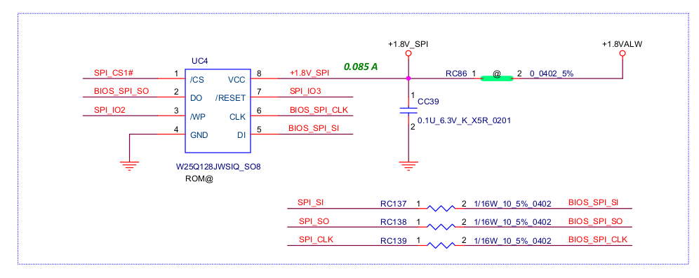

                    You're right, according to the schematic, your BIOS is 16.8 MB (16,777,216 bytes) and should be found under the name UC4 (board number space).
                    I think there are two options.
                    1. Your BIOS is defective. Hard to say without BIOS.
                    2. Or a hardware defect. It can also be.
                    You should just upload your original BIOS.​

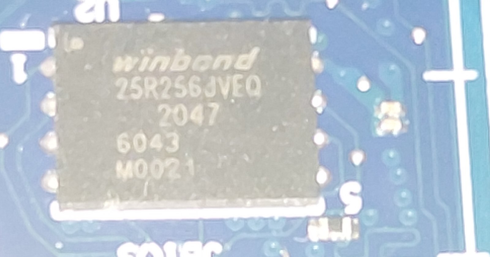

                          Hello, I think I found it. Photo below. But the chip is strange, its legs are very short and you will probably have to solder it. Because I used a clothespin.
                          • hoaca388
                            Badcaps
                            • Jan 2022
                            • 12322
                            #55

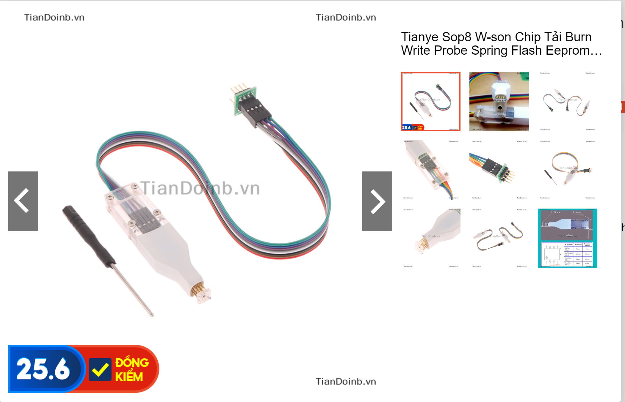

                            Click image for larger version  Name:	dataurl678297.png Views:	0 Size:	359 Bytes ID:	3294571
                            https://shopee.vn/Tianye-Sop8-W-son-...7-e86cbbfcd89d
                            ​https://www.badcaps.net/donate
