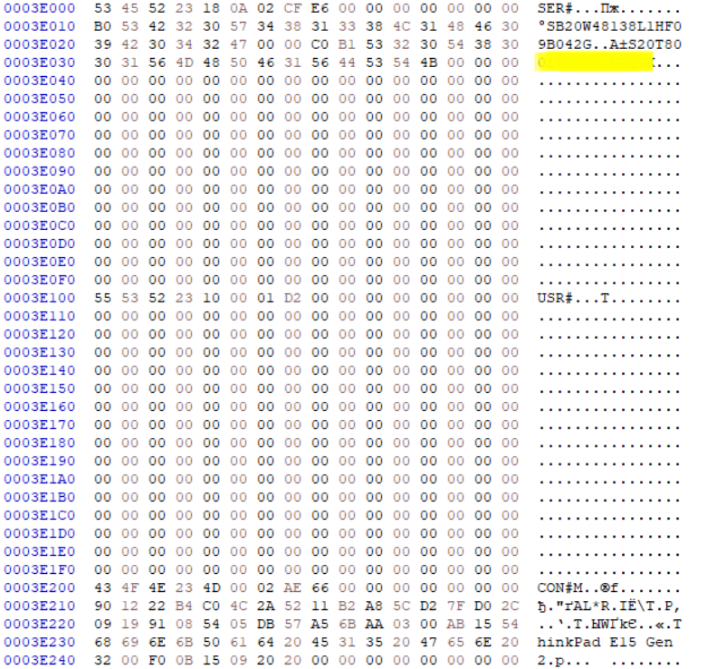

            • Tom_avia
              • Jan 2020
              • 26
              • Lithuania
              Re: LENOVO BIOS AUTO-PATCHER for Supervisor Password Removal
              Update to this post.
              So, managed to find working EC dump from off site. It works well, but here is a problem. I also need to copy region with info about serial number to new dump. When I copy this area of code to new dump and turn on laptop, I get this message:
              0177. Bad SVP data, stop POST task
              Please help me to copy information about serial number to new code.
              Here I share EC dump from off site.

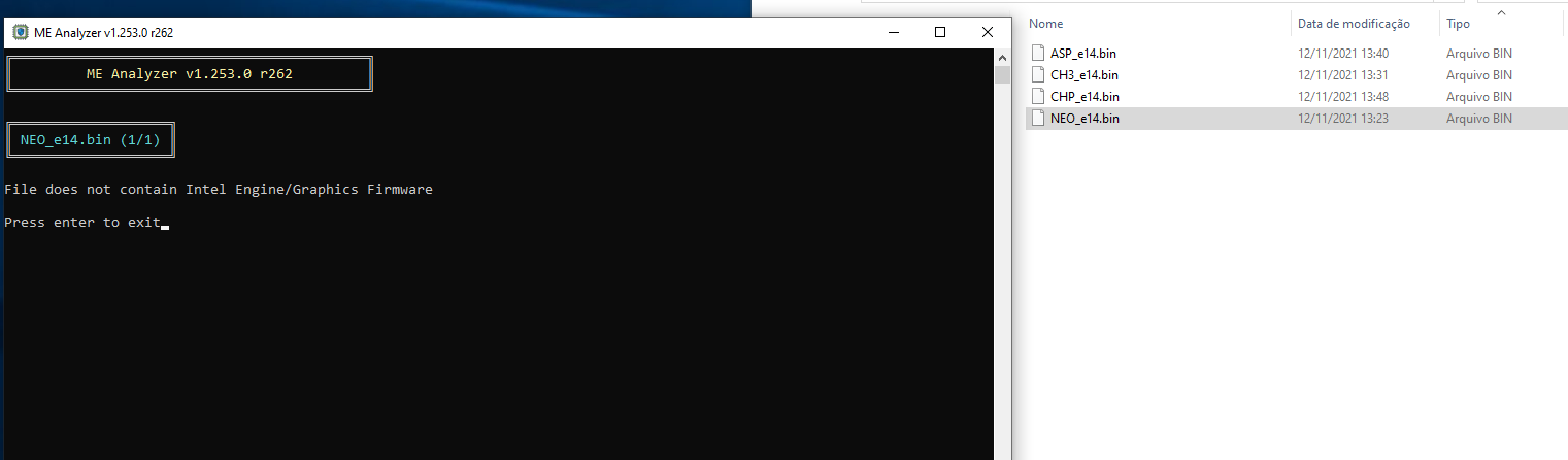

                  All shared in many forums dumps for ThinkPad E15 gen2 have this problem:
                  File does not contain Intel Engine/Graphics Firmware.
                      they are probably AMD, I have an E14 Gen2 AMD, and my original DUMP doesn't contain Intel Engine/Graphics Firmware. But if it's an Intel I have a clean original DUMP.
