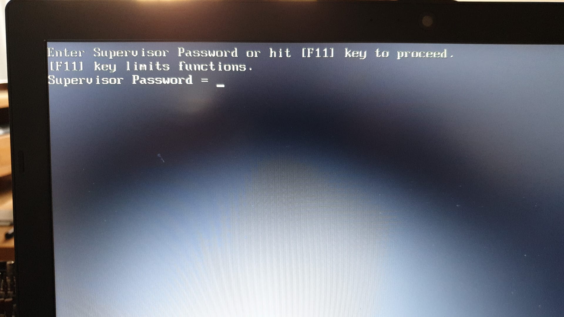

                              Hello everybody!
                              Hopefully somebode can help me with the same laptop, but with a small difference in the password problem.
                              I get a different message on the screen (see photo).
                              Because of the difference I can't use the CTRL - TAB - CTRL - ENTER keys to get the Challange Code. Without the Challange Code I can't recieve a Responce Code to unlock the laptop.
                              Can anyone think of anything to get this fixed?
                              Thank you all very much in advance!!!
