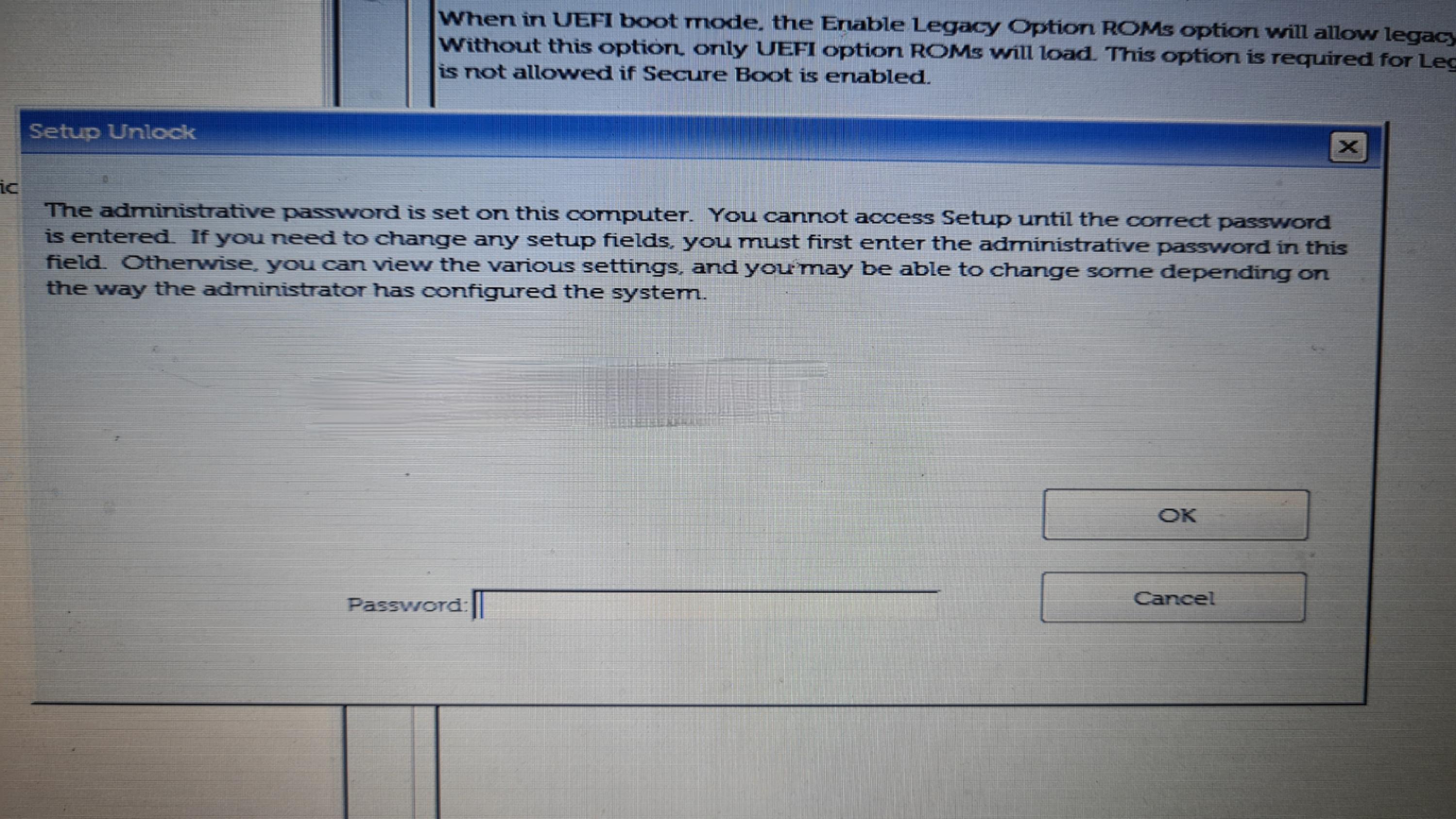

                        #91
                        Re: Default DELL Latitude E5470 LA-C631P Bios password
                        Originally posted by Vesko356
                        I did as you asked. However, neither of the passwords provided worked.
                        The prefix is: 6FF1
                        The password required is the one which unlocks the bios within the bios. So, not the one which usually prompts at the post-stage. I can get into bios, and view all the options but can't make any changes. The client also doesn't know the password.
                        Any help would be appreciated

                          #92
                          The prefix is: 6FF1
                          Did you tried passwords bellow with QWERTY keyboard, confirming the password with Ctrl+Enter, Enter?
                          NxiSws6Eo8QwWC1e
                          9jN3z6s41QrZF0I4

                            #93
                            NxiSws6Eo8QwWC1e
                            9jN3z6s41QrZF0I4
                            I used both passwords, but neither of them worked.
                            I've included an image of the requested password to prevent any confusion.
                            Could someone assist, please?

                              #94
                              what's the point of image with covered service tag? you did not "prevent" any confusion by contrary! You have already posted bios dump which contains service tag. Think, it's for free!
                              try
                              NxiSws6Eo8QwWC1e
                              use QWERY keyboard, use capslock for uppercase and after typing password press left Ctrl + Enter.
                              if you had read and understood what Vesko wrote you would have found the solution yourself.

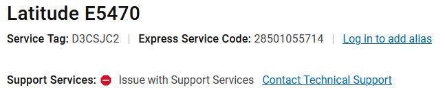

                                • 20481
                                #95
                                The service tag is required as per the rules https://www.badcaps.net/forum/showthread.php?t=103570
                                [*] Provide the full machine model number, serial number (or Service tag, SNID) and the board model number (see https://www.badcaps.net/forum/showthread.php?t=88758 )

                                  #96
                                  Re: Dell Latitude E5470 bios password
                                  Hi there, can someone help me with an Admin password for HLQ1XF2-6FF1
                                  I tried https://beta.bios-pw.org/ but that didn't work. I tried entering it 4 times and I tried the other 7 suffixes, that didn't work either.
                                  Thanks!
                                  • Jimbojet22
                                    • Oct 2023
                                    • 3
                                    #97
                                    OR, I have another identical computer with a dead processor. Which IC needs to be swapped to move the password protection out of this machine?
                                    • Jimbojet22
                                      • Oct 2023
                                      • 3
                                      #98
                                      Please disregard my previous posts asking for help!
                                      I re-read these posts, and tried the password again using LEFT_CTRL-ENTER to submit the password, and that worked. I can't believe it worked.
                                      Thank you very much for your help! You guys rock.
