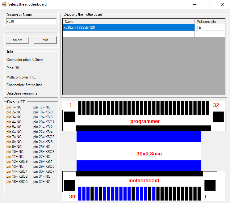

    Hi guys
    Need new Dump for this machine, I have cleaned ME but dont work.
    Model Name S530U
    Motherboard X530UN Rev. 2.0
    Discrete Nvidea N185-8TR-5-A2
    Intel® Core™ i3-8130U
    ite8995e-128
    EPROM GD25Q64C
    The computer work ok, but after normal shuting down, will not power up again, only turn on if I desconect the battery for a few minutes.

      Your Bios work, but do the same thing, after shutdown, only turn on after disconnect battery, maybe is the EC bios on SIO.
      Many thanks.

        Post your EC dump if you have it

          I have a Vertinov programmer SAS, but I dont have the pinout of motherbord.
          but I need the boardview or schematic for obtain the pinout of keyboard conector.
          Thank's for your help.

            here you are

              Thank's bro, I'm gonna do the line for programer, after read I will post here... and thanks again
