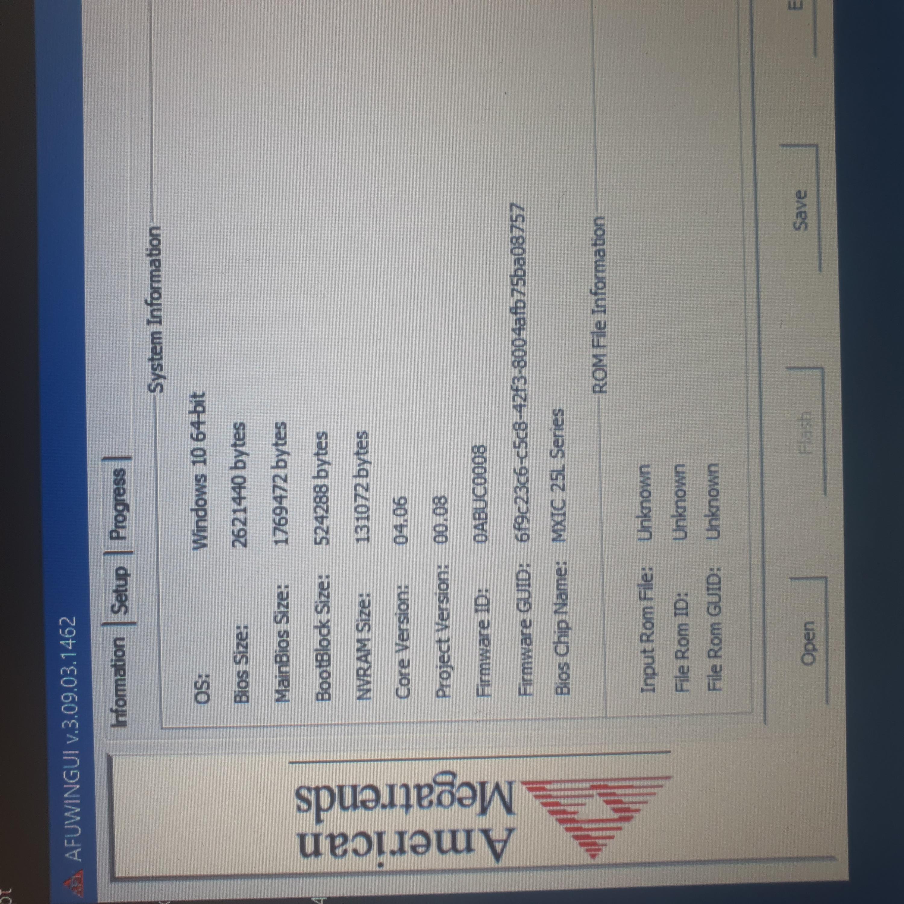

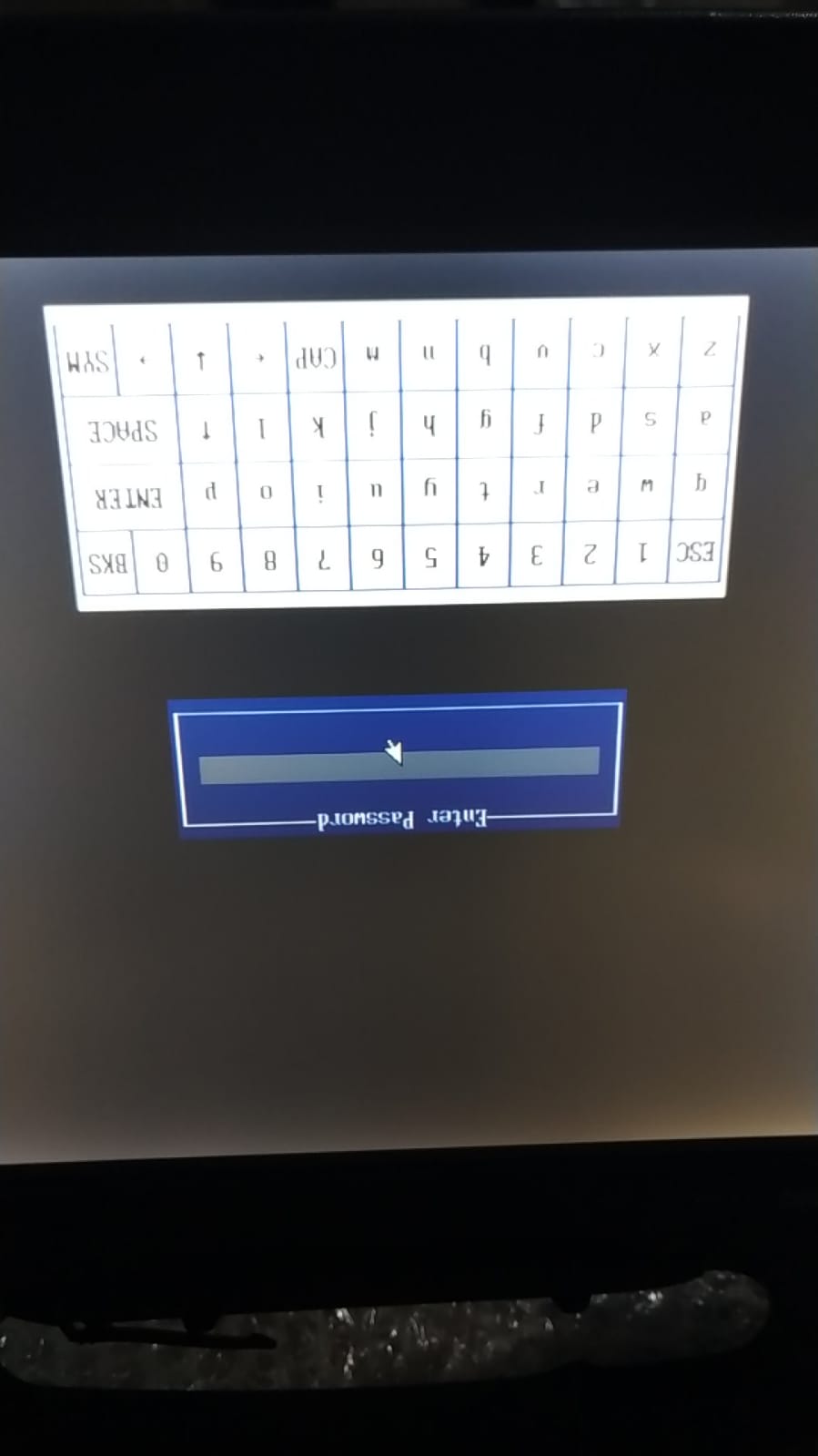

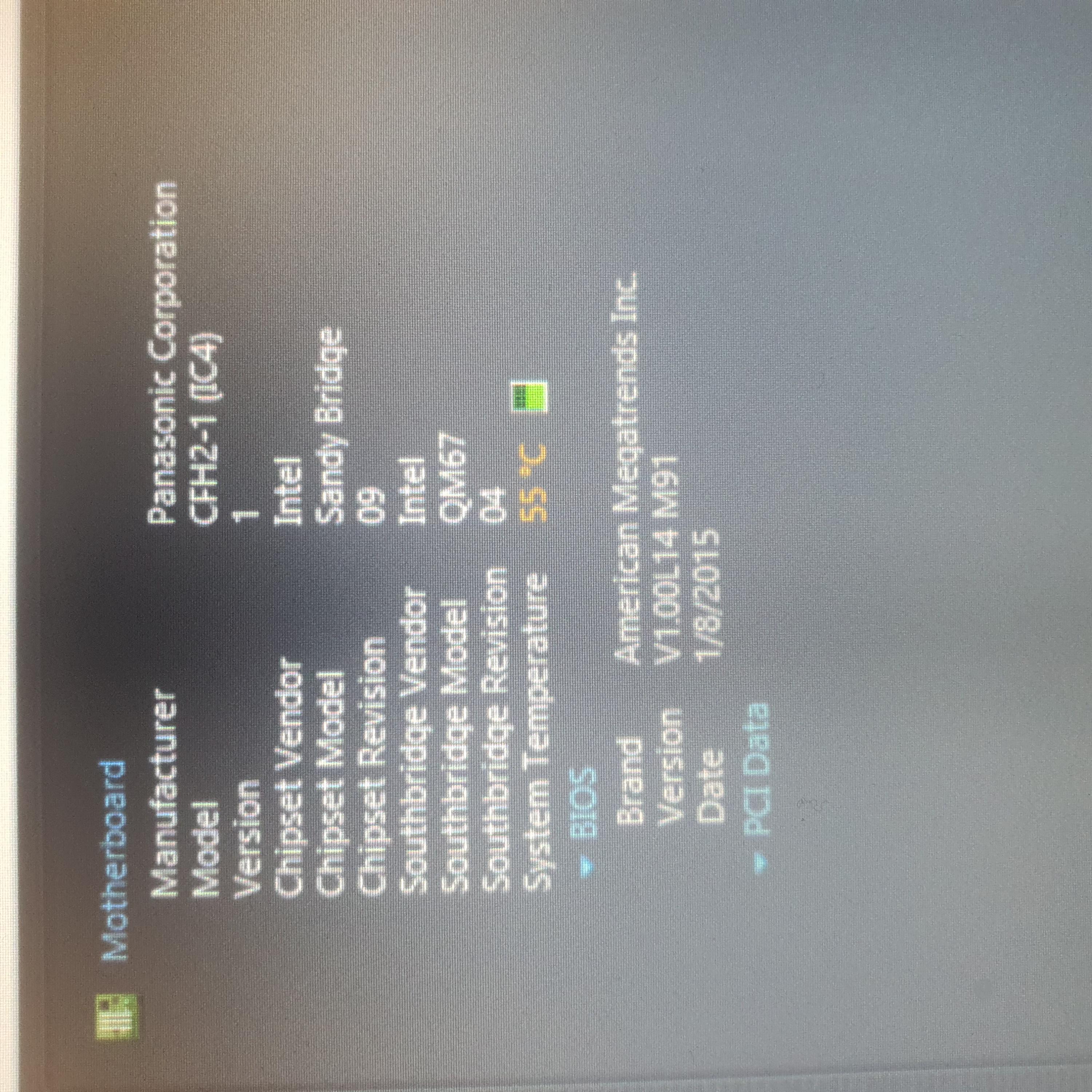

    Hello to everyone.
    After setting the bios settings as default, bios set itself a password.
    please help remove the password. Thank you.

          I've checked your file two days ago trying to recover the actual password, but the password is hashed.
          So if you used a programmer to obtain the file you posted, then you can give a try to this file:

            Re: Panasonic CF H2 MK1 Bios password help !
            Originally posted by W140
            Can some one please help unlock this panasonic CF-H2
            this is not full bios... better you read via spiprogrammer
              sorry. it asks for password again.
                added
                      try
                      enter password
                          Originally posted by evserv
                          Try
                          Thank you
                          is working
