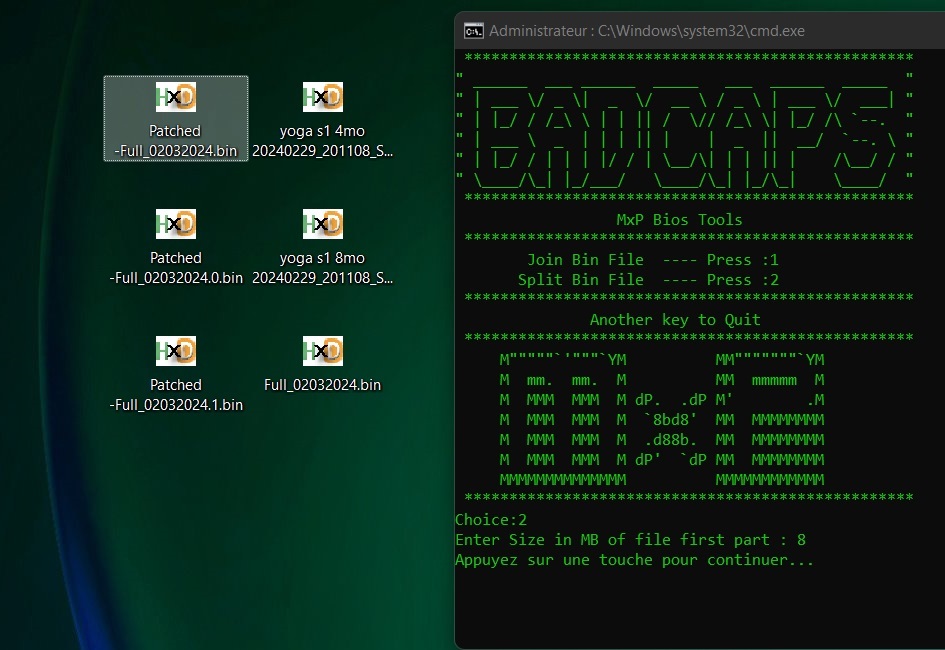

                    News
                    Patch possible on yoga 12
                    Pach by bios, no need to reprogram EC (Kb9022Q)
                    - Just read the two bios files (8+4MB)
                    and join them with utility provided.
                    Click image for larger version  Name:	Sans titre.jpg Views:	0 Size:	143.6 KB ID:	3227238
                    Use Uefi Tools to modify your BIOS
                    Extract as is LenovoPasswordCP E4F272DA-237F-454C-8868-FCF096CF1C6C
                    Search AA382865-12B0-44E5-A731-6DEF4DF34CE7 LenovoPromptService
                    Replace as is LenovoPromptService by LenovoPasswordCP
                    LenovoPasswordCP must appear twice after
                    Split your file, select 8 for first file
                    Cleaning can help but not necessary
                    Password CP and Prompt may appear several times in relation to the bios templates, so all of them will need to be replaced
                    The patch allows you to access setup
                    - Load by default for the first time and restart
                    - Enter setup and go security
                    - type a blank password twice and save.
                    - Turn off, restore your original bios.
                    If you don't restore, the password will never be asked again!!
                    Tested here : https://youtu.be/f43JuDzA3yU
                    Booting may take time with different melodies, be patient!!
                    This patch also works on other models
                    https://www.badcaps.net/forum/troubl...10#post1873410
                    I'll leave you tested,
                    No Prompt, No Password
                    For clear EC KB9022Q as previously cited
                    Just replace 0x200 to 022F on your original EC Dump
                    no lost UUID ,serial and others numbers
                    Click image for larger version  Name:	PWD CLEAR.jpg Views:	0 Size:	47.1 KB ID:	3227237
