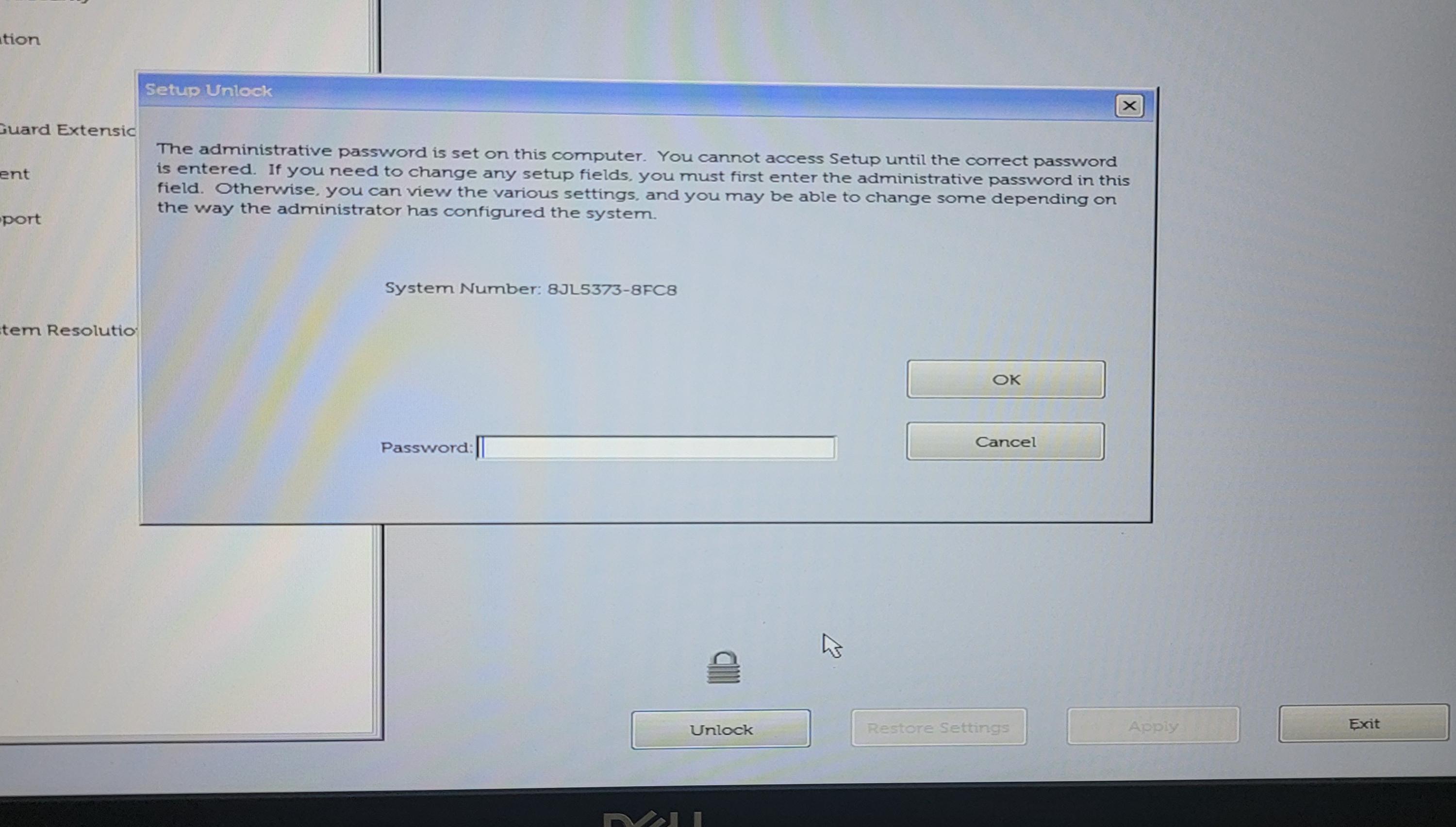

      Hey guys can i please get some help getting the reset codes for the latitude 5410?

        Hey is there anyone here that could help me please?

          How we can help you without your bios dump!!

            They're laptops from my workplace that were thrown out so i cannot login to do anything. would you be able to generate the codes with the system numbers?

              I can only help with patch your bios ; wait maybe somone can help you

                    Many questions
                    How did you get this file
                    do you have a programmer
                    what is the password you were asked to enter

                      Universal bios backup toolkit 2.0 is how i got the file. not what you wanted?
                      if im giving you the wrong file please direct me to get the appropriate tools
                      it's asking for the admin password to unlock the bios

                        Well , backup toolkit it's not advised and you must have a programmer .
                        you can't dump the chip without programmer
                        What's the admin password asked !
                        just to get a idea : https://www.youtube.com/watch?v=Ta_PPndnCTk&t=563s

                          I don't have a programmer i thought all the tools were software related
                          here's a picture of what i'm seeing

                            so i'm going to need this before i can go any further?
                            https://a.co/d/4Iar2f5

                              Yes , there's many choices , i m using rt809f
                              And the dump you post didn't contain the pwd , there's another at your motherboard
                              https://www.amazon.com/SETCTOP-RT809.../dp/B01HZO1YYY

                                Also the hot air station to desolder the chip from the board, and to solder it back of course, and the WSON8 to DIP8 adapter.

                                  So once i get the "HiLetgo CH341A" i can retrieve the dump file and give it to you to unlock it?
