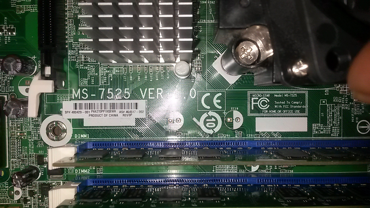

i need Hp Dx2420 bios dump
    hiii please help i need bios for hp dx2420
    I did a silly thing and flashed within Windows and didn't work. I have read my corrupted bios see attached file. Just now need a working bios dump for the Compaq /HP Motherboard dx2420 MicroTower. Not bothered which version of bios it is as I will update in Dos now instead of windows.
    The original version of the bios was 5.18 and after flashing via windows had no output from the screen after reboot!
    Had a look around on the web without any luck
    Thanks in advance
    Strange I was convinced I uploaded the bios file and put this information in a new post!
    I have managed to sort it out now. But I will upload my corrupted file and my modified file with slic 2.1 cert with xeon supported cpus as well :0
    Just make sure to flash with award software in dos bootable usb flash drive using rufus using command line awardflash bios.bin
      The Motherboard is a MS7525 Ver:1 which I am sure I put that information in the title of the New Post! I don't understand how it has been merged with this old post from someone else. I guess the moderator has merged it.
