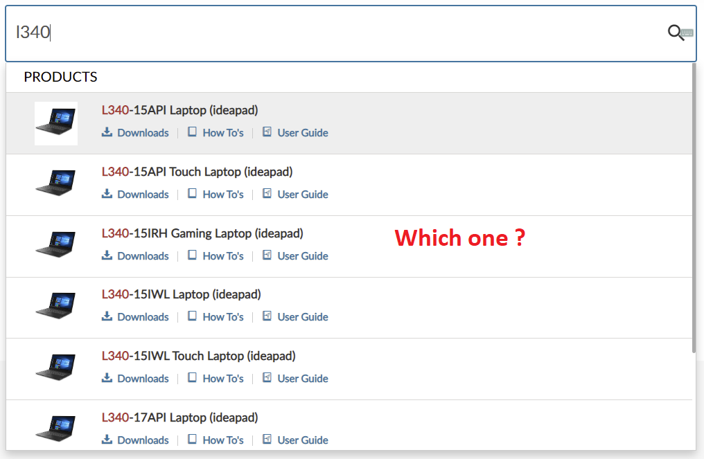

              The bios extracted from the Lenovo site update is for "L340-IRH15" or "17IRH" ...
              DMI 632000 - 633FFF
