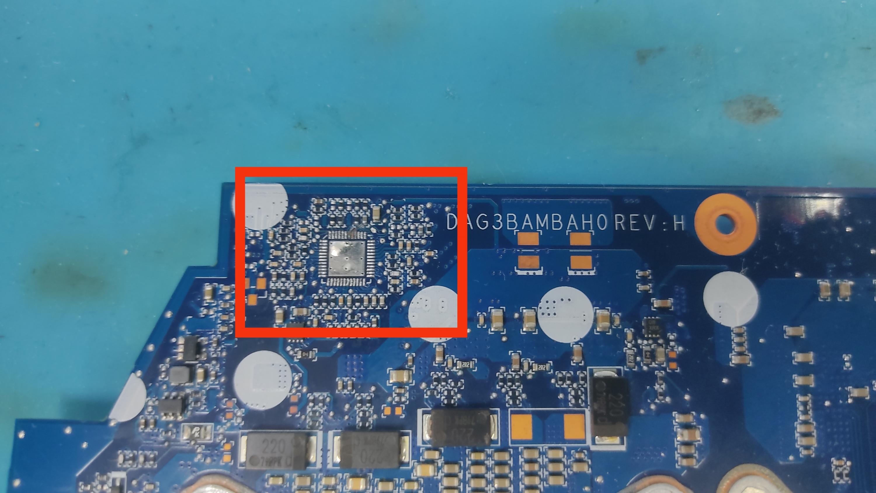

          Re: G3ba dag3bambah0 rev h w25q64jv
          DAG3BAMBAH0 REV.H
          PWM controller IC - CPU power
          ISL95829A
