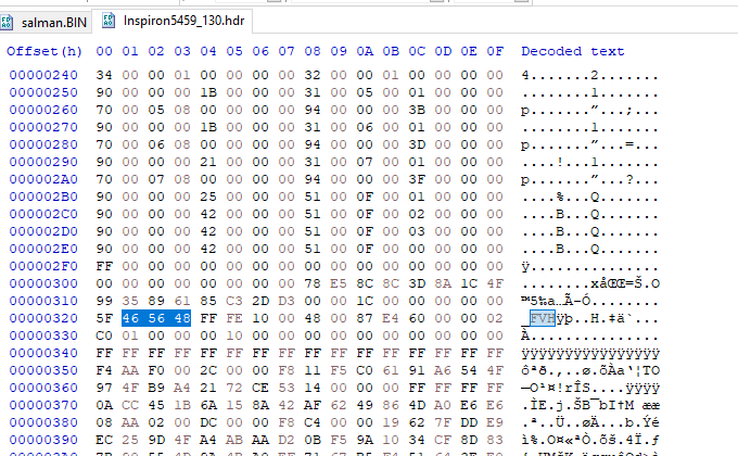

Inspiron-15-5559-AAL15 LA-D071P unpack hdr
  • foramlaptop
    • Feb 2015
    • 50
    • pakistan

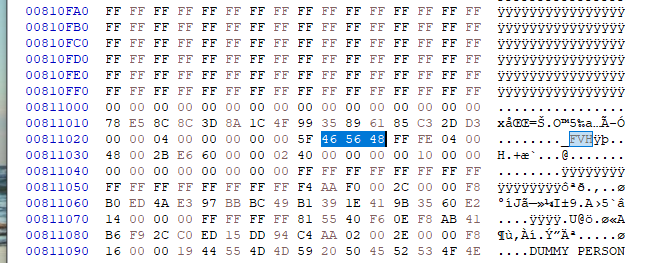

    help me
    dell hdr file in found bios 9mb file

    Re: Inspiron-15-5559-AAL15 LA-D071P unpack hdr
    what's your issue !!
    what are you looking for !

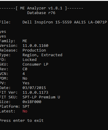

      power on but not display and no beep amp meetar .55 amp lod and other bios .15 amp lod

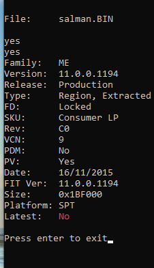

        Try this bios at post #16 https://www.badcaps.net/forum/showthread.php?t=54542
          Originally posted by SMDFlea
          i wil try all bios but not solved

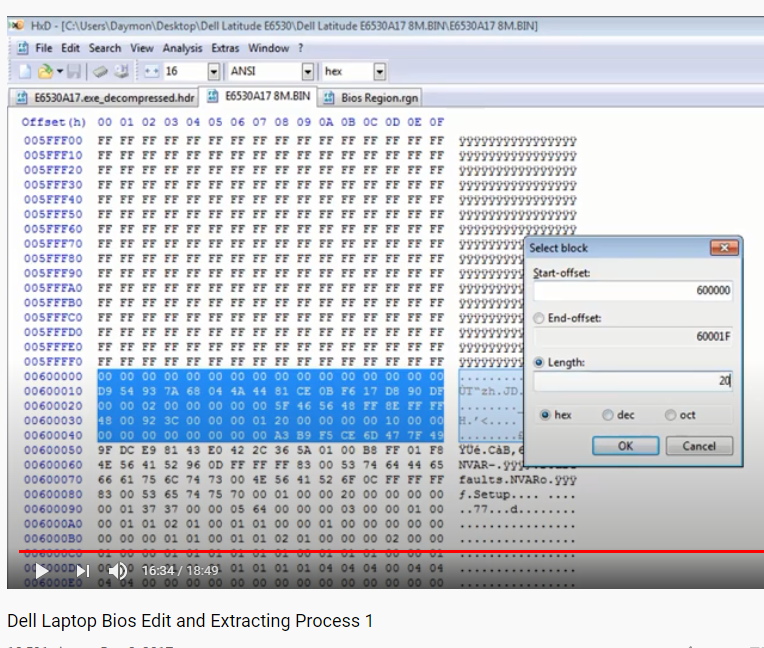

            i want clean hardware enterys (ram,hdd,dvd,usb flash,and etc) removed in bios nvram area

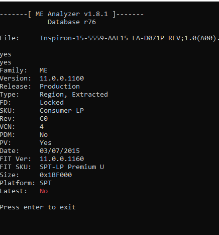

              Both the bios you posted are non-vPro , try this bios at post #10 https://www.badcaps.net/forum/showthread.php?t=73855
