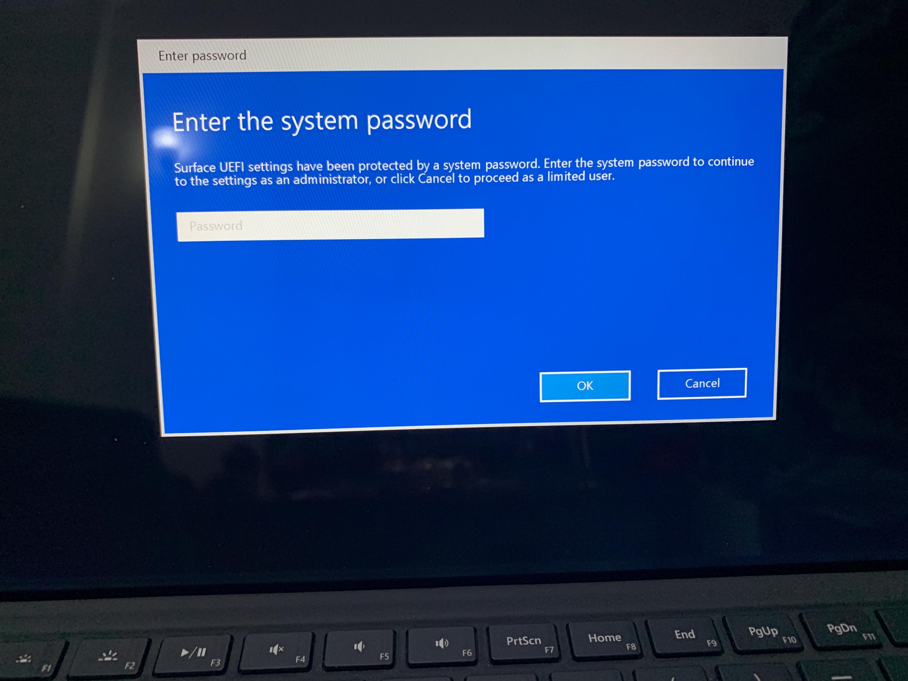

      i have a SP4 i7 6th gen 8gb 256gb model.

          If you really did read my posts, I have said multiple times that surface pro 4 password cant be decrypted.
          Only one byte is modified, which disables the password, thus no serials or other information is lost (I don't consider it an unlock if theres any information lost besides password/security settings)

            yes i did read many of your contributions and i do understand it can't be decrypted as of yet.
            But does disabling it allow to reset it to some new password? Removing the old one completely in the process.
            As of now i am stuck in a training institute will be sent home on 20th January will send you the BIOS dump then.
            Can you guide on how to understand BIOS and learning what to modify what not to modify?
            Your help uptill now has been greatly appreciated Thankyou.

                    ThankYou its unlocked but no matter what i do it does not Boot from the USB, i tried fresh windows10 downloaded iso, i tried backup from recovery media i even tried to boot into UBUNTU live media but no such luck.
                    Any Ideas?
                      Any Ideas?
                      Is your Secure Boot turned off ?
                      Did you try using Rufus to create a bootable USB with GPT and UEFI options ?
