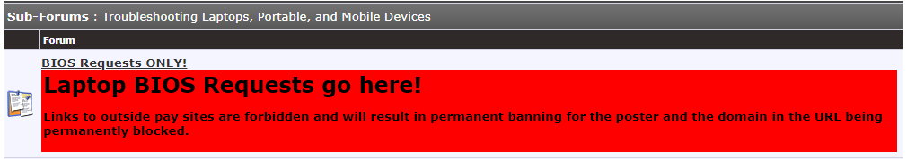

    Re: lenovo ideapad 310-15isk, NM-A752 Rev:1.0
    Originally posted by niggi
    brothe i need this bios plz
    Bios request here! :
    https://www.badcaps.net/forum/forumdisplay.php?f=40
    Also would be help when ask a request with upload your bios backup. I think that is unwritten rules for it.

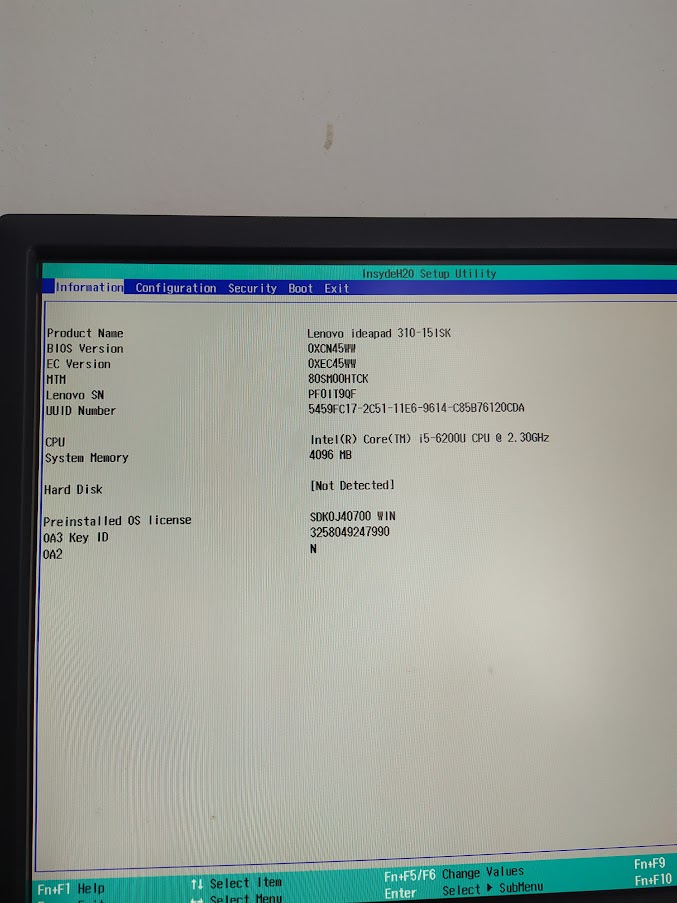

        Need lenovo ideapad 310-15isk bios dump, Please read.
        Hello, I've flashed the bios on a lenovo ideapad and forgot to save a backup before flashing, and now it doesn't have a serial number, MTM, etc., can someone send a Bios dump from an actual machine with the serial number, so that I can locate and replace it. Thanks.
          • 22275
          Re: Need lenovo ideapad 310-15isk bios dump, Please read.
          here:https://www.badcaps.net/forum/showthread.php?t=65641 .If you intend to flash that bios the ME will need cleaning.
          • Tinfomais
            • Dec 2019
            • 20
            • Portugal
            Thanks but that bios is not the correct one, on the thread the user mentioned LA-D562P, that is the board for the 110-15isk not the 310, the board for 310 is NW-A751.
              • 22275
              Yes you are right about that one,that bios version is 1TCN22WW which is for the 110-14ISK, 110-15ISK.If you look at it with a hex editor it does say 310-15isk so i suspect thats where the confusion is.
              Try this bios + DMI + clean ME .
              0XCN36WW
              • Tinfomais
                • Dec 2019
                • 20
                • Portugal
                0XCN36WW
                Thank you so much, it worked like a charm. The laptop is now functioning like it should.

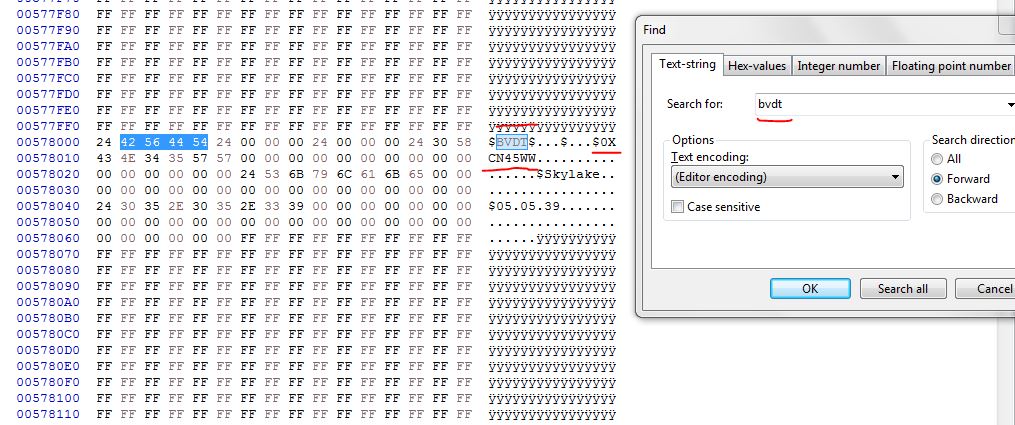

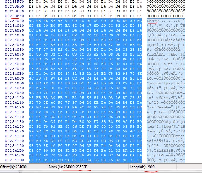

                          mn-A751 cannot open with FIT to clean ME. where is DMI?
                          hello.
                          I have this LEnovo 310-15ISK board with picture delay. i try to clean ME but FIT cannot open it. i try to find DMI which was no problen on 330-15ISK but here i cannot find nothing.
                          can somebody clean ME for me or point me where is DMI info?
                            • 22275
                            Re: mn-A751 cannot open with FIT to clean ME. where is DMI?
                            Originally posted by ktmmotocross
                            hello.
                            DMI 234000 - 235FFF .Your bios version is 0XCN45WW .Just use the bios at post #3 and copy your DMI to it,its quicker than cleaning your own ME firmware
                            • ktmmotocross
                              Boardkiller
                              • Feb 2014
                              • 3635
                              • slovakia
                              thanks mate.
                              that BVDT string is something in all bios or lenovo bios?
