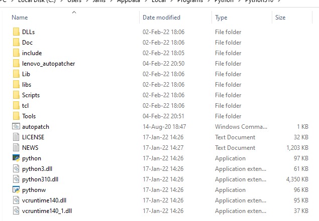

              Downloaded, unzipped, python installed, but after trying to run autopatch.cmd, it starts and closes straight away. What is causing this?
              • Rahmanali

                                      • stars-n-dust
                                        • Apr 2019
                                        • 59
                                        #1279
                                        Re: LENOVO BIOS AUTO-PATCHER for Supervisor Password Removal
                                        Originally posted by CornholioGSM
                                        ...put autopatcher + bin image into root of python folder
                                        Is this the correct folder? Still not working for me...
                                        • CornholioGSM
                                          • Feb 2014
                                          • 265
                                          • CZECH
                                          #1280
                                          ...put all files from autopatcher folder into root of python folder, then drag and drop origbios.bin to autopatch.cmd
