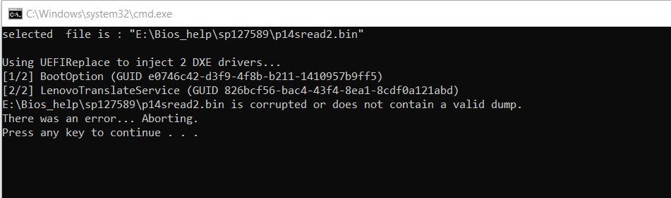

              #1386
              Re: LENOVO BIOS AUTO-PATCHER for Supervisor Password Removal
              hello
              I have lenovo p14s gen1 with svp "System Security: Supervisor password required"
              the auto patcher failed to find the lenovotranslateservice
              [2/2] LenovoTranslateService (GUID 826bcf56-bac4-43f4-8ea1-8cdf0a121abd)
              p14s read2.bin is corrupted or does not contain a valid dump.
              i have the bios dump verified twice.
              Please Help

              • hoaca388
                Badcaps
                • Jan 2022
                • 12352
                #1387
                Originally posted by due
                hello
                Please Help
                Maybe , this tool not support this model.

                    #1389
                    hello
                    Please Help
                    P14s is not possible to be unlocked via BIOS patch.
                    You need MEC programmer like vertyanov, svod
