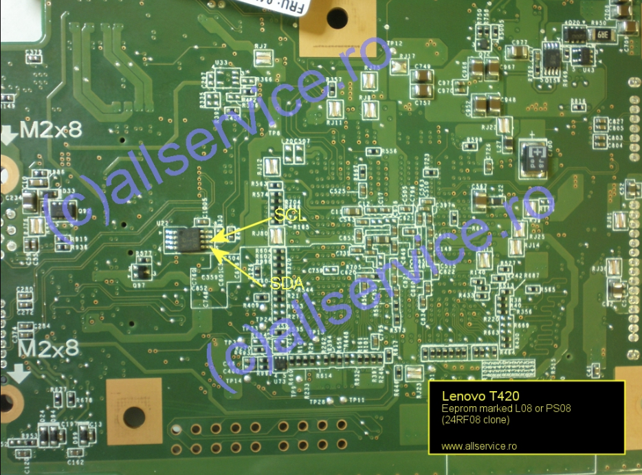

    Hello I Have ThinkPad T420
    SN: PBABVEX
    MTM : 4180CTO
    I try the steps but the patched file not generated
    Attached original file

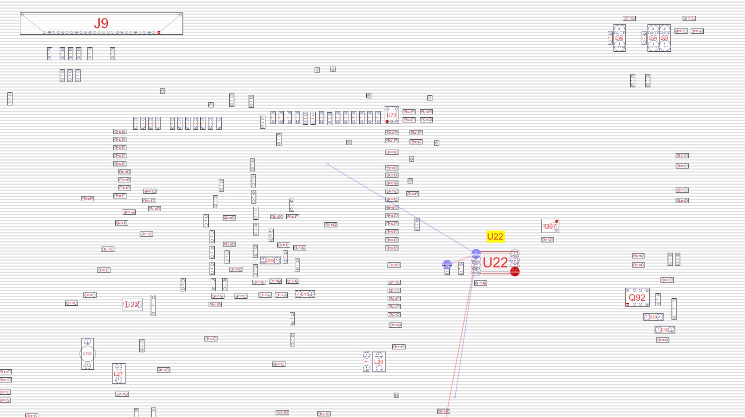

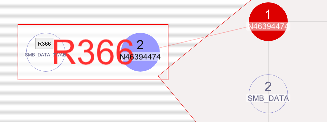

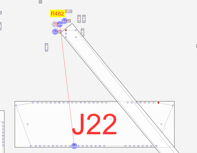

    • Maxpower3
      Bad Veteran
      • Feb 2018
      • 1399
      • France
      #4162
      SN: PBABVEX
      MTM : 4180CTO
      24rf08 IC
      test 30 and 32 pin of wwan connector
      https://www.youtube.com/watch?v=3nkDlHe6zPE
