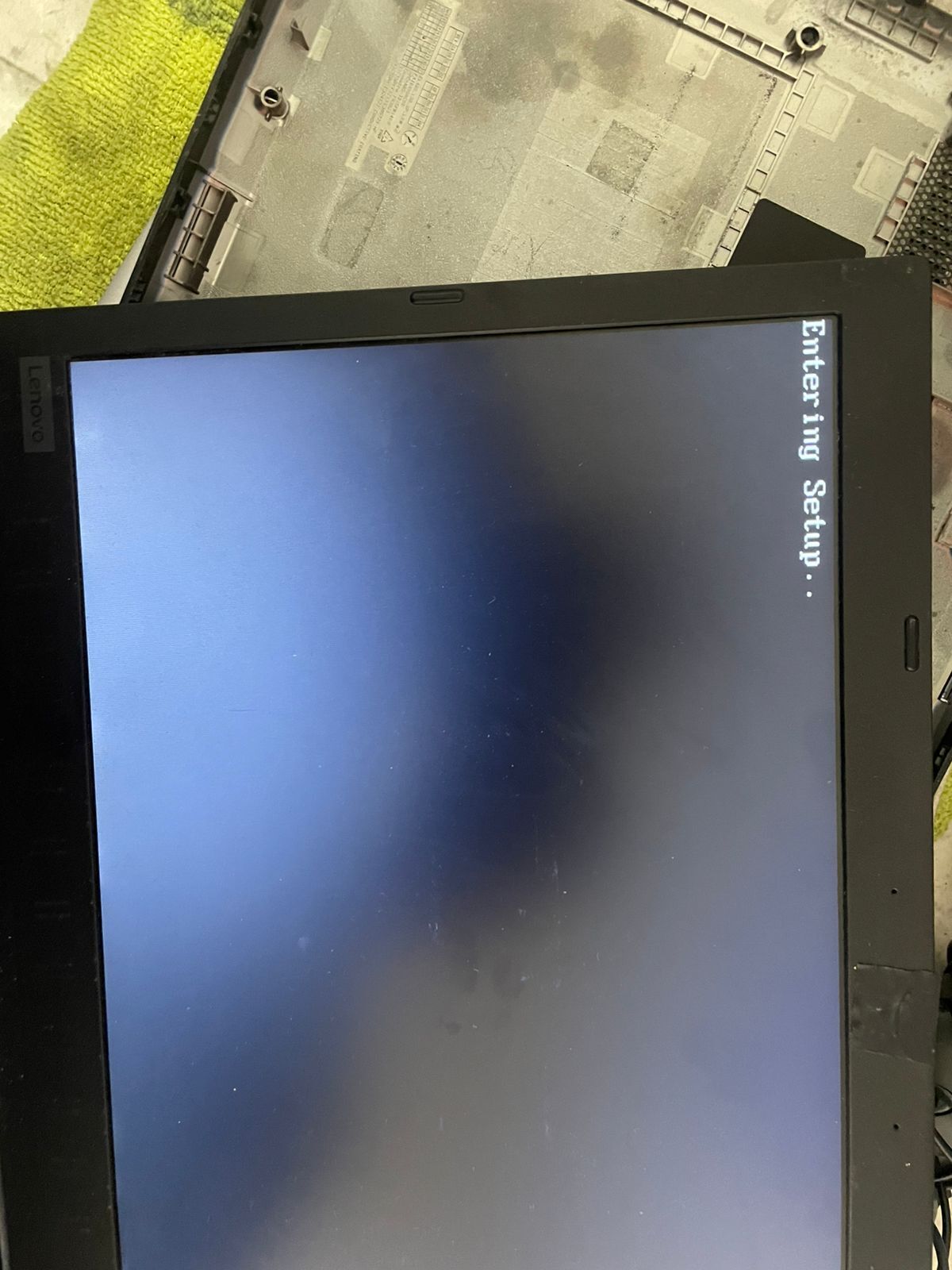

    i have a thinkpad l480 after the patching only stay in entering setup some one can helpme
      • 22084
      #4022
      Post the laptop serial number - https://www.badcaps.net/forum/troubl...before-posting .Flash back your backup and see if it boots
