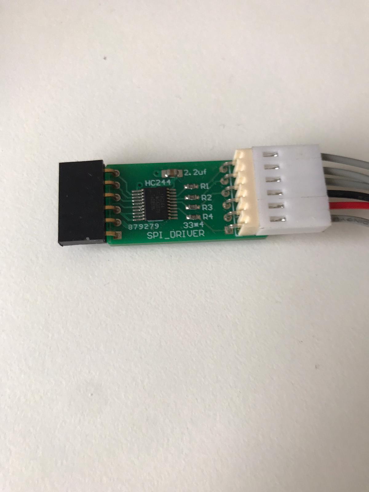

                            I am using the TL866 II Plus programmer with a SOP8 clip to read the BIOS chip of my Yoga 460. Although the Xgpro 10.75 software autodetects the BIOS chip correctly as MX25L12835F@SOP8 it stops reading with an ID error. The software returns "Check ID Error! Checked ID is:0x C0 00 08".
                            When I force it to ignore the ID error and read the chip anyway and try to read the dump in UEFITool it returns "FfsParser::parse: not a single Volume Top File is found, the image may be corrupted."
                            I guess, my TL866 II Plus programmer can't read the BIOS correctly. Can someone point me in the right direction to get a valid dump of my Y460 BIOS? Do I need a different programmer, software, or adapter for the clip? I hope I can use my TL866 II. I have attached a picture of my programmer setup.
                            Thank you in advance for your help.
                                        Hi, you need SPI-Driver to use TL866 II with the Clip.

                                          Re: LENOVO BIOS AUTO-PATCHER for Supervisor Password Removal
                                          Thank you very much! It seems I have to order it from China, as I can't find it at any shop here in the UK . May I ask you for a better picture of the wiring between SPI-Driver and the clip?
                                          Would it work with a CH341a programmer and my clip straight away?
                                          Sorry for asking all these noob questions.
                                          Thank you for your help.
