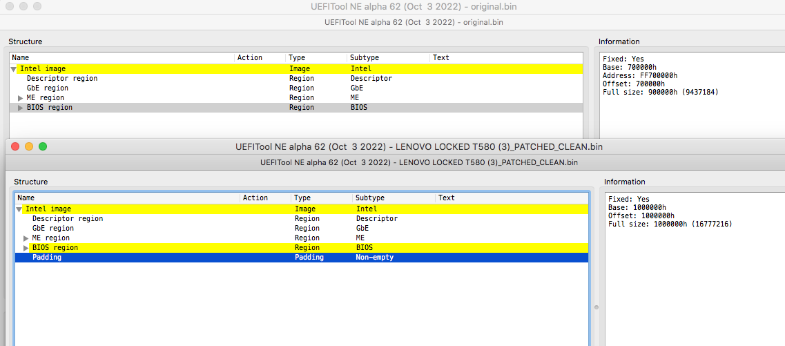

    Tried Neoprogrammer same thing see screen shot. I tried running the patch again but same thing. Only works when writing the original bin. Can you help.[/QUOTE]
    Your original is 16MB, the other one is 32MB ,weird

      Why is the patch file so big. Can you try.

        Difference between files is a Padding sized 16777216 bytes, after Bios_Region. Try removing it. Post Serial no. as in rules of this forum and I'll try to help.

          #3724

            #3725
            Type 20LA-S7F700
            S/N R9-OVDHP1 19/06​
            Thanks for your help.

                #3727
                Originally posted by IROC2022
                Type 20LA-S7F700
                there is no letter "O" in serial no. just 0 (zero)
                Try this file.

                  #3728
                  Was able to write file however screen stays black.Only heard a few beeps and nothing else screen not coming on.
