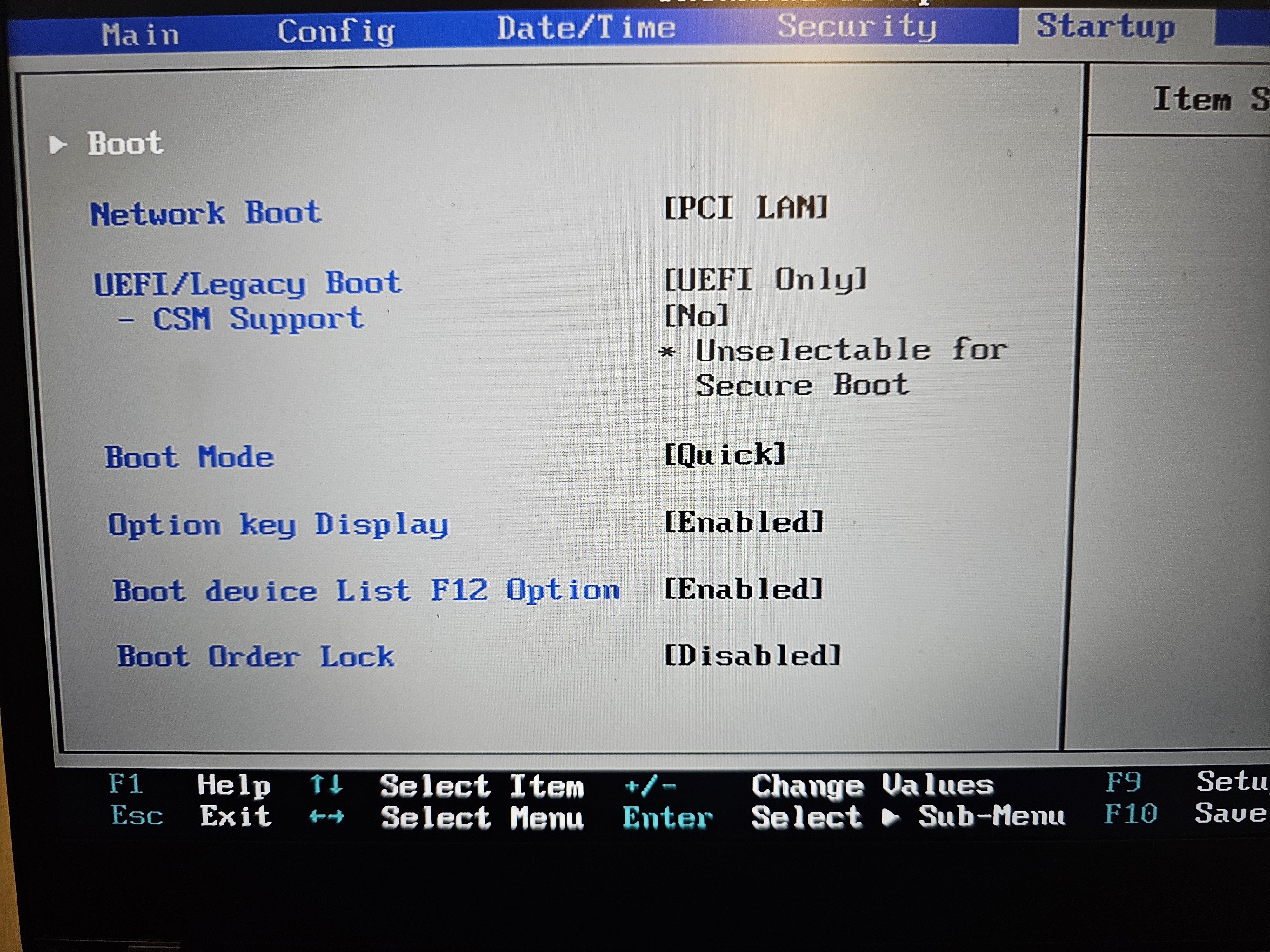

    i managed to remove the supervisor PW of my Lenovo T480s with autopatcher works like a charm.

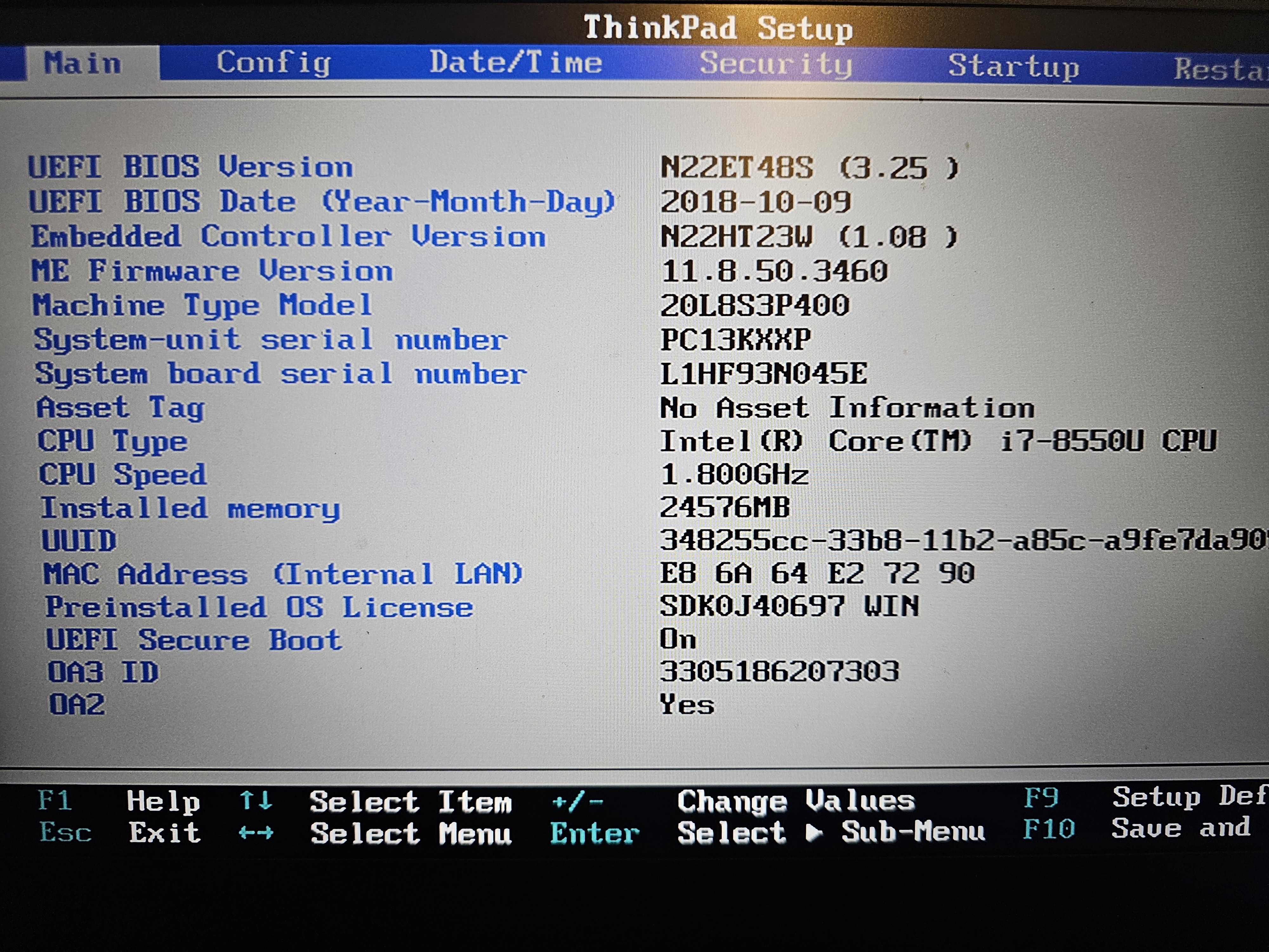

    The problem i have now is that i cant disable Secure boot. I tried many other dumps from Badcaps they do work but after flash there is the ME Version Line empty
    and the bios time is up to 70 seconds. Is there any possibility that some can mod my dump to disable secure boot ?
    Thank you in advance.

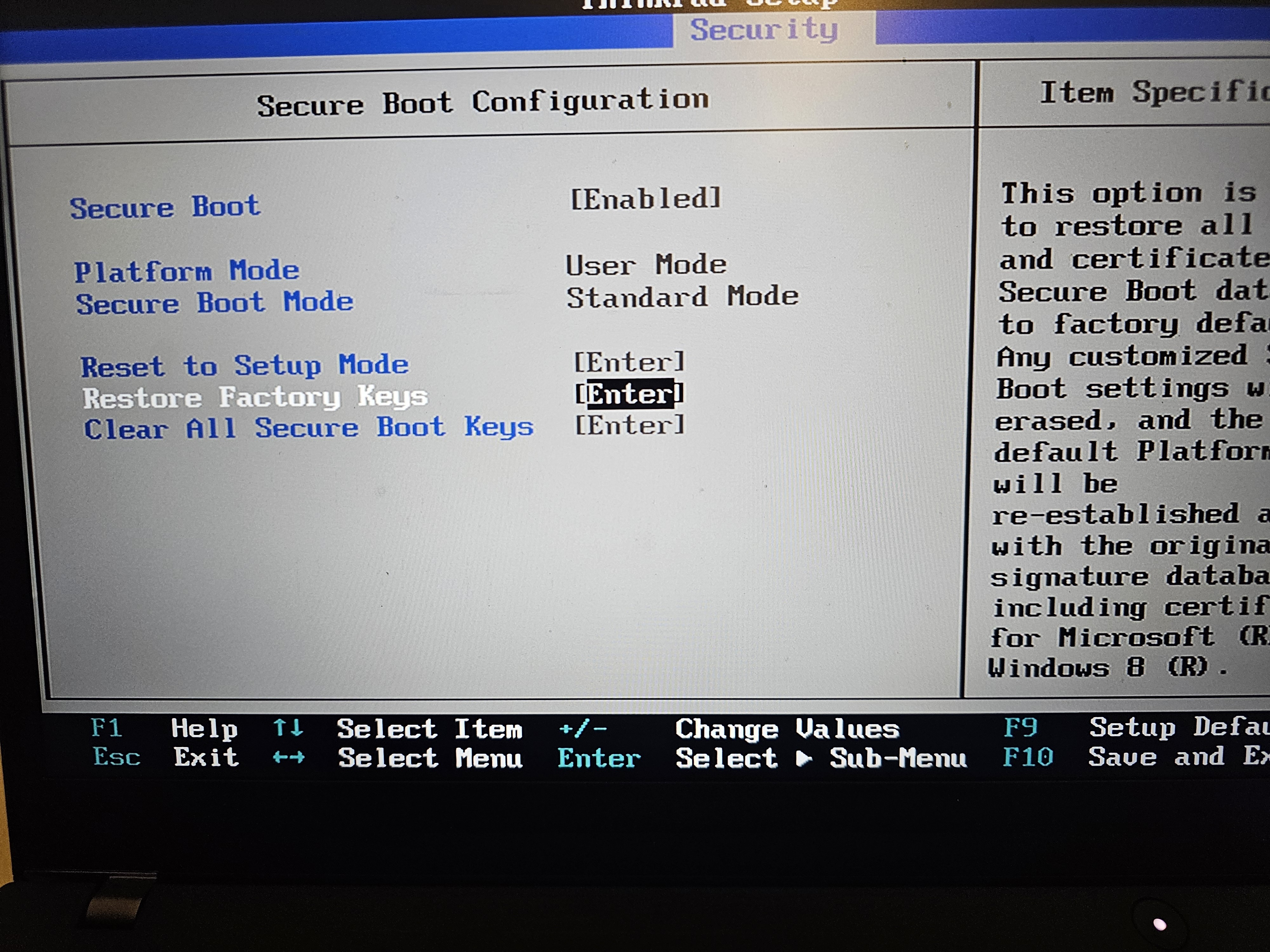

    Do you mean the Secure Boot option is in gray and you can't change it? Have you tried to set a supervisor password then try to change that option?

      Yes it is grayed out. I tried really everything setting password doesnt work for me. I dont know why.

          Really you made my day. I dont know why but your uploaded dump seems to fit perfect. Please tell me what did you do ? Did you anything about ME Clearing ? Or is it simply one out of stock ?
          As i said i patched my original dump with autopatcher because i forgot the supervisor password after that secure boot was disabled and couldnt be enabled. Every single dump i tried ihave some issues.
          As i said the orig dum secure Boot loocked other dumps needed more than 60 seconds bios time and so on. I would be very happy to hear what did you do to fix my dump ?

            I'm glad to hear it's working.
            This bios file isn't your fixed dump, it's a dump I "cooked" for my use and because Lenovo keeps serial, model, pass and other things in EC memory this dump works without errors on any T480s.
            In your case Secure Boot greyed out it's a sign of bad bios region and 60 s boot time it's a sign of corrupted ME region.
            So as a conclusion, it's easier to write this stock bios than cleaning ME and writing a new bios region to a faulty bios file...
