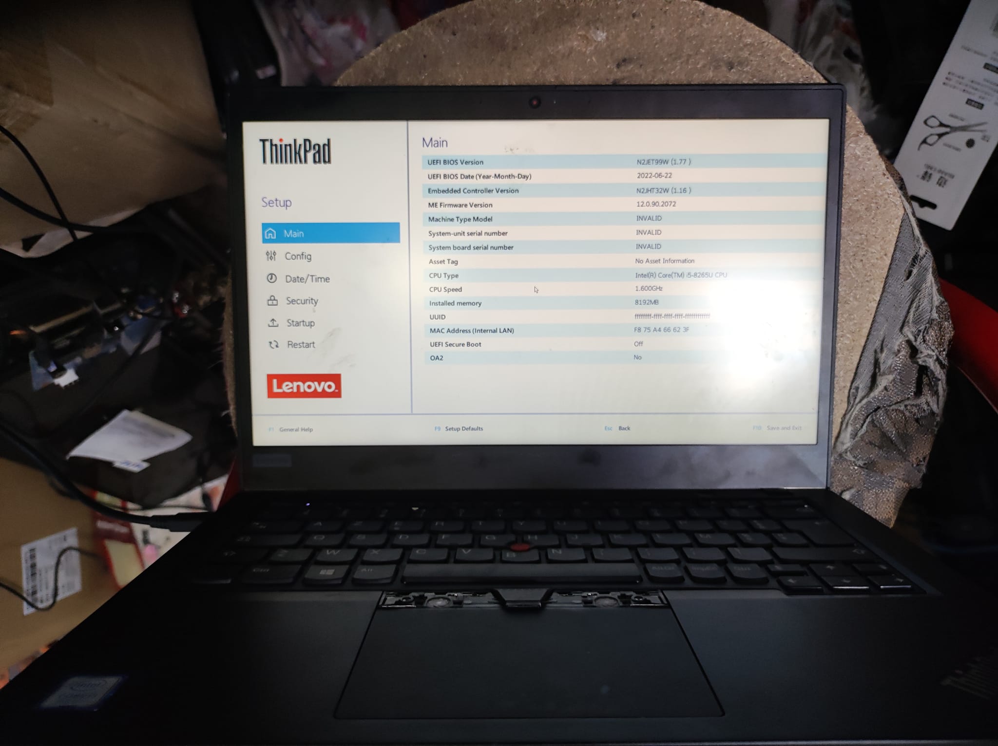

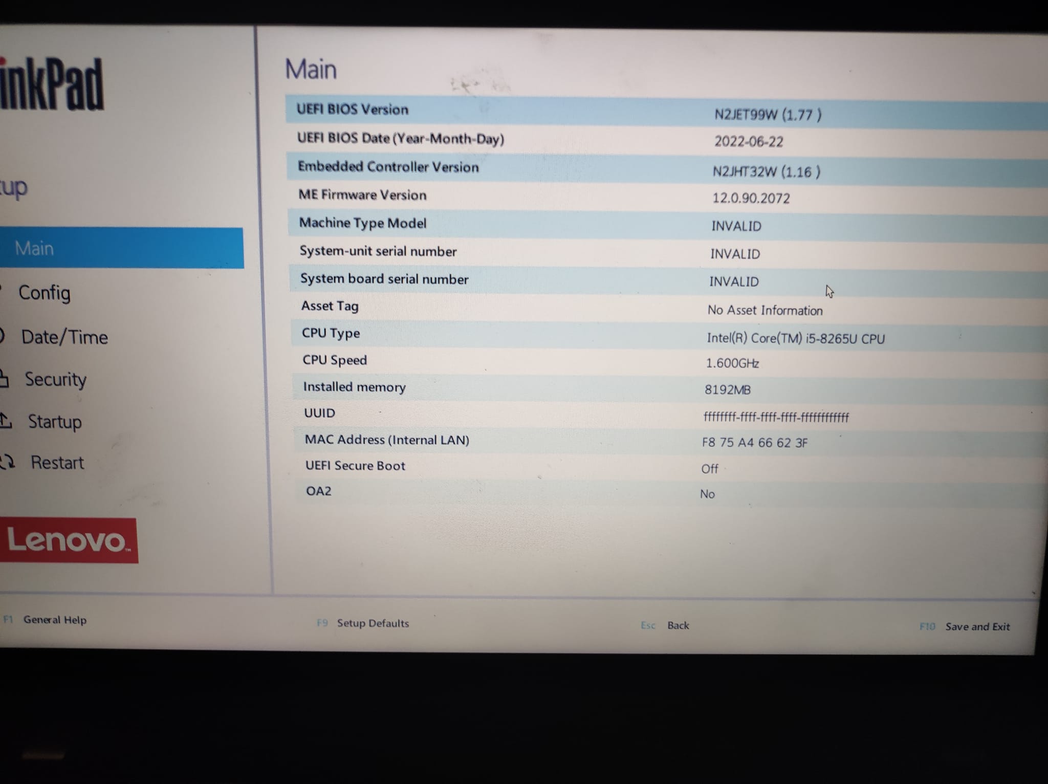

                                    • d_killuminati
                                      • Oct 2023
                                      • Denmark
                                      #2898
                                      Re: LENOVO BIOS AUTO-PATCHER for Supervisor Password Removal
                                      Hello new guy here
                                      Can someone verify my bios read?
                                      Lenovo x1 yoga gen1
                                      • corona100
                                        • Mar 2020
                                        • 145
                                        • U.S.A
                                        #2899
                                        i did it thanks for help laptop unlocked
                                        after clear bios password i fix the serial with lenovo-u1-tool-master
