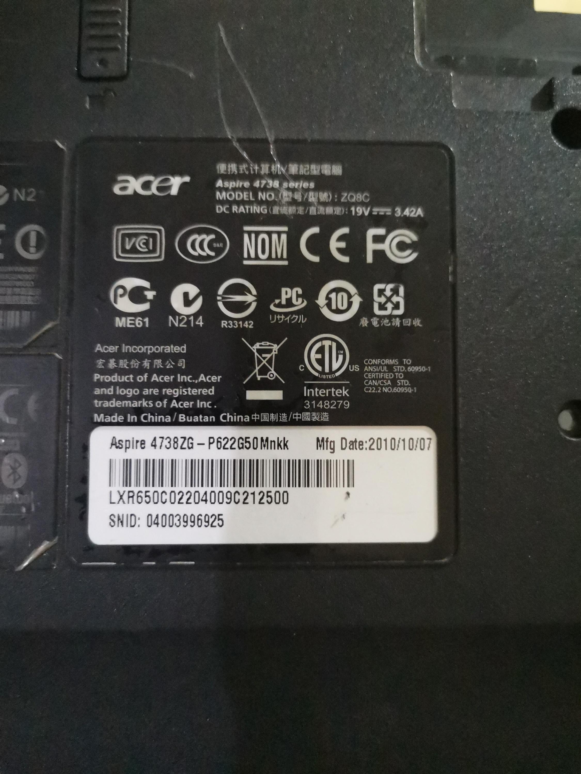

                    The serial will start with NX or something similar .Post a picture of the stickers under the memory
                      Re: Aspire 4738zg bios needed
                      Here's the info at the bottom cover.
                        According to the part number its an intel machine https://villman.com/Product-Detail/A...38ZG-P622G50Mn
                        So, you`ve got a base cover thats maybe different,a different motherboard,or a bios chip thats the wrong size with the wrong bios. Are there any stickers under the memory ?
                          None, but there's a print ZQE. and the motherboard model is DA0ZHKMB6C0 rev. C
                          Both processor is AMD

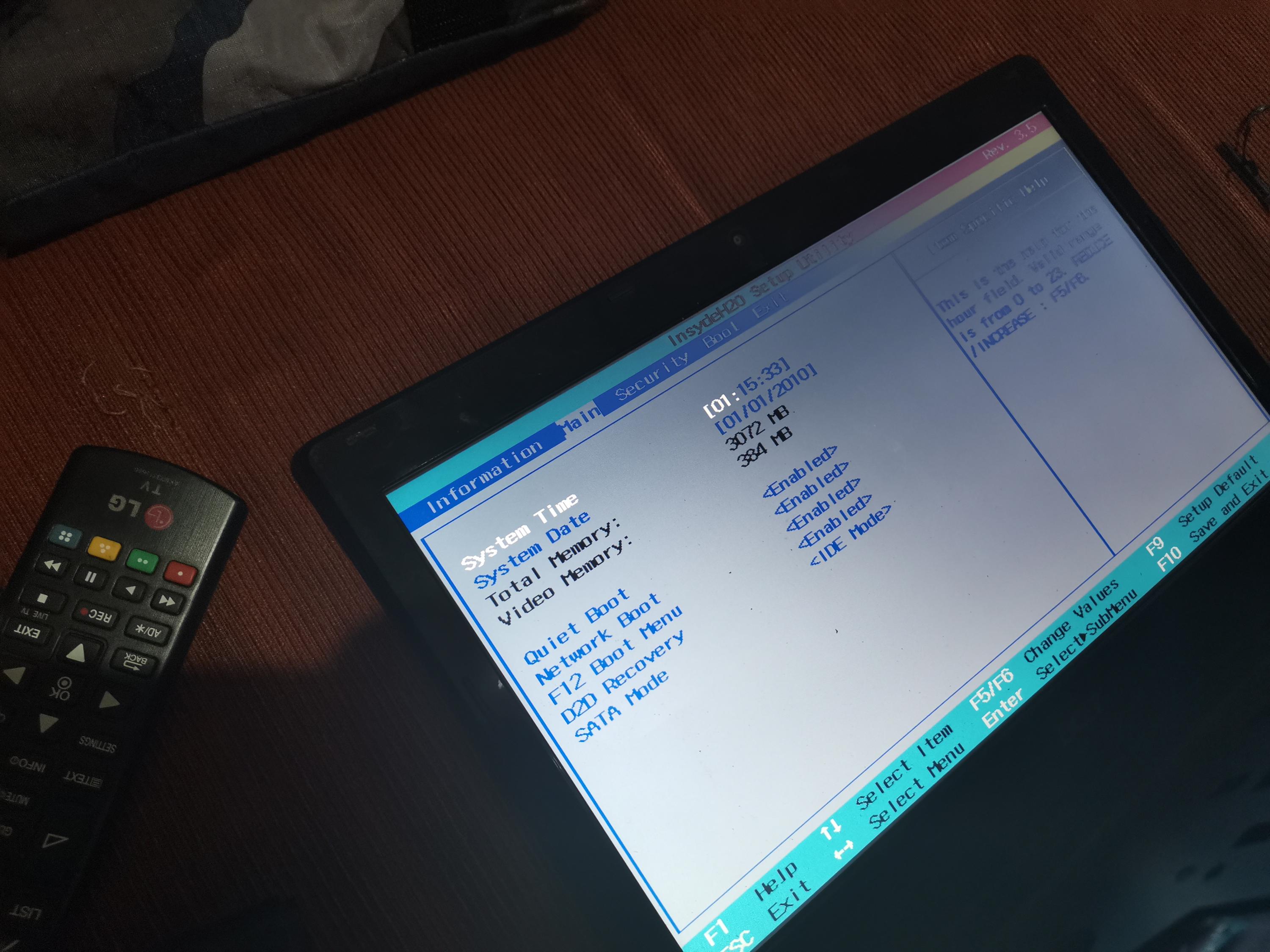

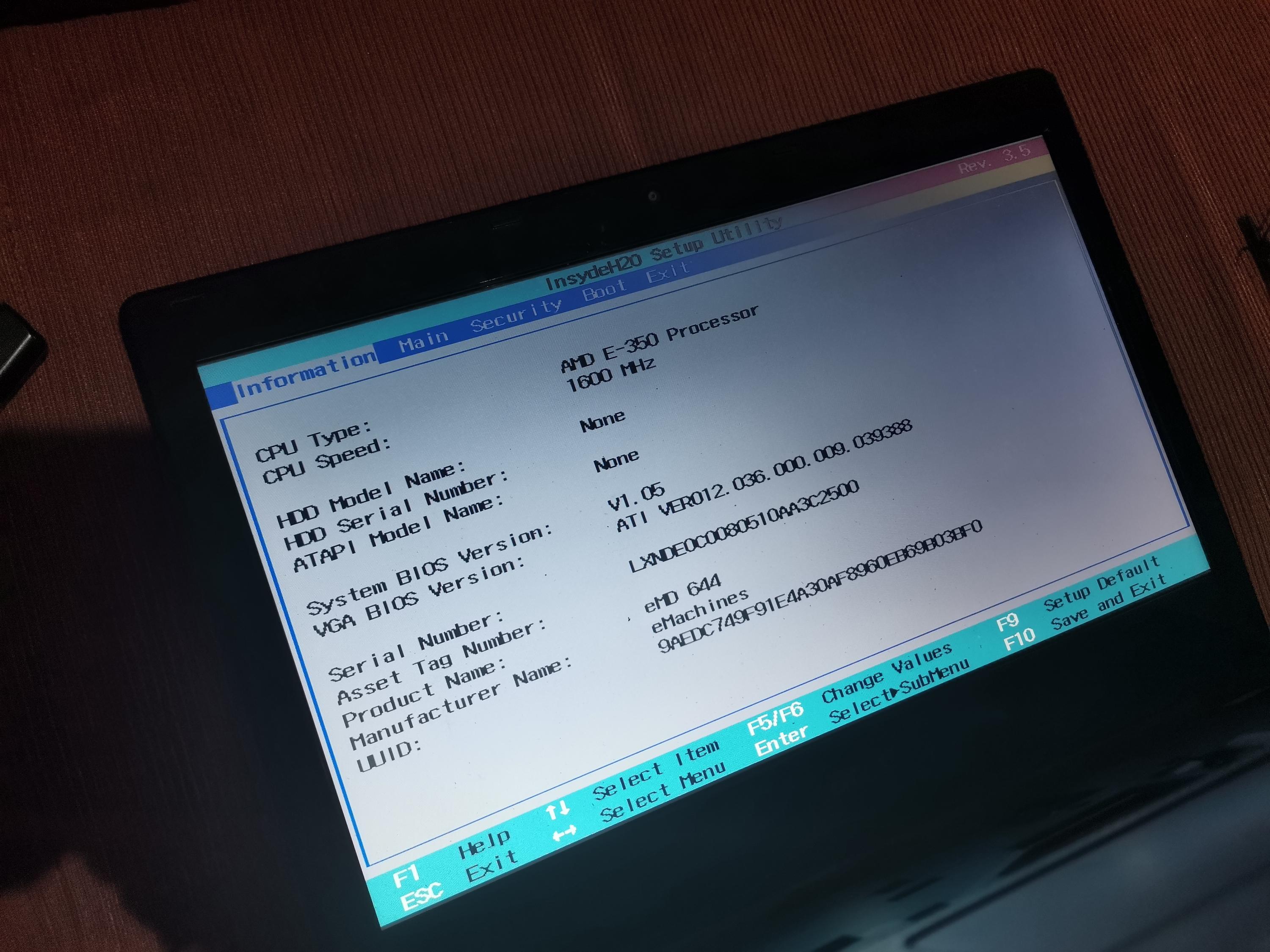

                                Thank You very much SMDFlea for patiently helping me. I haven't tried the last bios you uploaded but I managed to enter Bios Setup by typing the first password you gave but accidentally forgot to include the letter Y.
                                I mistyped and spelled it as TANGINAMO and it went through, have no clue bout it. I have also attached an image of some details about the bios. Please check.
                                Again, Thanks very much SMD and to all you guys.
                                PS. the password is a Filipino word that has a bad meaning so dont bother typing or saying it.

                                  i see its a swear word .The bios at post #14 is version 1.12 ,i added the DMI to it.
