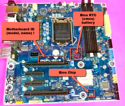

    Alienware Aurora R8/9 Bios .bin file needed
    I got a new mobo from Aliexpress for my Aurora r9 and everything was working fine until i did a bios update. It did not work and now i get 3x, 7x, 3x, 6x blinking code. Dell says that is a corrupt bios. So i have the ch341 and software required, i just don't have the bios.bin file.
    Since the board is from Aliexpress it doesn't have a service tag, I have a copy of the .exe bios and a copy of my corrupted bios attached. Hopefully this is enough, if anyone is able to help me and requires any more information please let me know.

      matherbord; IPCFL-sc/r, REV: A00
      BIOS ic WINBOND W25Q80DV

        WINBOND W25Q80DV isn't bios chip.

            W25Q80DV, it only 1 MB.
            Your bios must be at least 16MB. So look for a chip with the number 127/128 (16MB) or 256 (32 MB).

              Hoaca388 is right, the original Bios is 16MB.

                Does the chip have W25Q80DV etched/written on top of it. Is W25Q80DV what the programmer auto detected. Is your programmer a CH341A

                  Yes you write my bios ic is gigodevice gd25b127 and I make full dump from it with ch341a
