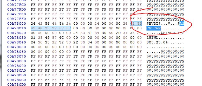

                          • flolic
                            • Mar 2016
                            • 11
                            • Croatia
                            #373
                            Re: lenovo IdeaPad S145 bios needed
                            I have this S145? without label. I don't know exact model and I don't know serial number. Motherboard is NM-C121without discrete graphics and without soldered RAM.
                            Laptop is powering on, but no image. All voltages are present except +VCC_GT (PL5901) but it does not look like hardware issue.
                            I tried few different bioses (with and without original DMI) from this thread but no luck so far.
                            Anyone have any idea?
                            Original bios dump attached.
                              • 21936
                              #374
                              Read post post 342​ ,choose the S145-14IWL bios.There`s also a script in that post to copy your DMI from your backup.
