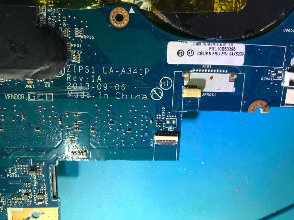

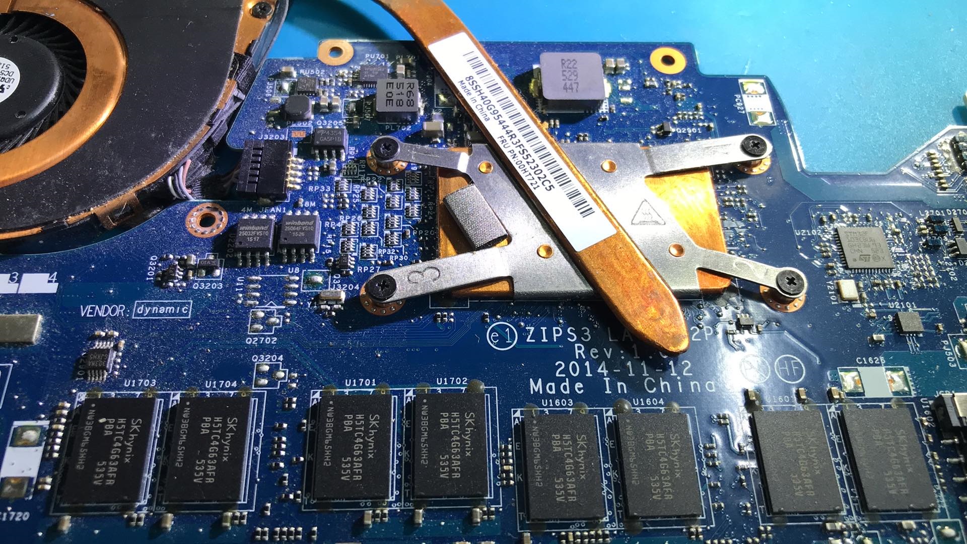

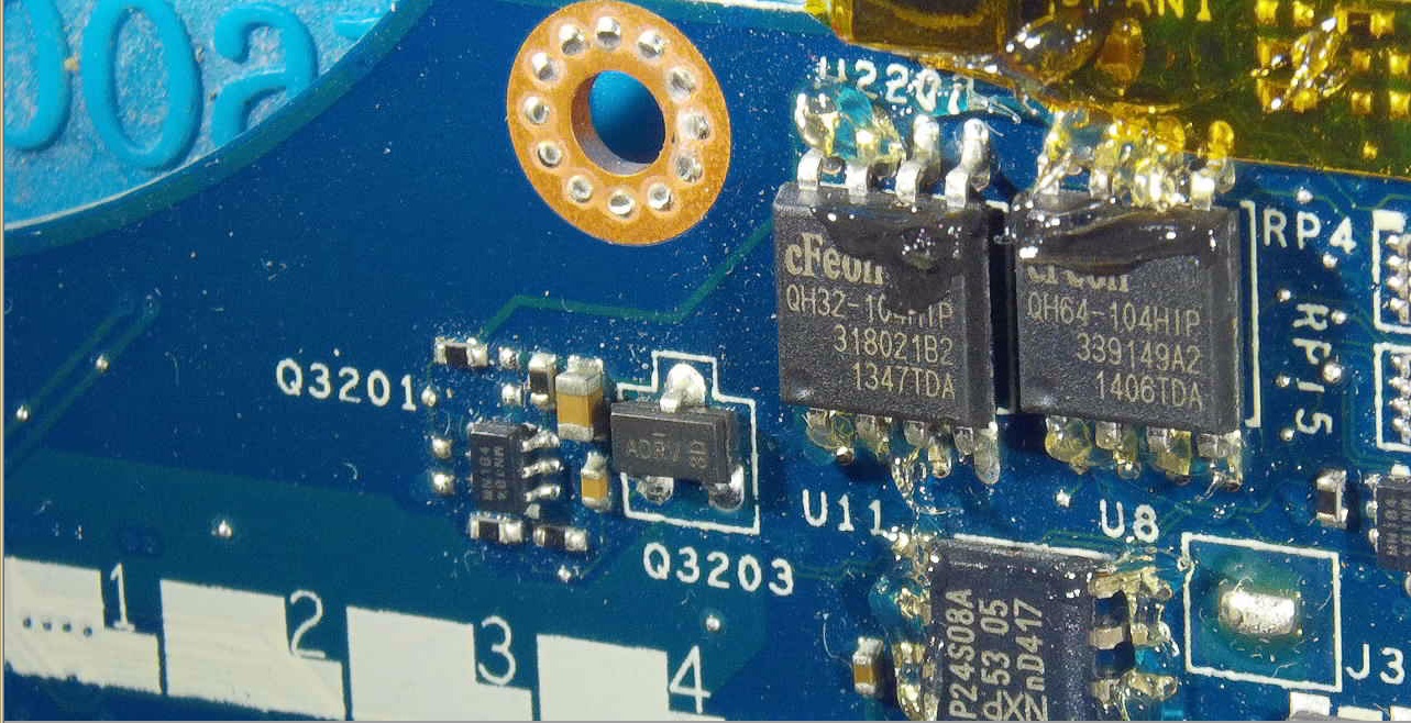

                          Re: Computrace on older Lenovos
                          here bios yoga 12 Model :20C0 ZIPS1 LA-A341P
                          edit :
                          there is not a Solution for SVP Password for these models? see photo 3
                          it's almost the same motherboard but not same
                          ZIPS3 LA-A342P
                          No MEC16
                          No 24PS08
                          just 25Q32 and 64 and ENE 9012QF
                          @Knucklegrumble your patch does not work on it
                          edit n°2:
                          even without the 24ps08, the bios see always computrace. he does not see serial number etc .. But it's normal.

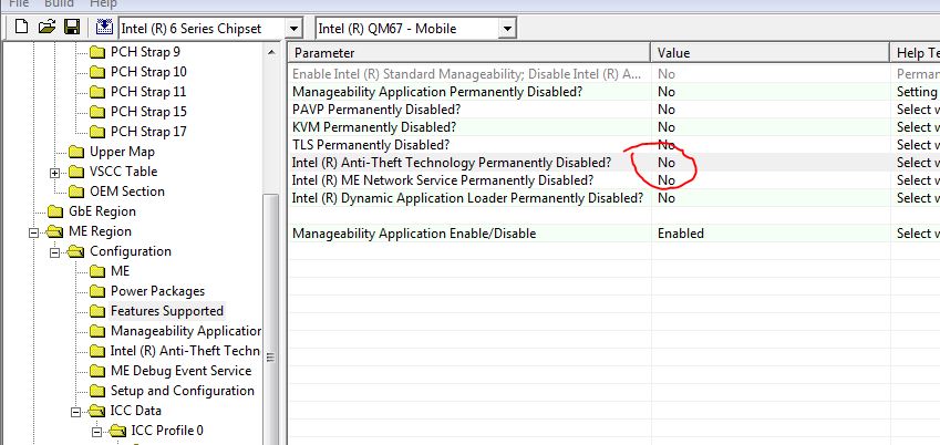

                              • 22279
                              You can permanently disable it in FIT settings when cleaning the ME firmware

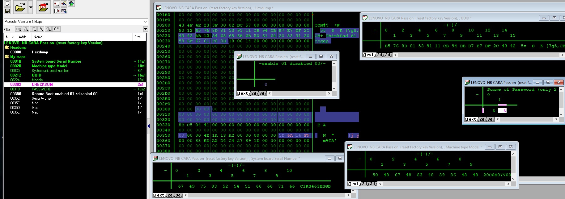

                                • Maxpower3
                                  Bad Veteran
                                  • Feb 2018
                                  • 1371
                                  • France
                                  What is your tool? I don't know that?
                                  I modify and compare each byte to find the functions! you are cheating
