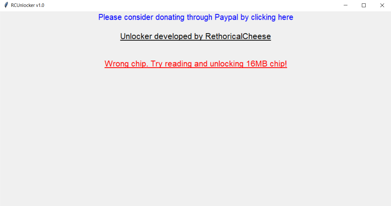

                Please help me remove the BIOS password
                HP EliteBook 840 G3
                Mainboard : 6070B0883301 rev: 1.02 A02
                Damp Lock Pass: Yes
                Download BIOS

                    Originally posted by danito
                    No external links and do it yourself https://www.badcaps.net/forum/troubl...locker?t=98539
                    Sorry, I couldn't find another way to post the dump. Unfortunately, RCUnlocker doesn't know such a BIOS and Unloker doesn't solve the problem either. Can anyone help?
                      • 22286
                      I have added the file to your post. Your file is 16385KB ,it should be 16384KB ,i suspect that`s why the patcher didn`t work. I think you chose an OTP chip instead of the non OTP ,and that`s why the extra code was added.

                        I didn't quite understand, I throw the firmware into the exe file RCUnlocker_v_1_0 and get an error message. Firmware size 16.0 MB (16,777,984 bytes)
                        Click image for larger version  Name:	2025-05-07_12-53-04.png Views:	0 Size:	40.2 KB ID:	3631424
