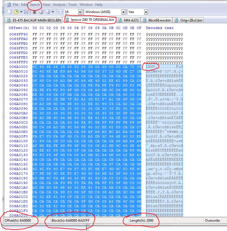

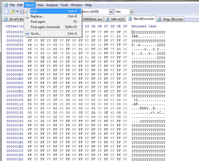

                                          #40
                                          Re: bios lenovo ideapad 330-15ikb
                                          Originally posted by Nordlig
                                          Hello Peste,
                                          Thank you for the response. I'm pretty new on this and I have no clue where is the DMI stored, I have to know the offset or address range to extract that DMI you mention before, right?
                                          Where or how can I find/know the hexadecimal range of the DMI you mention in the BIOS file? I tried but I get lost on that huge amount of hex numbers, I tried to find somethin like "serial", "uuid", but no success at all...
                                          Thank you
                                          The DMI is in the interval from post#12
                                          DMI 234000 - 235FFF
                                          on this laptop model the DMI is coded..
                                          enter both bios in the HxD program, search the original bios by the word (LENV), check the box and transfer this interval with (copy-paste) to the other bios...
