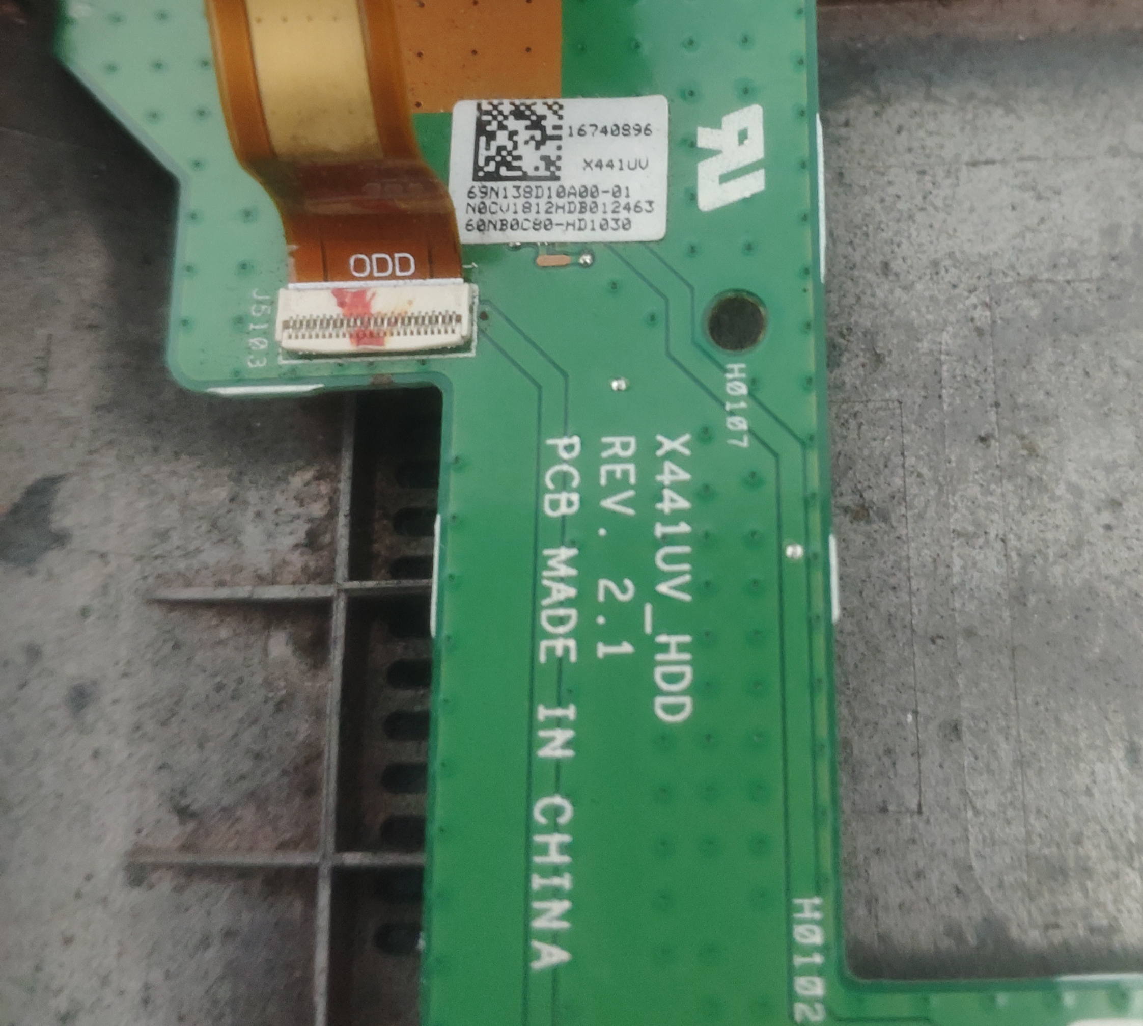

    can someone fix my bin file,,
    laptop cant detect harddrive
    there's no barcode on motherboard
    heres my original dump,,
    thank you in advance

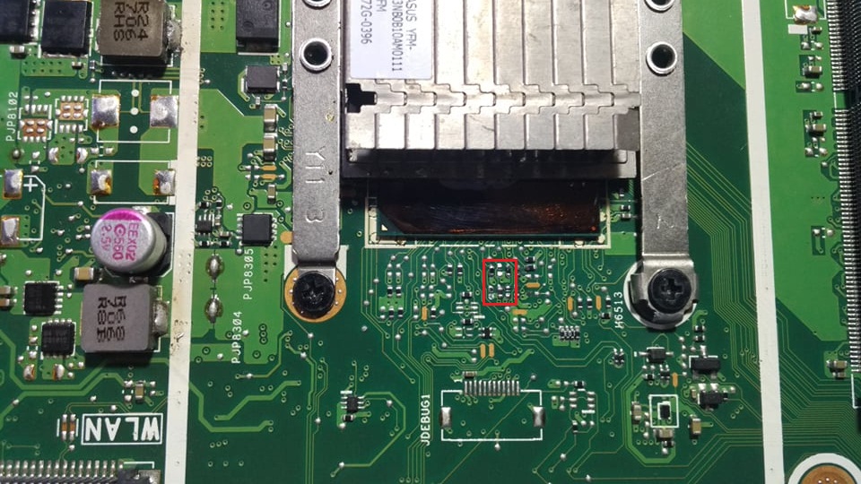

            Colleagues I have an ASUS X441UV board but it turns out that I put clean bios working on another computer and on my board it doesn't work even cleaning the ME region and nothing but, I found a bios of an X441URK and with that bios it does give me an image but it takes time to give image ? What will be the problem? One detail is that I have the ram that is soldered on just that plate disabled.
            There is a theme of a plate just like that, I took out the bios that I have tried and the bios that gives me an image but it takes seconds to give the image

              Clear ME region.

                If there is a long white barcode sticker on top of the soldered ram post a picture of it

                  It seems that they do not have because I just checked on the internet and it is a label just above the soldered ram, and indeed they do not have,
                  Now I tell you a little about the process,
                  disable the soldered ram leaving it as the attached file, all ok, then I wanted to update the bios, it restarted and did not give an image but the consumption is the same as when it is giving an image, then I found the X441URK bios and it gave an image
                  I attach my bios in case it helps
