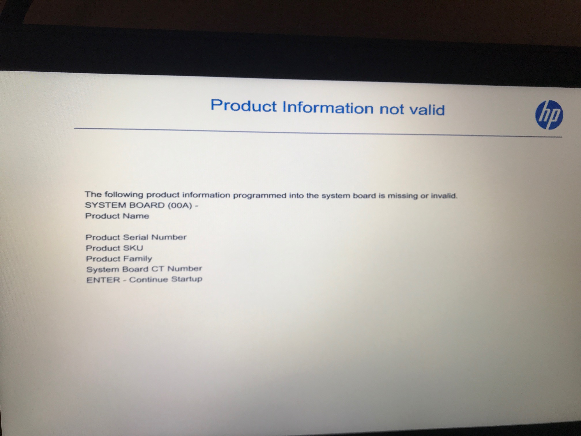

    I have a HP ProBook 650 G1 - when I start the laptop I am getting a message Product Information Not Valid. I know I am supposed to write the info manually, but I am not sure how. Which tool should I use to write the product info manually? I tried using HDMI tool and DR. Bios, but it's not working. MB manufacturer is Inventec.
    Waiting for helpful advice...
    MPM is unlocked.

    Re: HP650 ProBook G1 Product Information Not Valid
    try...
    https://www.youtube.com/watch?v=rP3A3HWM_-Q

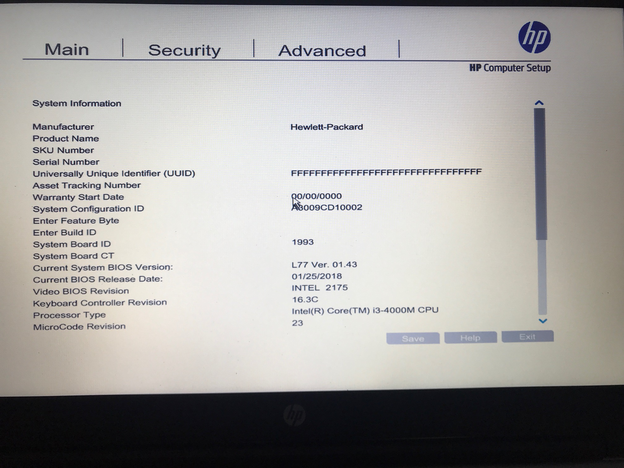

      I tried doing everything as described in the link, but when I write in all the numbers and save after the setconfig, I restart the laptop and nothing is saved. I am not sure if my MPM is locked or not. It says *Lock.
      At the beginning of a video at the link, there is a message that MPM is unlocked. I am not getting the message.
      How can I unlock it? Using a smc.bin file, and where can I find it?
      Should I use WNDMIFIT after that?
      UUID option in BIOS says FFFFFFF.... Is it supposed to be like that?
      What should I do first and how can I solve this problem?
      Also, I can't find FEATURE BYTE number of my laptop. I have been using the number from another HP, same model.
      Thanks.

              Bios file you need bios programmer read chip and post here.Otherwise no have option solve your problem.

                use some software that can extract bios dump
                try from this post
                https://www.badcaps.net/forum/showthread.php?t=54885
                but u dont need it
                u can use NBDMIFit or check if your bios contains tool for change this info.
                All info u can find onback side of chasis

                  I tried with universal bios toolkit 2.0 , but it cant identify bios.
                  I tried with NBDMIFit but it doesn't work.

                          I have ordered an sp eeprom programmer ch341a. I have read that I have to modify the pcb to 3.3 volts.
                          I have found the .bin bios files for my HP laptop.
                          The files are rar, and when I extract them I am getting a power.iso image file.
                          I have tried to extract it in Power Iso, but I can't.
                          How can I extract the bios files from power.iso image file to use the with eeprom programmer?
                          I am the beginner with this kind of problems, I could really use some help.

                            Did u try use more NBdmifit versions? different versions is for different bios
                            did u try search in bios for page where u can change dmi info?
                            just flash that iso, but u want to read your bios. flashing that iso give u exact same result as u have now
                            CH341 use 3,3V so no other adapter needed for 3,3V bios ic
                            u need adapter if u want to flash 1,8V bios ic

                              I have tried different versions of NBdmifit for my bios, but without success.
                              I understand that .bin iso file is a bios - I opened it in Hex Editor.
                              I saw how to modify ch341a at this link
                              https://www.onetransistor.eu/2017/08...schematic.html.

                                  This is my old bios file. I removed the BIOS form the MB and read the bios file.
                                  My bios chip number is 25Q128FVSO, but my USB Eprom CH341A recognizes it as 25Q128WBD. I have no other options to choose my file, but I managed to work with it without problems.
                                  I tried to read the new BIOS file to my laptop, but when I turn on the laptop I am getting the same error message.
                                  You said that you can help me. Thanks again.

                                      Try this and post results

                                        Thank you so much! Everything works!
                                        I read the new BIOS, soldered the chip to MB and it's great.
