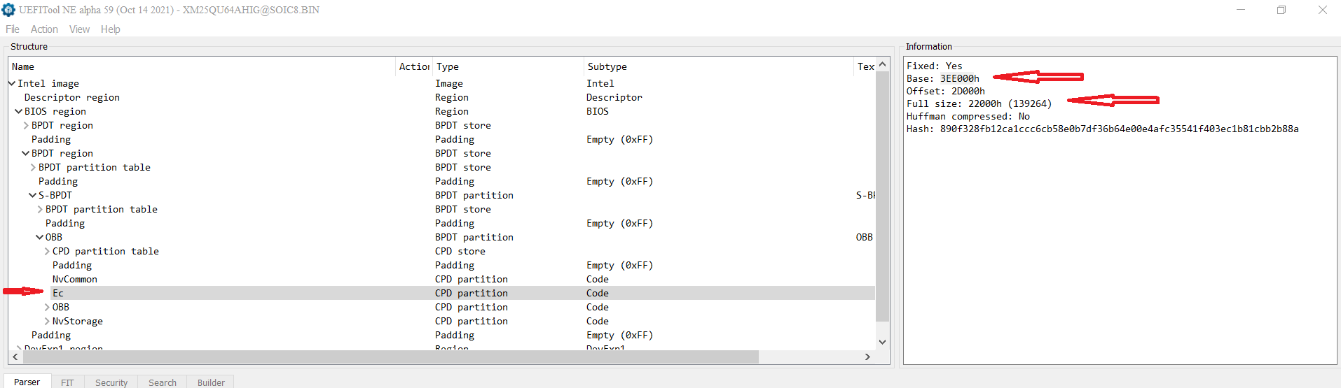

      Hi guys, I also need IO controller file for this board EPG52 LA-G121P. I understand that the BIOS file and IO controller files are different and programmed separately. The IO controller IC is ENE-KB9022Q d.
      Reason for trying to reprogram is because the original ic blew and shorted. I replaced the IC with a new IC, but it needs programming in order for it to work.
      Thanks in advance...

                                Need UEFI Tool to open your .biin file , find to EC ( like in the pictute ), you see , table Infomation ( right ) ," Base " is offset start point of EC, and "full size" is lenght of EC.
                                so , you need open your bin bios by HEX editor, click " Search ", choice " go to ", offset table insert your base offset ( 3EE000 , like the picture ) and click OK button. It will lead you to the starting point of EC. At this location, right-click and select "select block", select block window is appear, tick to " lenght "option and write down your lenght EC ( 22000 , like the picture ), click ok. it will mark your block , now just click right mouse and choice " coppy ", press Ctrl + N to open new table, past down your block to this. " save as " it with a name .bin. Done.

                                  Ok so i gt the UEFITool and the Hex editor. Followed your instructions and got a file now that is 136KB (attached). Is that correct as I understand the ENE kb9022 is 128KB? I Could be wrong.
                                  I also noticed that if I right click "EC" in the UEFITool, it gives e option to extract, which I also did and got the same size file (also attached).
                                  In the hex editor, under Analysis, I loaded the 2 files and did "Data Comparison- Compare" the result was that both files were identical. Is it safe to use then as from the original save off from the hex editor?
                                  The files "EC" is the one I extracted using the UEFITool.
                                  "EC2" s the one extracted using the hex editor.
                                  Can you say its safe to use any of these?

                                    You can cut off the area starting from offset 0 to 1FF0, you will be left with a 128KB EC file.

                                      the laptop bios has the "Bid" 084D4 ... so use the bios and the EC 084D4 bios from post # 8 ...

                                        Ok guys. my apologies for not getting back sooner as i had put this on the back burner for the while.
                                        I did both suggestions, I removed the offset, and I downloaded the .rar file.
                                        I compared them both and they had minor differences.
                                        So today I hooked up the TL866Plus using the ICSP (In Circuit Serial Programming) interface and wired it to the motherboard. I added a 3.3V VCC line as the programmer recommended and flashed the KB9022 controller with firstly the offset file. Disconnected the programmer and attached the motherboard back into the case and tested. Works like a charm...
                                        I had left the ICSP interface connected because i also wanted to try the downloaded .rar file. Did the same as above and also works like a charm.
                                        So even though both files were slightly different, they both managed to work without errors thus far. I removed the ICSP cable and reinstalled the motherboard back into the case. Closed it up and ran some test. Everything works as it should.
                                        So to end, I must say a great THANK YOU to all that assisted me with this. First time I'm using a programmer, so I'llbe asking alot more questions in the future. I'm just happy this being my first time and it worked out well.
                                        A wonderful thanks to all once again...
