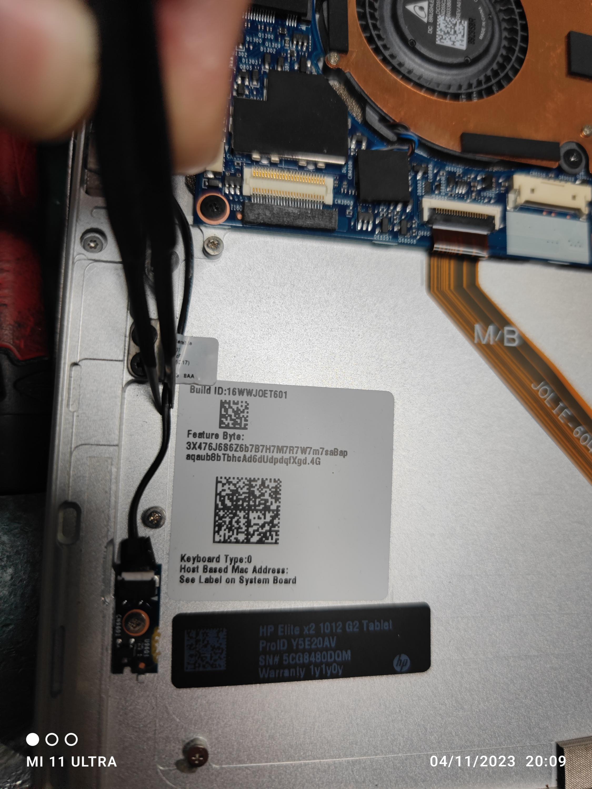

    #41
    hp elite x2 1012 g2
    the tablet have password on bios.
    thanks in advance again
    Picture from inside

      #42
      Re: hp elite x2 1012 g2
      BIOS guides, methods, resources and tools
      Password removal by laptop brand
      Become a Badcaps supporter
      Thanks to all supporters.​

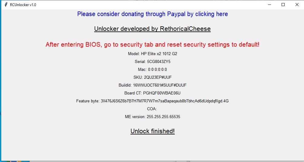

        #43
        Re: HP Elite x2 1012 G2 fix BIOS password
        Solved.
        thanks

          #44
          please help me unlock
          • lapfix
            • Mar 2020
            • 2756
            • my workshop
            #45
            Try and see instructions
            • virusjez
              • Jun 2017
              • 34
              • Philippines
              #46
              Thank you very much sir..it works.. GodBless you

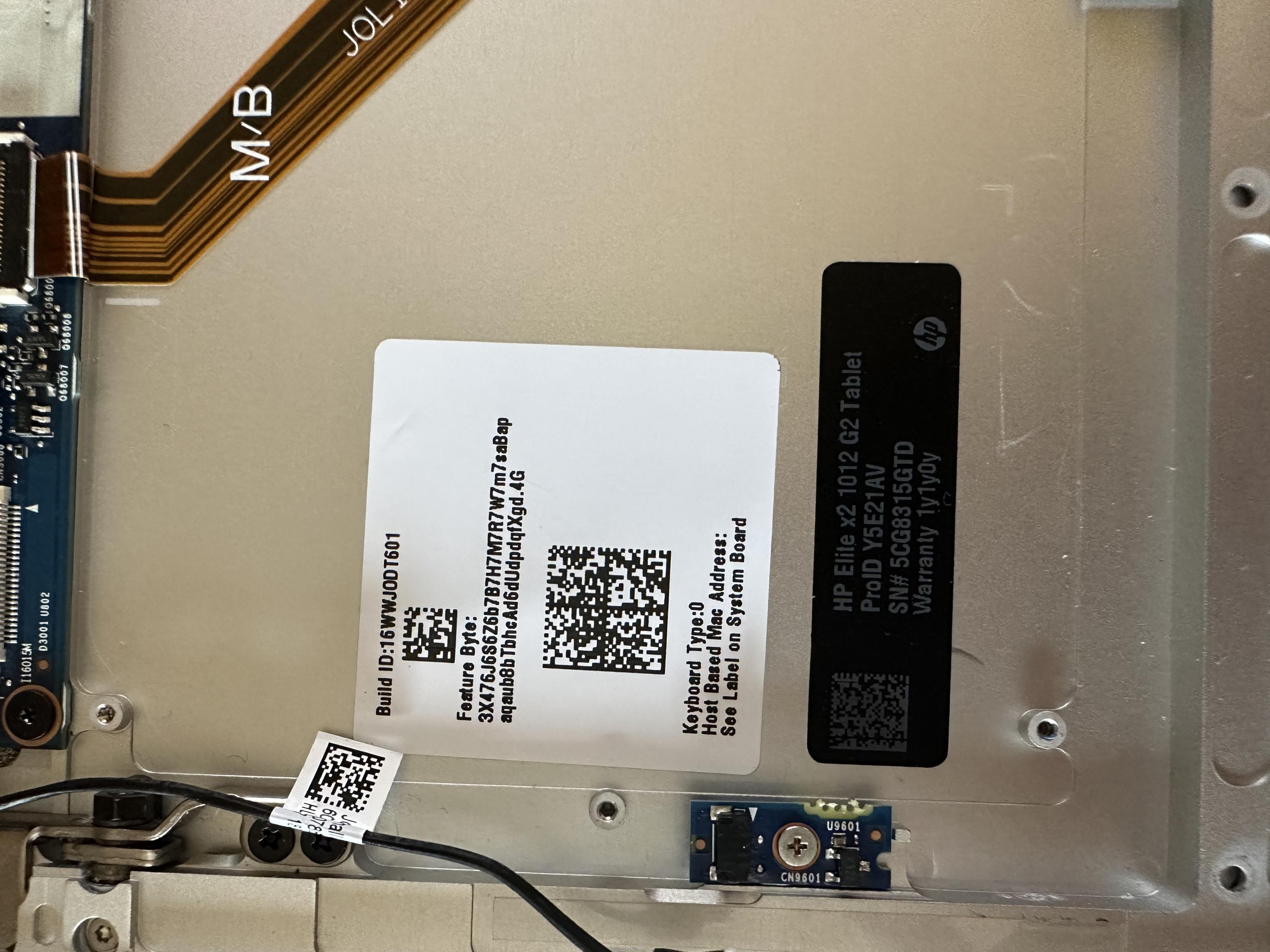

                              #54
                              Re: Problem deleting bios password on hp elite x2 1012 g2. HELP!!!
                              Try another clean me bios and see if it work.
                              Or ,write your serial number and somone will built a new bios
                              I wouldn't advise you to use the clip, most of the time it gives errors.. if you don't have a chip adapter stick wires between the chip and the programmer... don't forget to make a backup copy of the chip before writing..
                              the serial number of the laptop is 5CG8315GTD, I also attach an image where you can see the characteristics.

                                #55
                                Try and give feedback

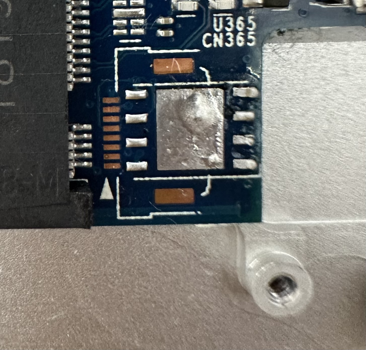

                                          #60
                                          good afternoon everyone, when desoldering the chip I have noticed a "bubble" that has come out on the board, can anyone tell me what it is?
                                          Thank you very much
