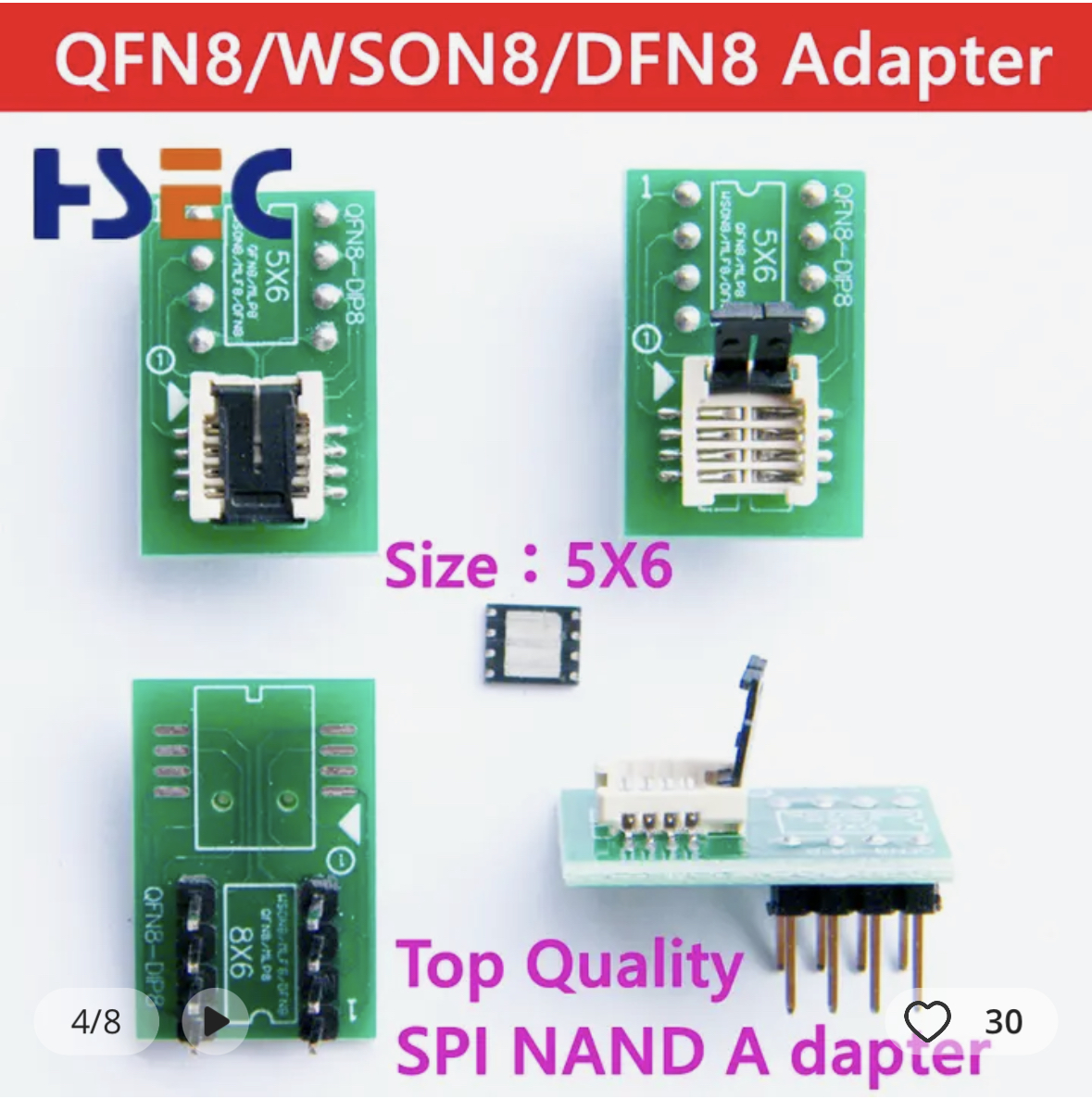

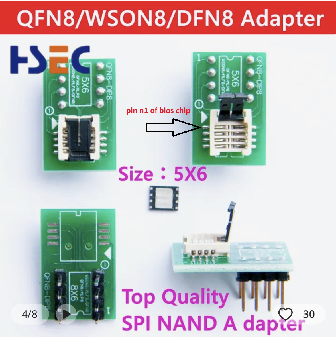

      I recently got the adapter I ordered for my ch341a with the 3.3v fix to safely access the wson-8 chip.
      The issue is that I put it in my ch341a and it gets very hot in temperature.
      Do I need any other adapter before?
      Attached is a picture of the adapter.

        maybe you insert bios chip in wrong position

          Good morning, thank you very much Lapfix, the computer is already working fine without password in bios.
          Thanks for everything
